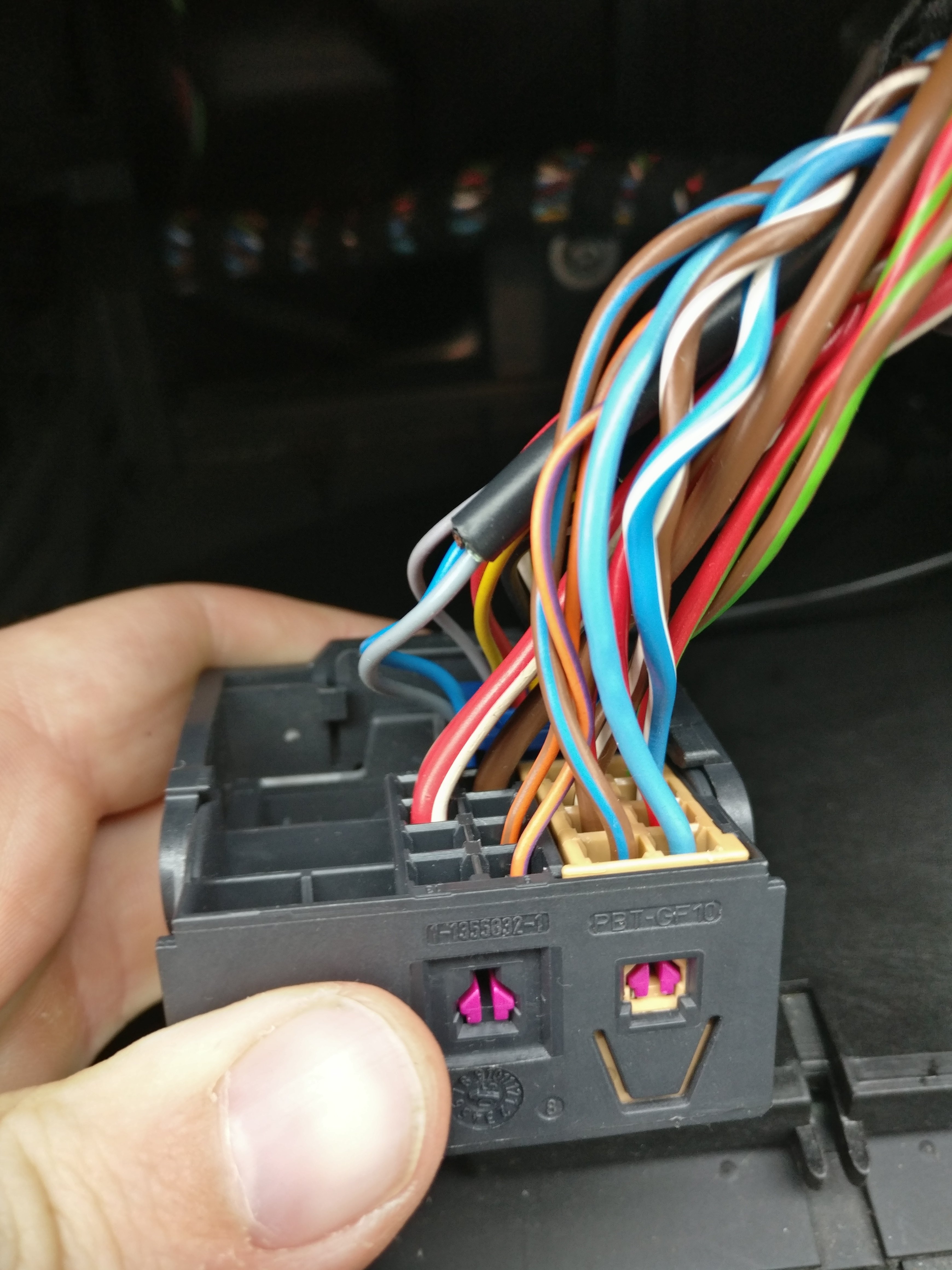

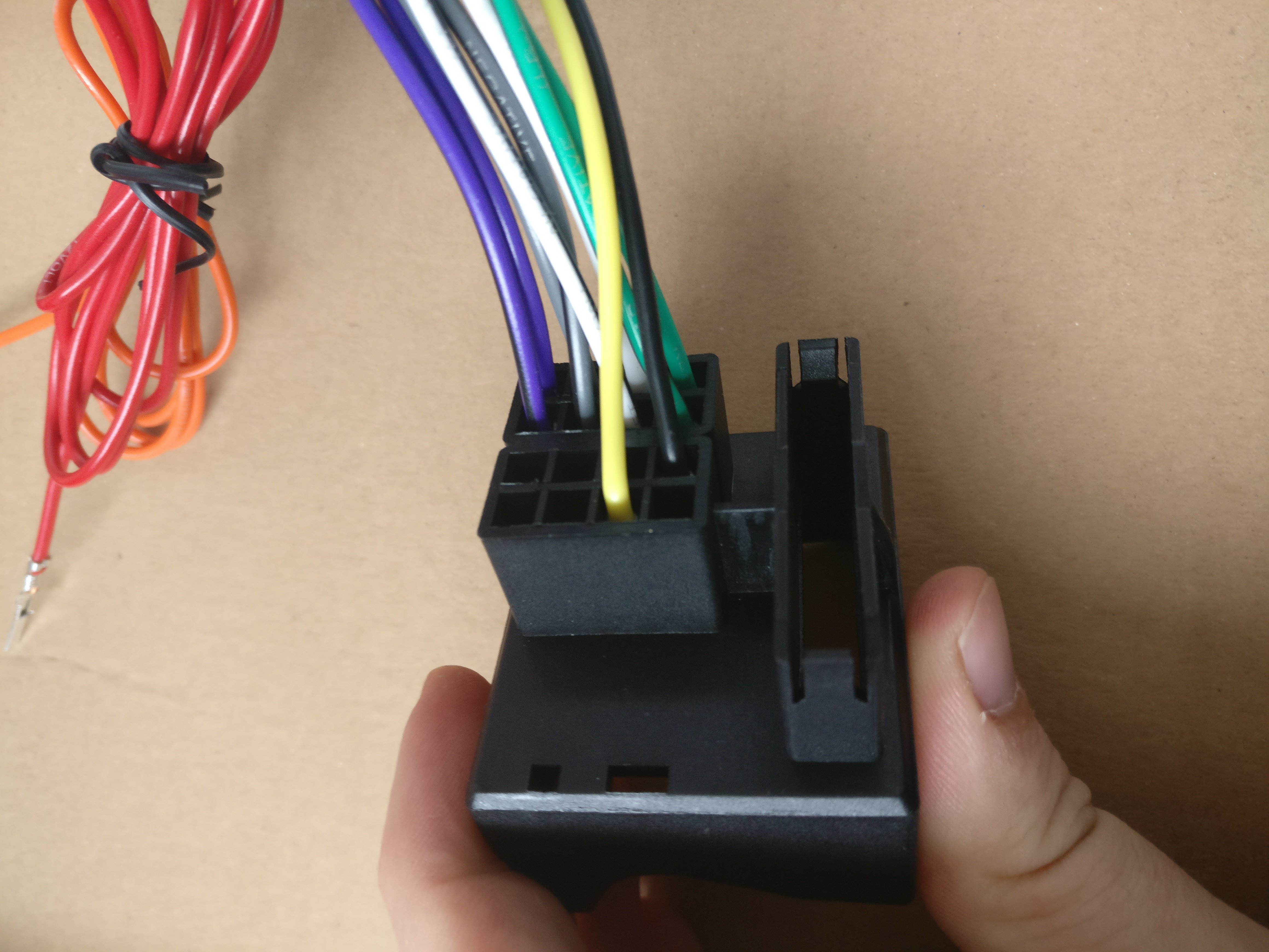

I have recently bought a 06 vrs. I am looking to fit a Kenwood dmx7017dabs but have been having difficulty with the wiring. I've got the ISO connector but can't see where I need to connect the power cables.
Does anyone have any experience of doing this or have a easy to read wiring diagram?

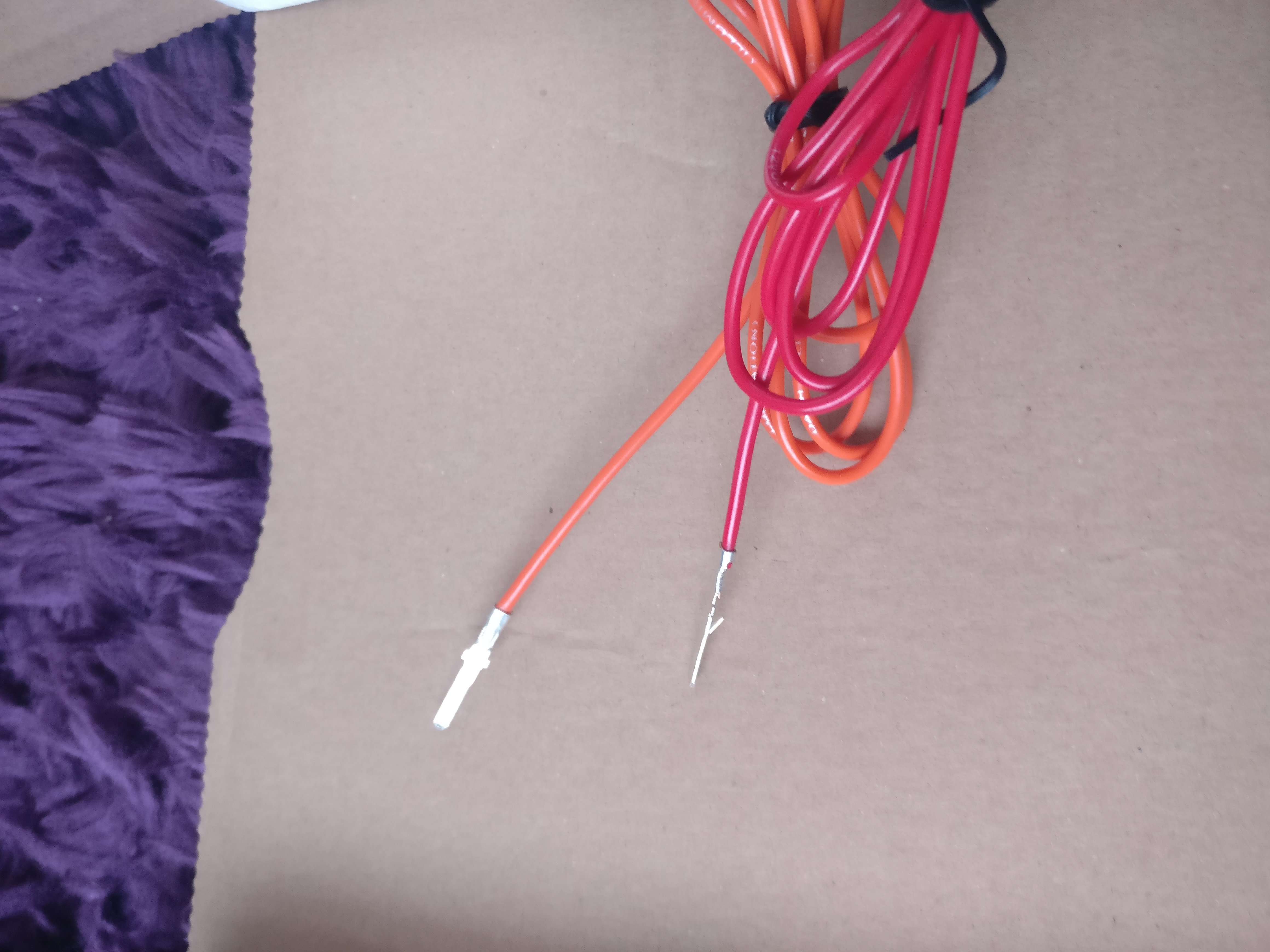

Yellow on the new connector is probably permanent power.
You'll need to find a switched live in the fusebox as the OEM headunits don't have one.

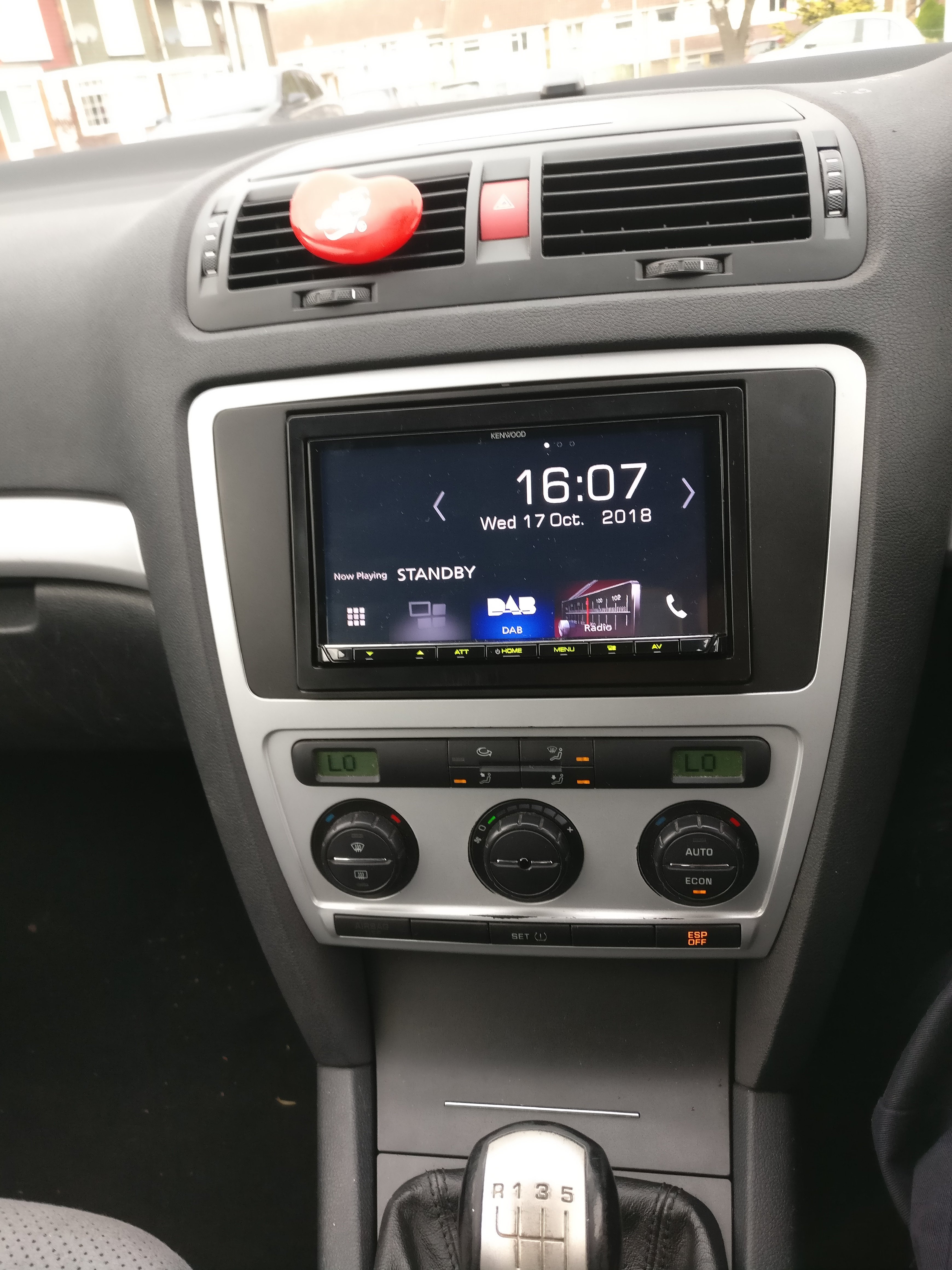

Thanks for your help all fitted now and works like a dream!
