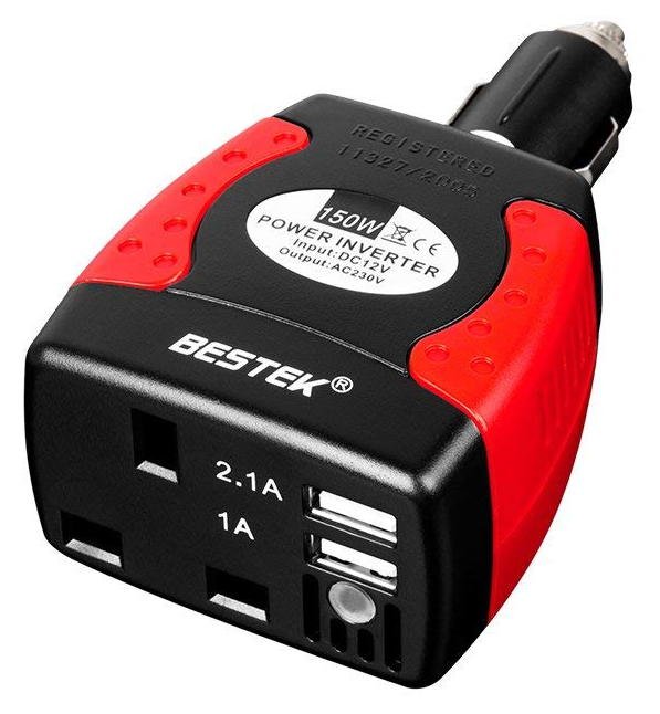

Hi, thinking of buying one (as the UK car doesn't include the mains socket!) just wondered if anyone has one and what they are using and the max power that can be used without blowing the 12v socket fuses?

Personally I wouldn't go much over the 150W with a 20amp fuse for the 12V Sockets, the unit above shown by @BillyJim is rated at >90% efficiency which means it may require near 170W to give an output of 150W, plus there is the initial surge current to consider (by both the inverter and anything connected to it).
