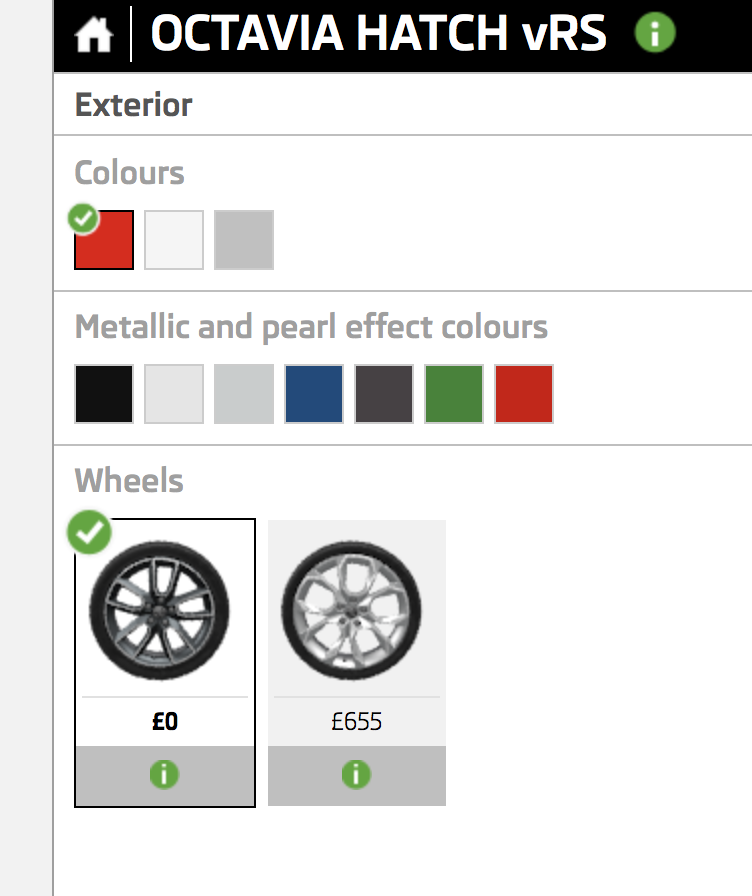

If you go onto the Skoda Configurator the 245 comes with 18" wheels as standard. The 19" Extreams in Silver are a paid option

Yep, I'll be running on the 18" wheels, I'll be looking for something nice looking and either Graphite or Black in colour to contrast nicely with the Meteor Grey.
They don't do the 19" Extremes in black any more, apparently supply and QC issues.
