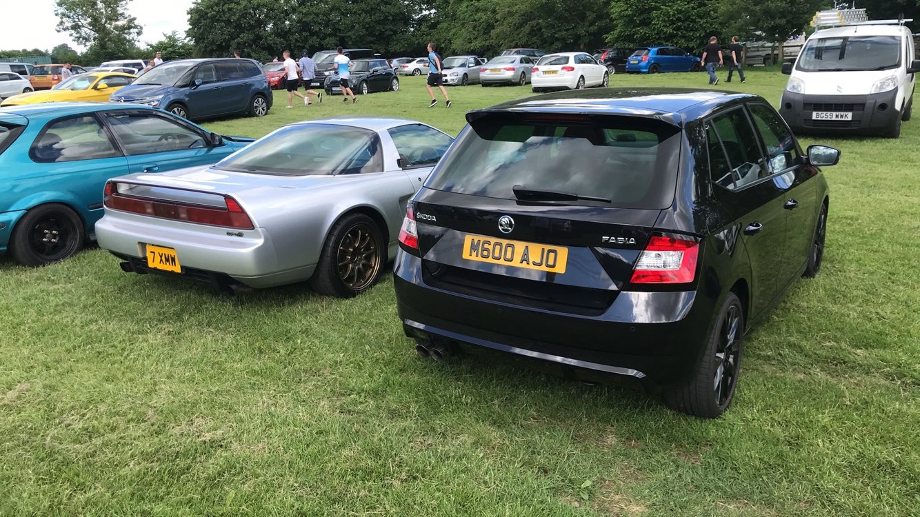

I’ll have a look!
originally it was 110hp it’s now 142hp on 97 Ron, I’d imagine it would push 145-147hp now as I also run Tesco 99 Ron.
Also have a forge motorsport intake, eibach 25mm lowering springs and 20mm spacers all round as well as a back box delete.
