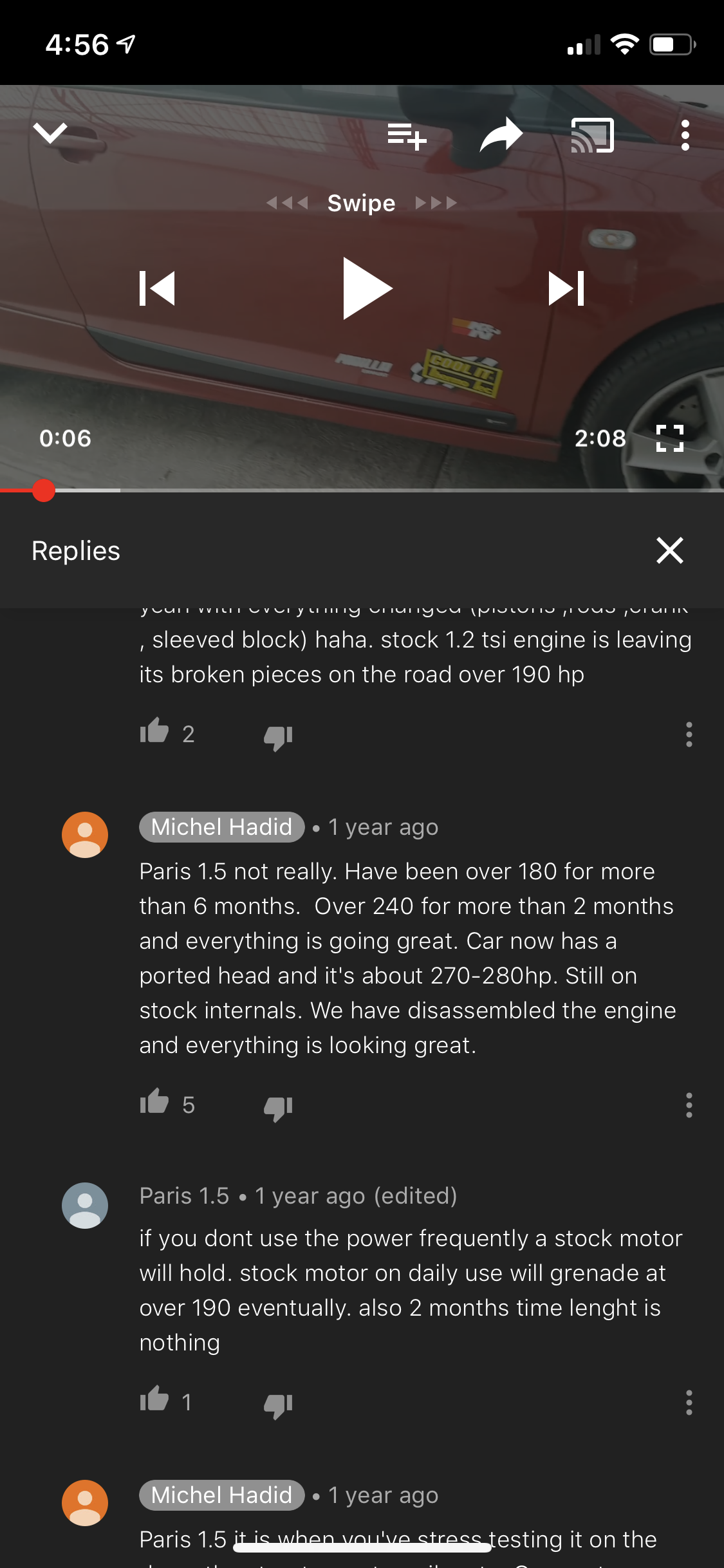

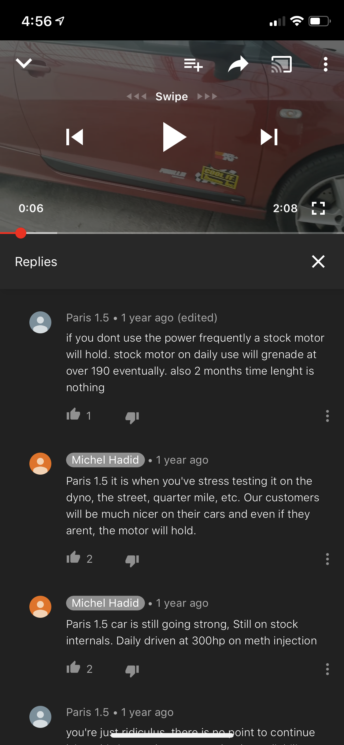

@AMD87 Pretty sure it’s the one that was running 243 bhp. Only what I’ve read on YouTube but the guy seems pretty genuine!BA41FD33-2EAD-49AA-8F9F-17230A3392A6.thumb.png.02bd80d6cffa2a494732a6cb8f6db5bb.png84713F41-3F92-4AF2-AF1A-CFB4C82FC3B5.thumb.png.294cc8fd756dd277f9a6174f2dd875ee.png
