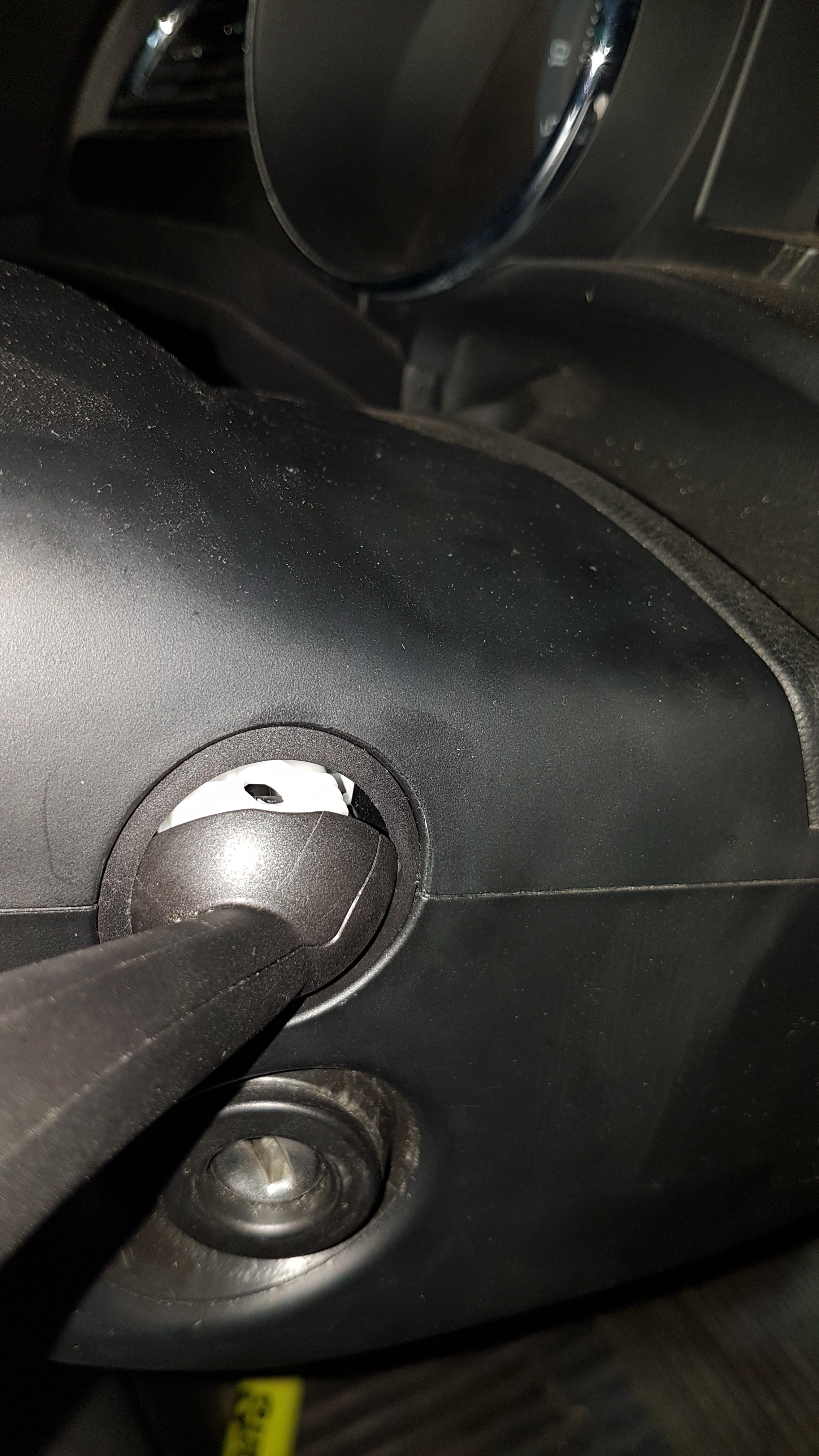

Hi All,
I'm sorry, I did not describe clearly what I would like.
I would like to replace or repair the arm.
I have misty memories about it.
- Remove the negative pole from the battery.
- remove the airbag and the steering
- remove the cover of the rod of steering
but I have no details.
I attached a picture what is my problem, I don't know something is broken inside of the arm mechanical part or not, or just dislocated.
Well, I'll let people who're experts in wiper arms solve this ... :D
