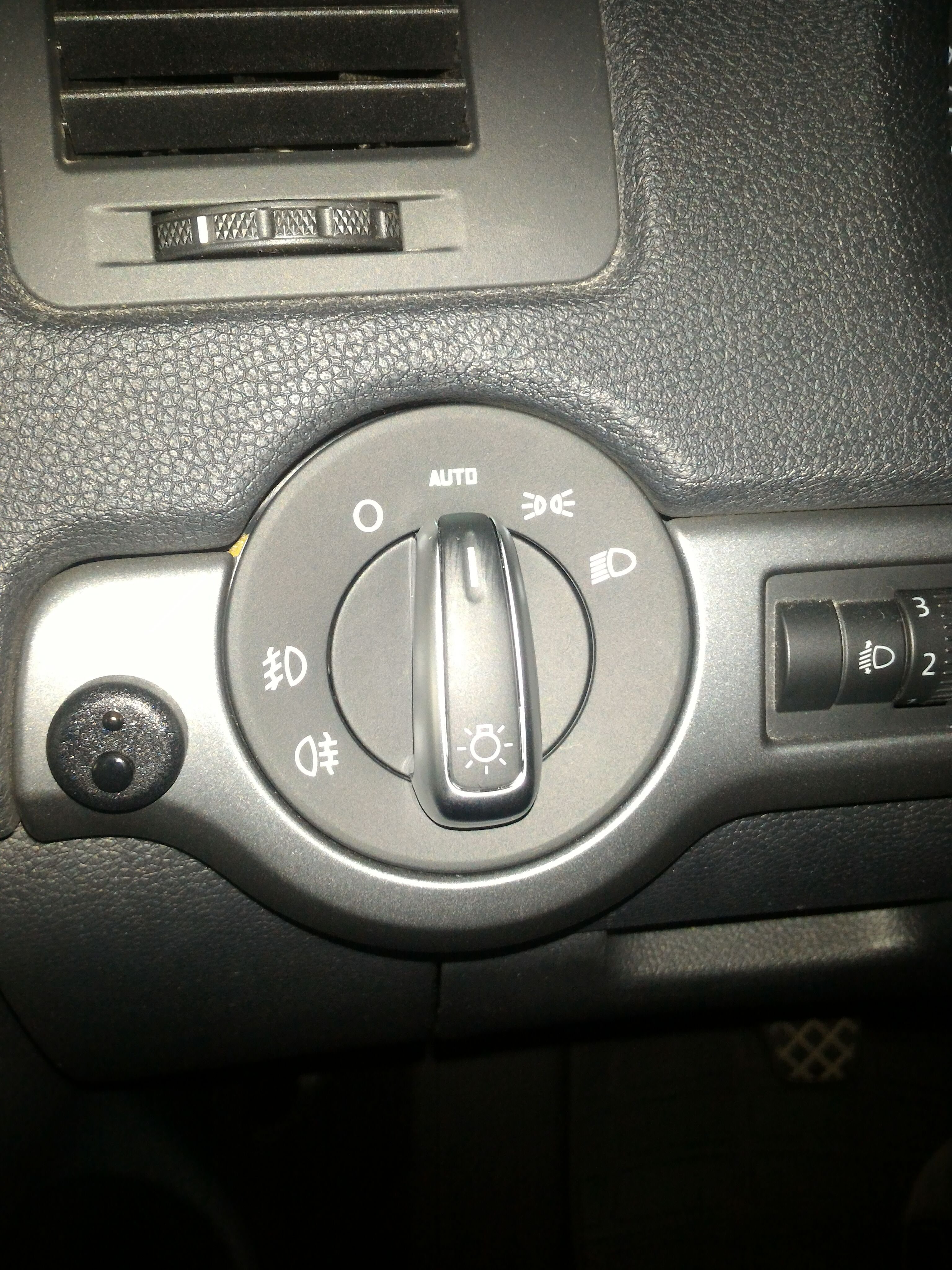

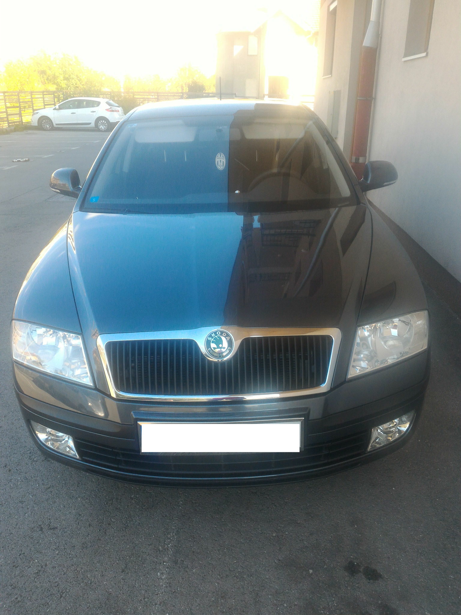

Does anyone have a scheme or some user manual how to connect the fog lights on my Skoda Octavia A5. I have new fog lights which i put on the car as you can see on the picture , and also i have new swich with two levels of adjustment, because the old one (factory) was only one level of adjustment ,only for rear fog light.
Please if any one know how and where to connect wires , please give me informations......
