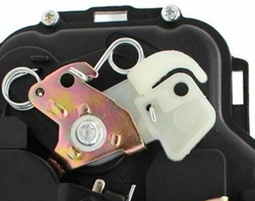

just about to put new regulator on but it looks like the door lock lever/button has come off lock, does it just clip in  as it looks like plastic where lever was has snapped?
Yeah it clips in. If the plastic has broken you can just not bother fitting the button. It doesn't affect the locking.
been trying to find a picture of lock where it clips into bur cannot find one.
I take it that if I wanted rod connected I would need a complete lock?
Here you are...
Edited by TMB
thanks for that, that was quick. so the rod sits in the hole in the plastic?
is the curved part just a locking part to stop it coming out?
As far as I can remember, the rod has to be inserted into the hole and then turned until it is held in place by the curved bit.

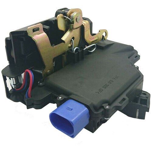

unfortunately I broke the power plug locking part in my haste to jam the window back up the other night when the cable snapped with the window down.
will I be ok to wrap to with insulating tape to stop the plug dropping out?
Hmmm, I don't know. I should imagine it would be quite difficult to get into it to wrap tape around it, and looking at it here, it doesn't look like there's any room for the tape to stick to once the plug is on because pretty much the whole blue part gets covered by the plug....
Edited by TMB
The only thing I can think of is to glue the plug on with silicone or something, being careful not to get any on the contacts. Of course that will make if difficult if the plug ever has to come off again.
Alternatively, the plugs are available if you put part number 1J0 973 714 into ebay.
