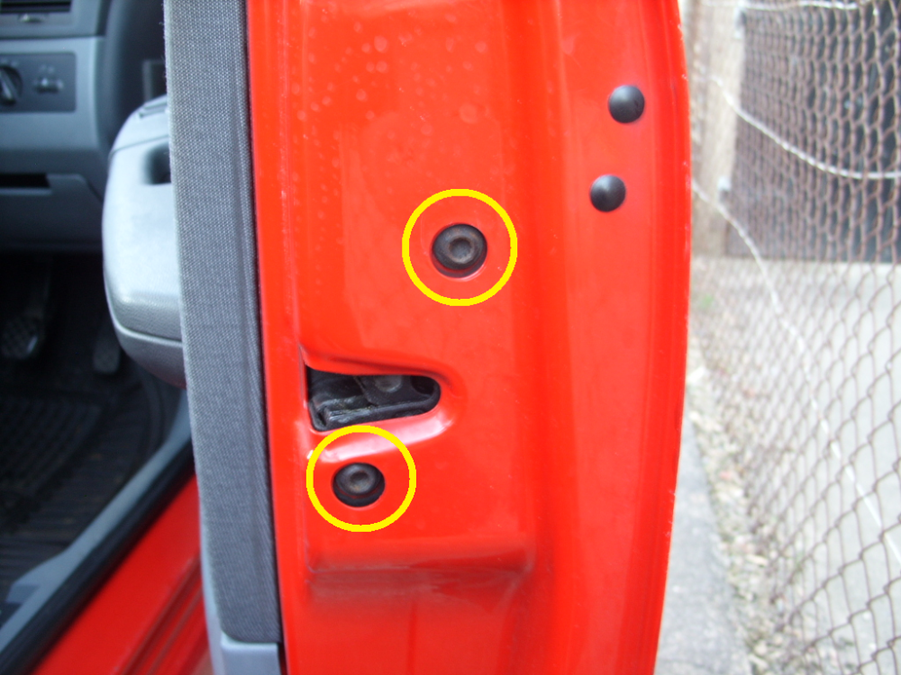

Decided to get a 2nd hand door loom and new lock. What size/type socket do I need to remove door lock?
The two bolts holding the door lock to the door are 8mm XZN spline.

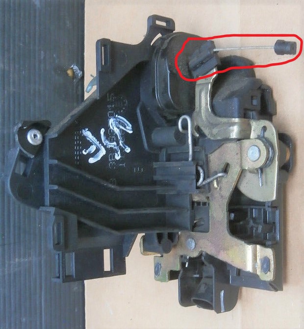

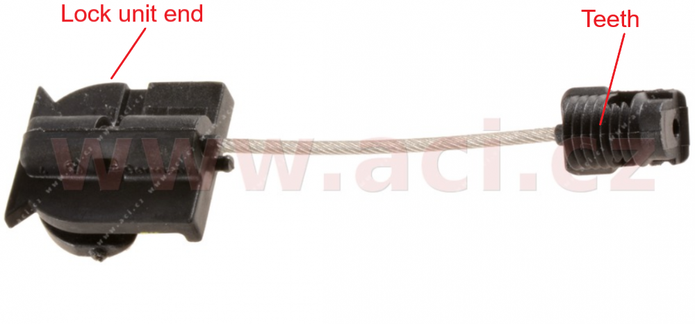

There is a certain procedure to removing the lock unit as it is connected to the exterior door handle by a short bowden cable which has to be released. It has plastic teeth on it which engage into corresponding teeth on the door handle so that its tension can be adjusted. It has to be adjusted correctly on refitting.
The lock unit end of the cable has a shaped plastic piece which fits into a hole in the lock unit metal arm. Rotate the plastic piece and the cable will pull out of the arm. You can do this once the lock unit is out of the door.
Edited by TMB
