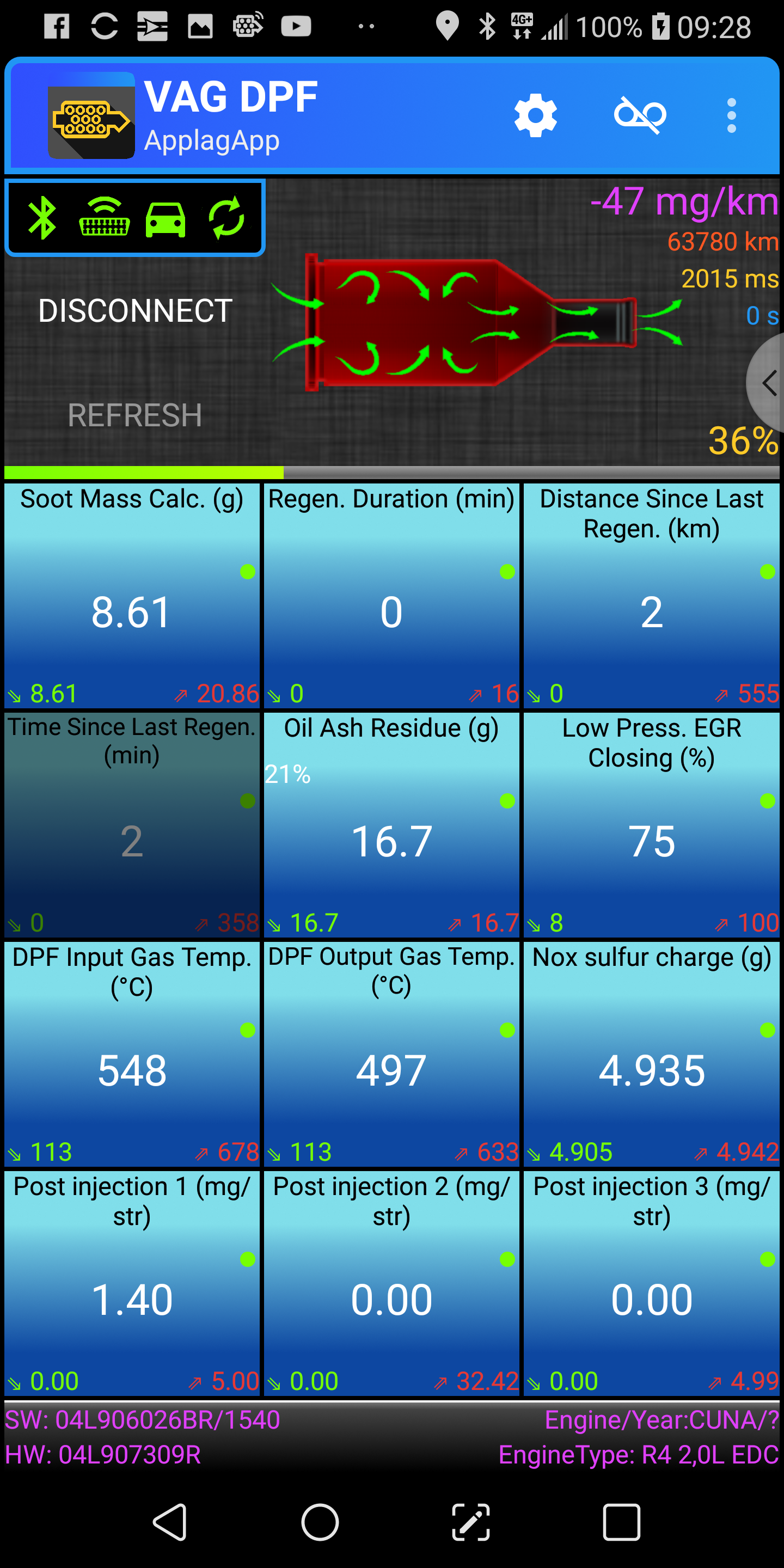

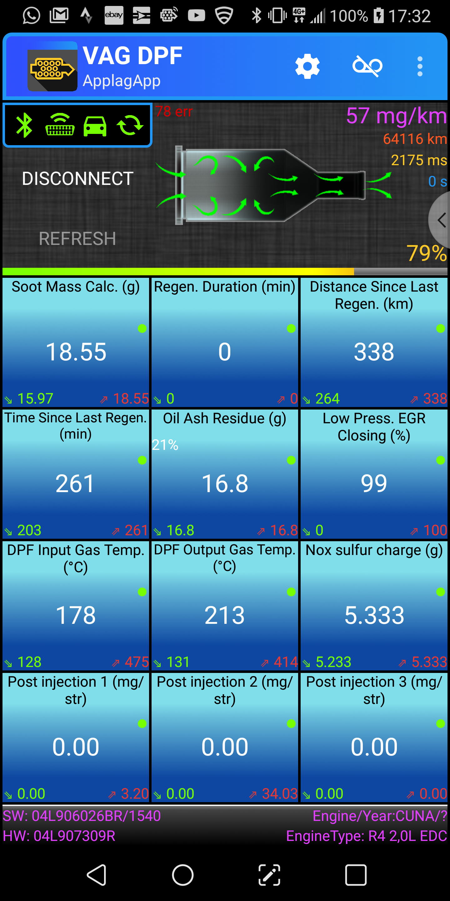

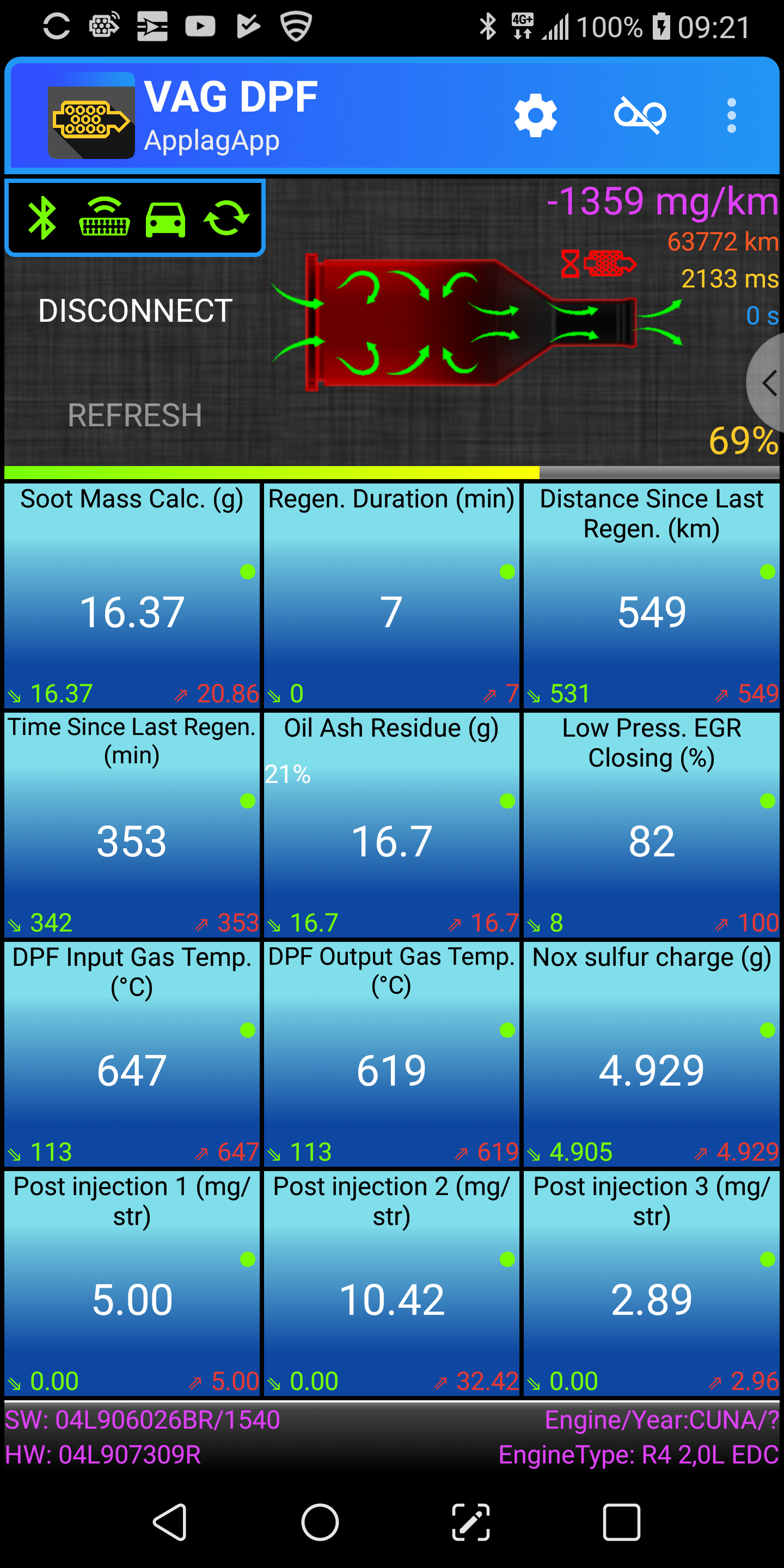

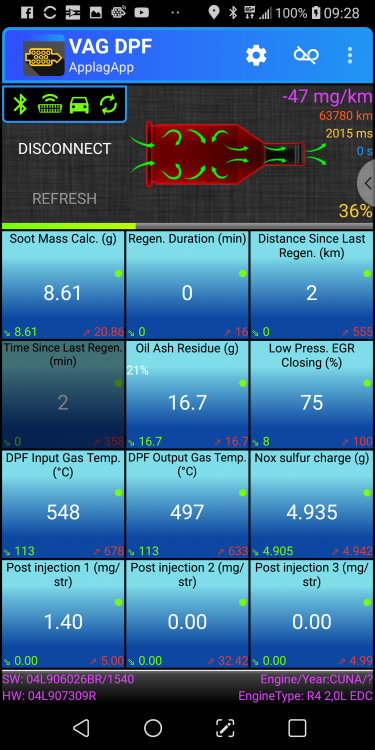

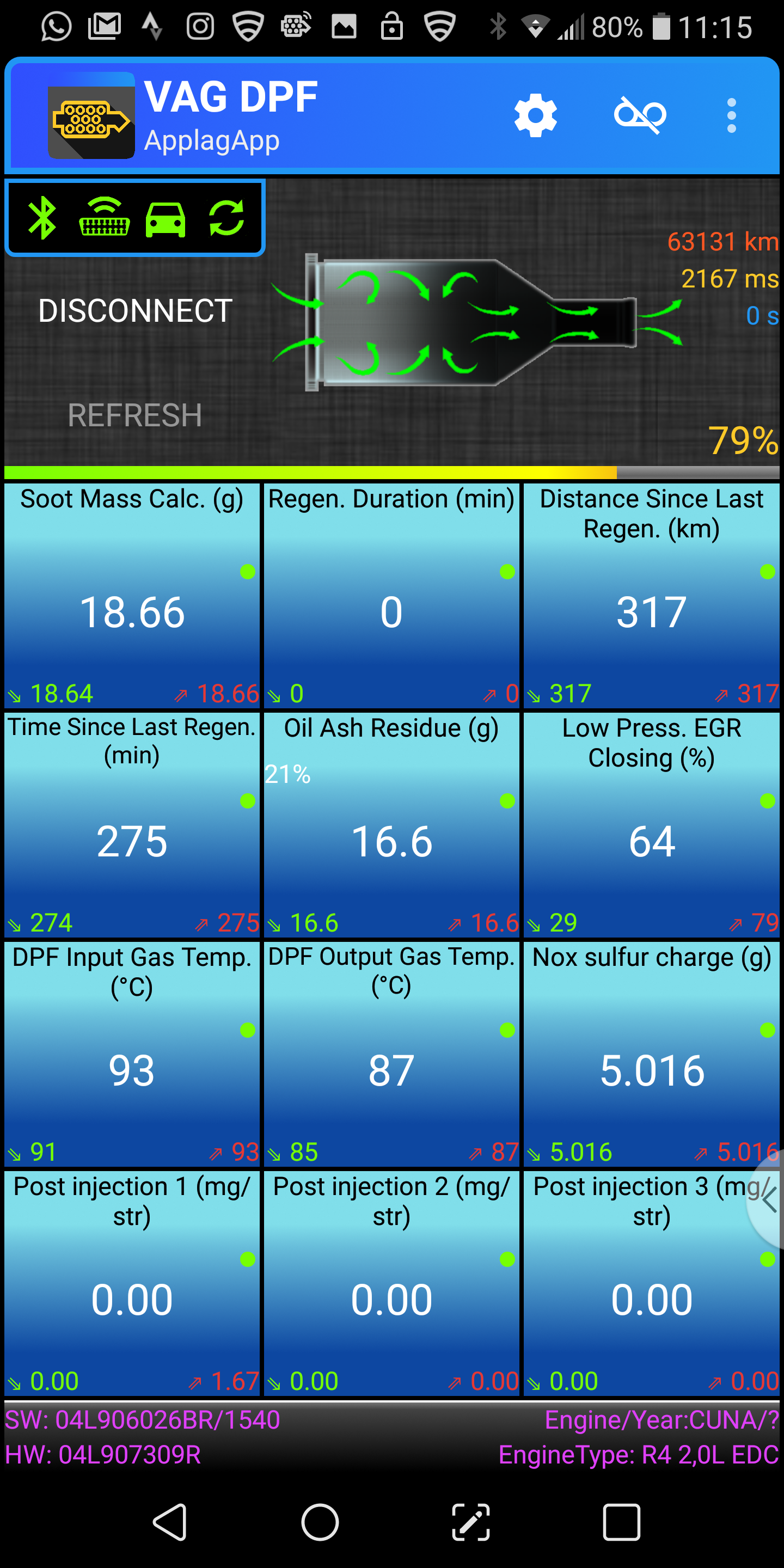

So today a trip from west Wales to Birmingham and back. It did a regen about a third of the outward, but not at 100% full and only 16 or so g of soot. Second screenshot is after the regen, which was completed whilst driving at 60 on the M42. It didn't completely zero the soot level, us that normal?? Third screenshot just now when I got home. Dpf has more soot and higher % full yet no regen.
Driving style same both directions though more stop start jams on return....
So the question is, why is it not doing a full regen?
I'm going to have to take the map off and run it standard for 1000 miles and what pattern I get.
