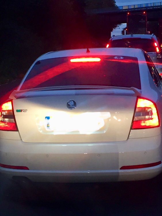

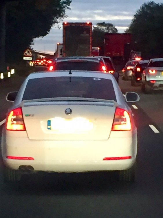

My Octavia stop/tail lights are dim, the brake lights only seem as bright as the tail lights and the tail lights are noticeably dim (see pictures).
Does anyone have any ideas???

Any chance you fitted the bulbs the wrong way round?
If I remember correctly, the brake/tail is a dual filament bulb.
Stop tail light bulbs are offset pins.. it’s a very strange fault it’s like the o/s and n/s lights are low on voltage. All the other tail lights and the top brake light are fine.
Although the brake/tail is a dual filament, i'm pretty sure it only uses the 21w filament. The tail light brightness is done by dimming the 21W filament rather than using the 4W filament.
Although they have offset pins, I've still seen them fitted the wrong way round. Assuming that was was the case it would match your symptoms perfectly...
