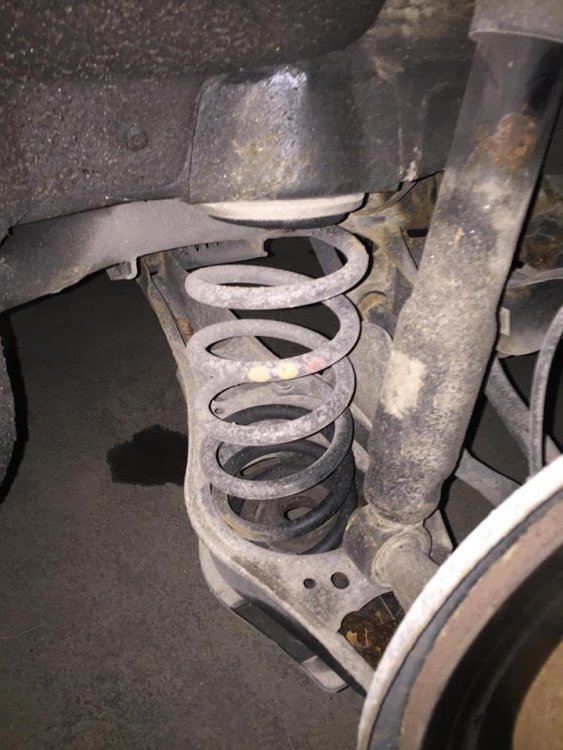

Hello! Just recently my Octavia's rear spring's bottom part snapped and is now making a clunky sound when driving on a difficult terrain. I checked and the spring is now leaning a bit off form its intended spot and just waiting to break from the next place. I'm having difficulty finding the part's OEM code, even though I know the current spring is color marked as follows: yellow, yellow, red. I do not want to replace both springs as of now and I am planning to do the replacement at my garage, so I am asking for help if someone can spot the correct spring code? I've literally looked through over 50 options for rear springs for my car, but most of the different make models do not have any color marks on them. (The car is a Octavia II F 2010 estate, 1.4 TSI with a towbar). I want to order the part from an online parts store near me.

Unfortunately I was unable to find the springs from linked sites. Most of the springs that come up have a default picture without showing any color codes at all. Neither are the color codes in the products' descriptions. I will try to get a quote for the spring from a local parts dealer. If they can look it up, I will have the part code as well.

The part you require is here:
http://www.oemepc.com/tvn_result/search/tvn/1K0511115CK
Now you have the part number you can search the relevant sites to find which manufacturers make equivalents and their part numbers.
With that info you can search eBay etc for the best deal.
Typically a pair of springs will cost less than £50 and are a diddle to replace.

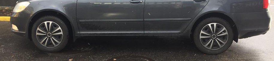

Yes, the rough road package was fitted to my car model when ordered new from the dealer. The oemepc site unfortunately doesn't read my VIN code to display parts list, however some other sites, such as VIN decoders, do.  Thanks for the link, MicMac, I will see if the part is listed there. To some other replies - the car sits high due to rough road package, so fitting an ordinary spring set to the rear would make the back look slammed compared to the front side. As of now, the rear springs have not carried heavy weights, so even with the current defective spring, the rear looks even. If the car would be old, I would fit a pair of new springs to the back.

I can't see what all the confusion is for, I've clearly linked to your OE spring with 1R 2Y marking and have keyed the part number into various searches with plenty of options to purchase.
