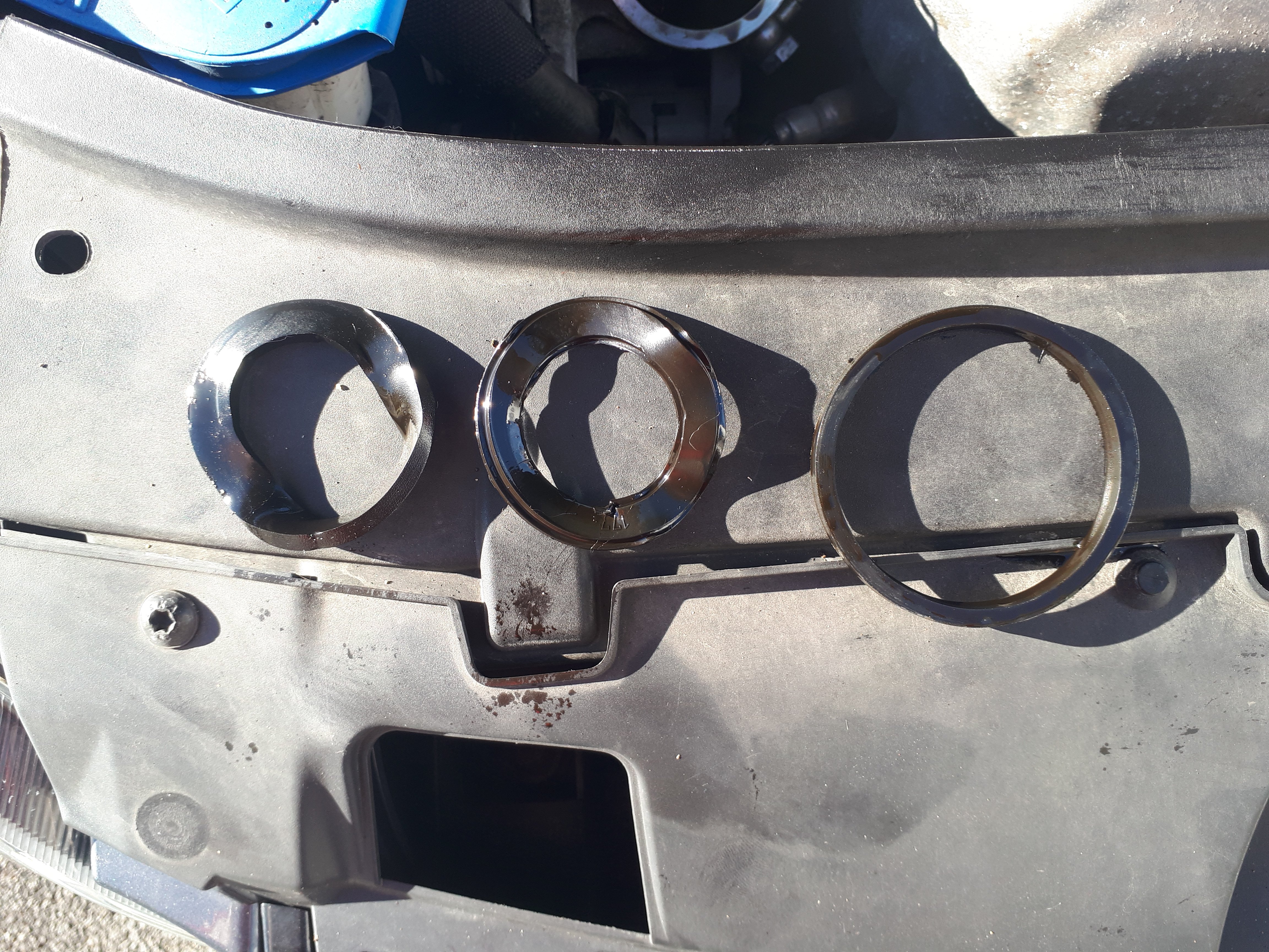

Unscrew the oil filter, first about one and a half turns to allow oil to drain out from the filter for about a minute, then remove it completely. There is a broad rubber washer that sits on the end of the filter in the sprung plastic bit (where the notches are on the photo). If you dig down into the oil filter housing (probably full of black oil) you will probably find a second identical washer that fell off previous filter and was left behind, someone forgot to check and remove. There should only be one washer. Thats whats probably causing the issue. (Or no rubber ring at all)

Hi everybody, well after a struggle even with an oil filter wrench I managed to get it off and guess what, yes two seal rings wrecked inside the oil filter housing, whoever installed the oil filter obvously didnt have a clue and had to use excessive pressure to screw onto two sealant rings, thanks guys for your help, the top end is a bit noisy but seems to get better when warm although it must be the cold weather and I guess as its high pressure injection the injectors must be a bit ticky.

Do change oil, often. Its a great engine in final form. So many "technicians" do not know how to change the oil filter and over tighten causing sealing problems, that large washer distorts and uncovers the service drain down channel.
The oil filter will self tighten as the seals swell. A cup wrench makes it easy to remove and fit properly, oil the seal, turn till its hits end stop, then only 20Nm. Not much.

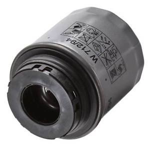

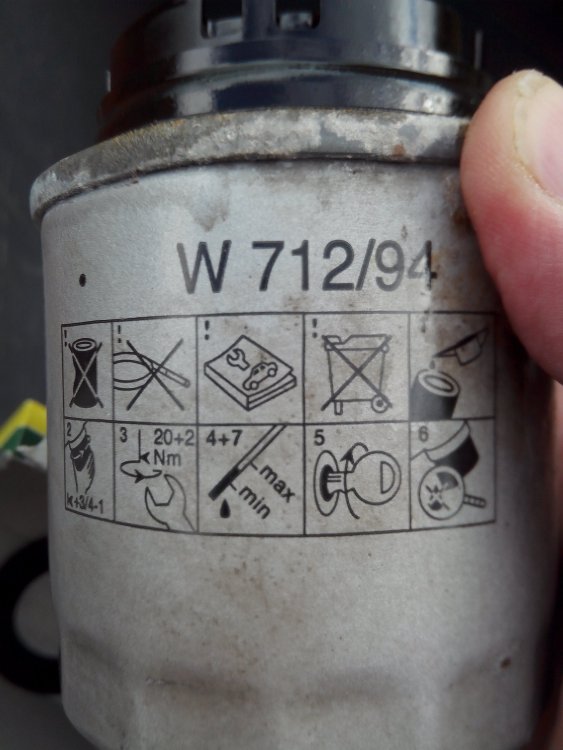

Make sure you fit the right filter, some dealers, for reasons unknown, fit the filter for the 1.4 tsi which fits but is the wrong filter with different seals.
Correct filter style (Mann) W712/94 (or VW, Hengst, Bosch etc equiv)
Wrong filter style  (Mann) W712/93

Hi everybody, to clear up some things the oil in the car is 504/507 5w30, I will change this when I fit the new oil filter, luckily the oil filter is the correct type and the oil itself looks very clean bearly any blowby contaminants it's like honey with a slight darkening.
