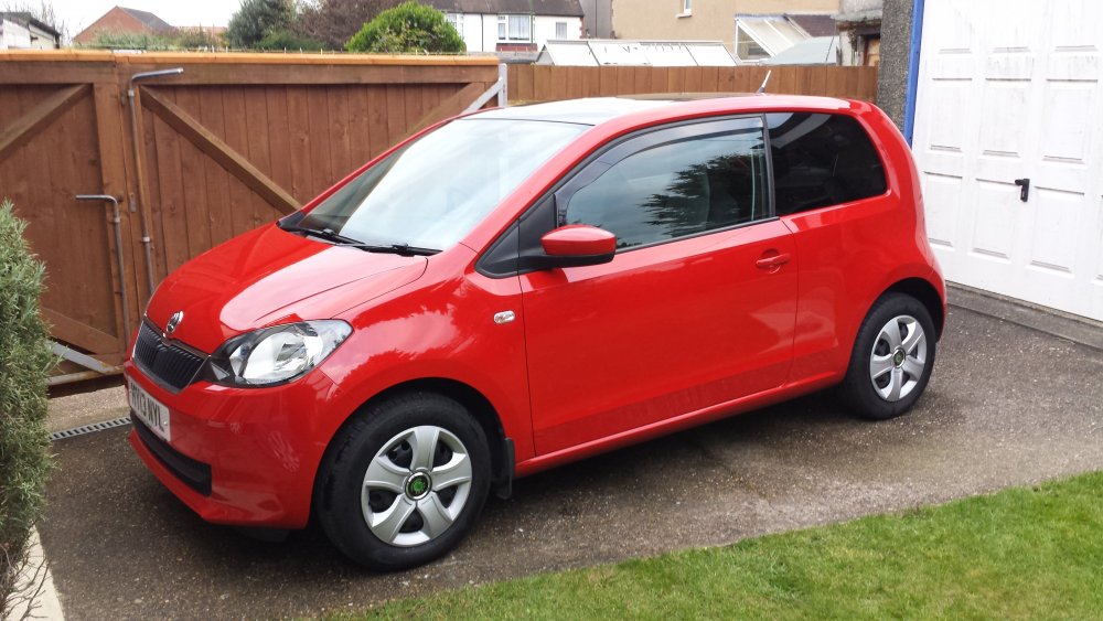

80,000miles service complete (with cam belt)
Following on from the 70,000miles service  our citigo ASG has now just had its 80,000mile service being nearly 5 years old
It took speaking to Skoda UK to get an exact change date/miles for the cambelt on the citigo ... which is 5years or 120,000miles (whichever is sooner). Our Citigo is approaching 5 years so we have decided to have it done now at 80,000miles by our choice. I'd be interested to know how many 5year old Citigo's have had the cam belt change.... even with lower miles on the odo.
The cost was was an agreed price of £160 for the oil service and £340 for the cam belt change
The service provided included a taxi to cover dropping off at work and later collection back to the skoda dealership.... around 16mile round trip.
Our citigo remains faultless but we are disappointed we cannot order another the same as our current one.
