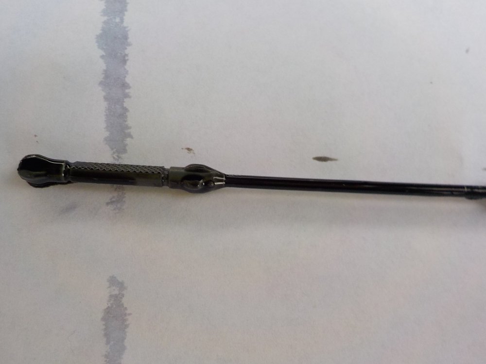

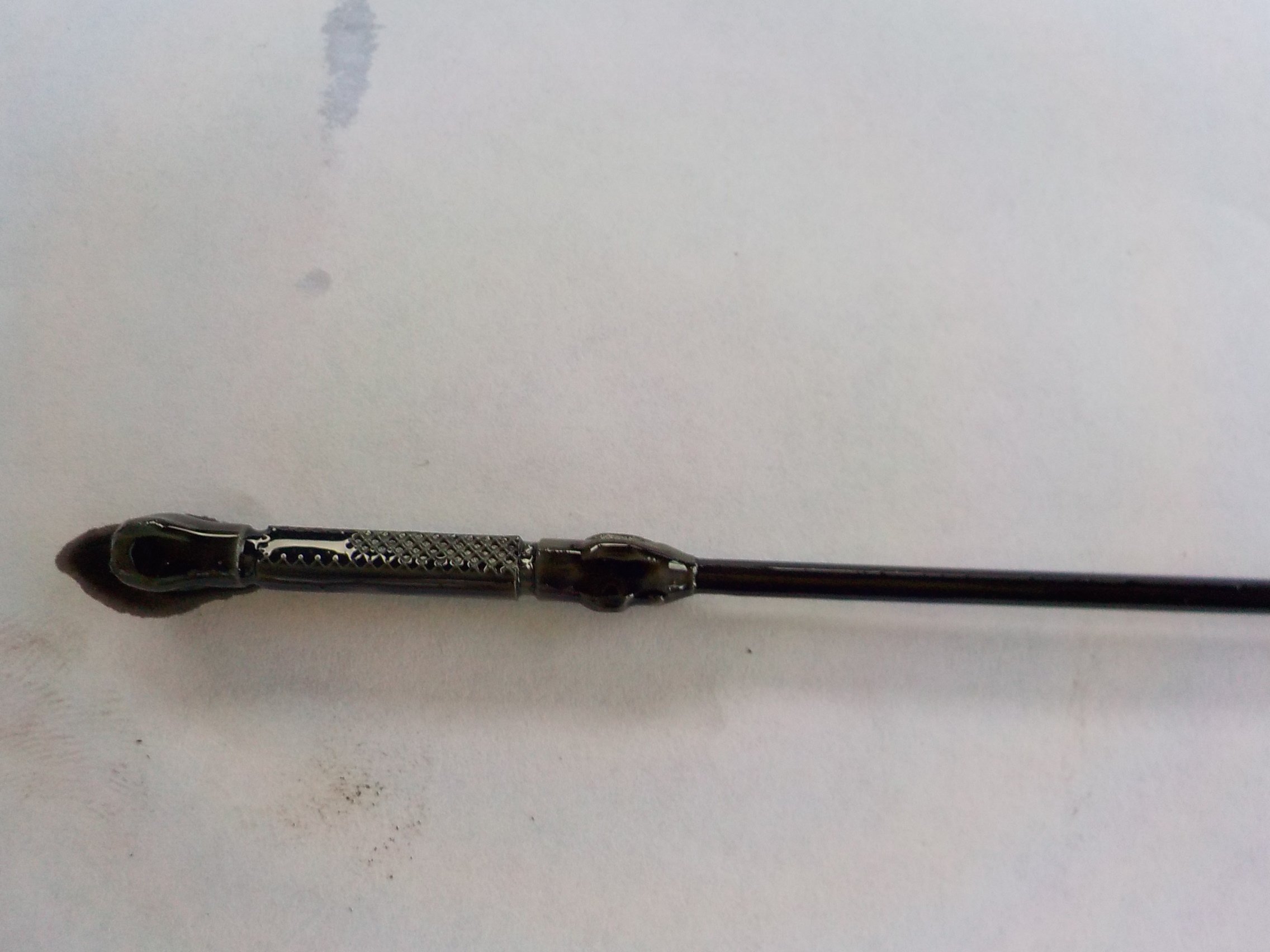

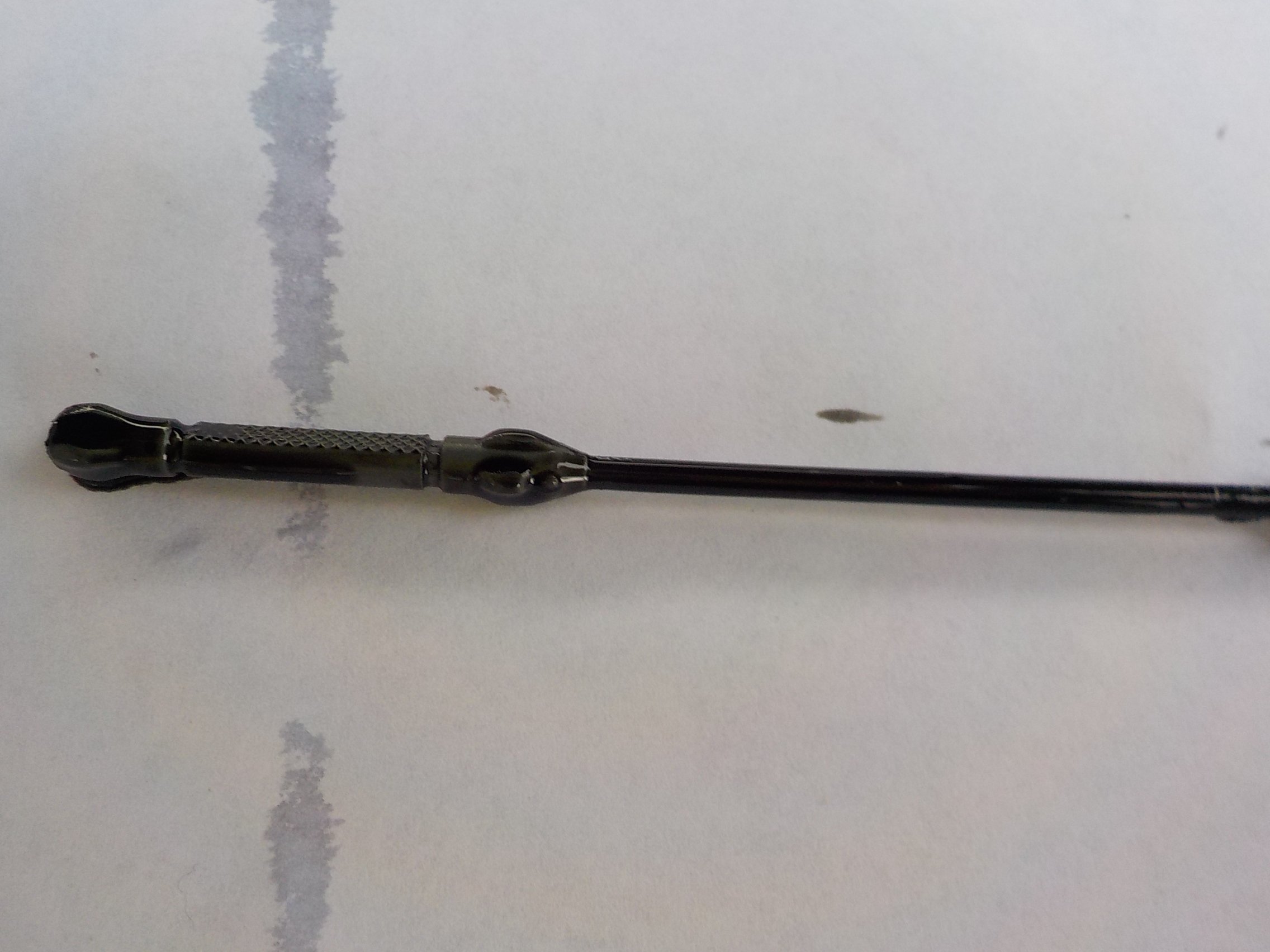

'Simply clever' is checking oil from time to time.  Waiting for Low Oil Lights or Warning or Low Oil Pressure before knowing the oil is low is not!
PS.
I would be checking your oil level now, because 1 litre is maybe not enough.
Checked at operating temperature.
I needed to put in over 1 litre last week in a 2.0 TDI SCR 150 ps DSG and there had been no Warning Light or message.
(there was a debate going on in this forum on Cold Check Levels and 'At Normal Operating temperature' as per 'Manufacturers Guidelines'.
The car was serviced at a main Dealers about 2,000 Miles before @ under 20,000 miles.
From new to that first service it needed 3 litres of oil to keep it at the correct quantity.
Oil checked at Operating Temperature, then 1 litre added and checked at operating temp and another 0.5 litres was then added.
Correct level now in. & will get checked today.
Edited by Offski
Why do people never check anything anymore?? Oil, water, brake fluid level, tyre pressures all need to be checked regularly. Waiting for a light can often be too late. Do not buy a second hand car from such people (probably in the majority).
Used to be drummed into you when learning to drive a car.
Now driving instructors teach you to ride the brakes and not use engine braking. Great for kwikfit, greater for dealers, bad for the environment, bad for proper safety training, tell me what do you do if brakes fade or fail to slow you down?
Enjoy the trip down that mountain pass guys.
A  TSI or TDI driver waiting for a 'Warning light' or message can be running with low oil quantities for a lot of miles / km.
Remember if you open the bonnet and do nothing but it is open for 30 seconds the warning light goes out.
If you do not put enough oil in or no oil the light is still out.
1 litre top up after a warning light or massage might mean you are still running a car for a good few thousand miles with low Oil
1 litre of new oil added to crappy old stuff that was getting hard used, low quantity....
