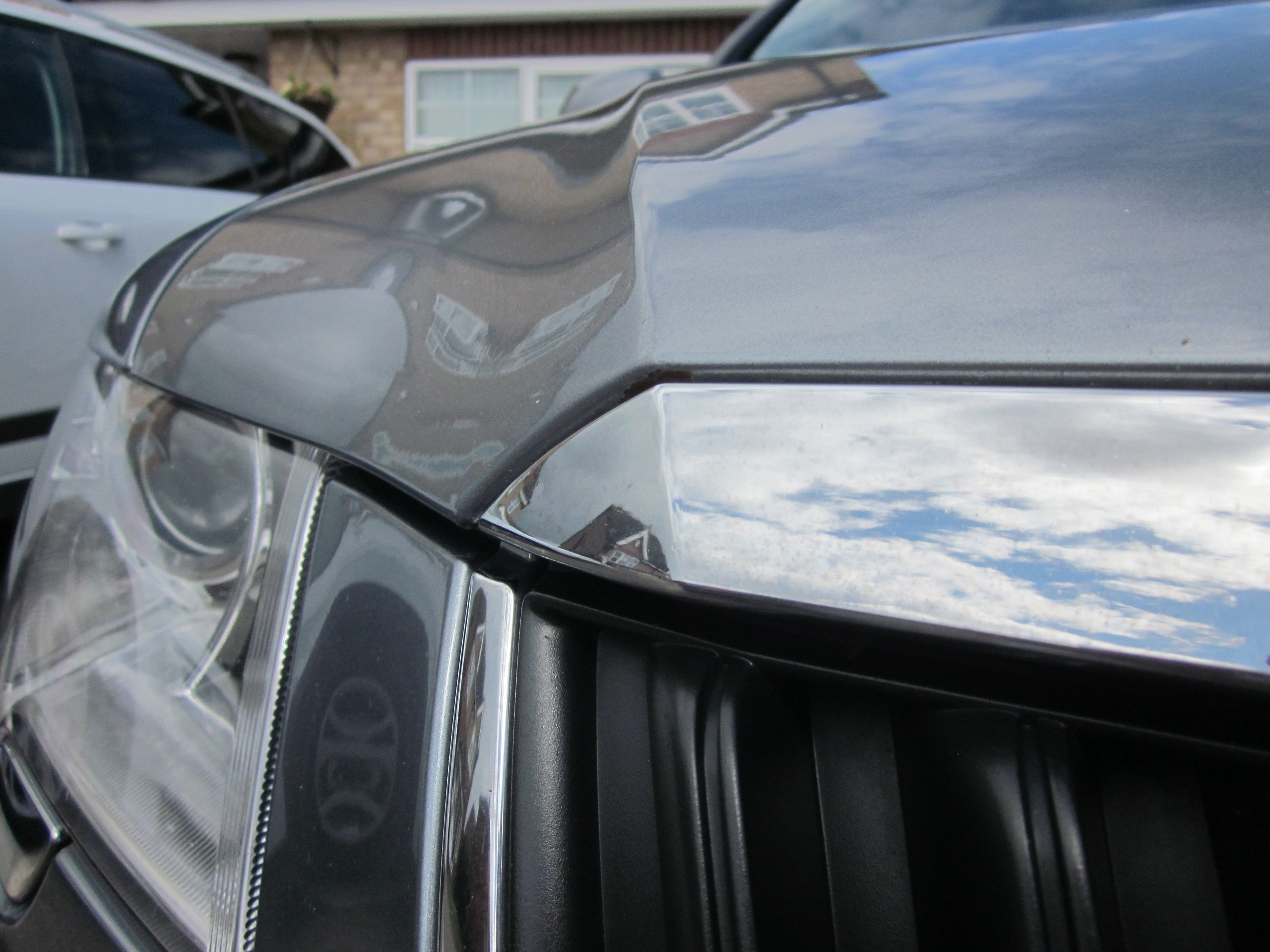

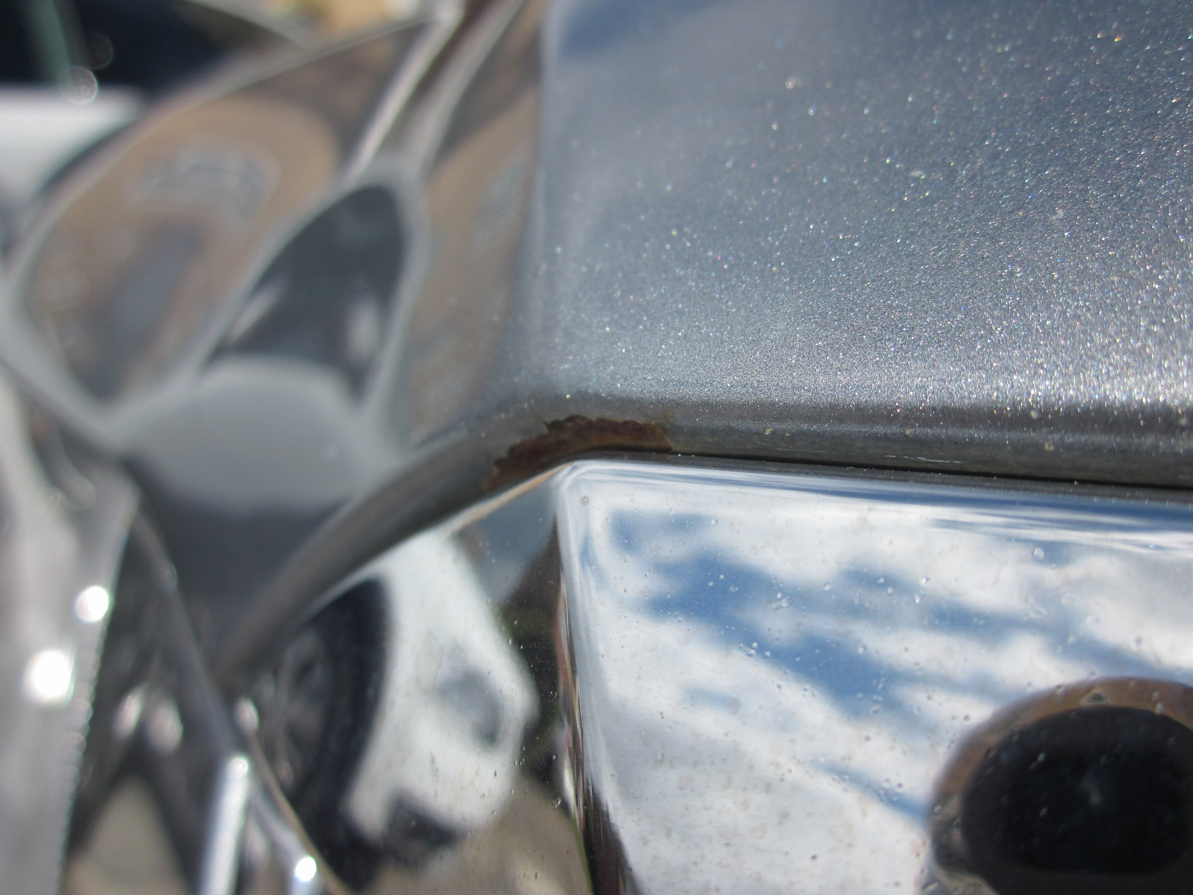

My 8 year old, 153,000 mile Superb is booked in next week for a new bonnet at a Skoda main dealer under warranty, it has rusted behind the grill...
It appears some dealers keep to the Skoda warranty (and a good reputation)while others  fight against any recompense .
Mine wasn't as straight forward as I alluded to.
The rust was first noticed three years ago. The first and second repairs were on-site smart repairs, which looked great, but didn't last longer than a year.
This'll be the third repair, and instead of a smart repair it's going into the bodyshop for a brand new bonnet. A tad overkill, there's probably only 3 or 4 years left in the old girl. If a smart repair could be made to last a bit longer I'd prefer a third attempt.
But at least the Skoda dealership acknowledged there was an issue and dealt with it.smart repairs don’t usually have a long life but I’m sure there’s somebody on here who’s had better results.
