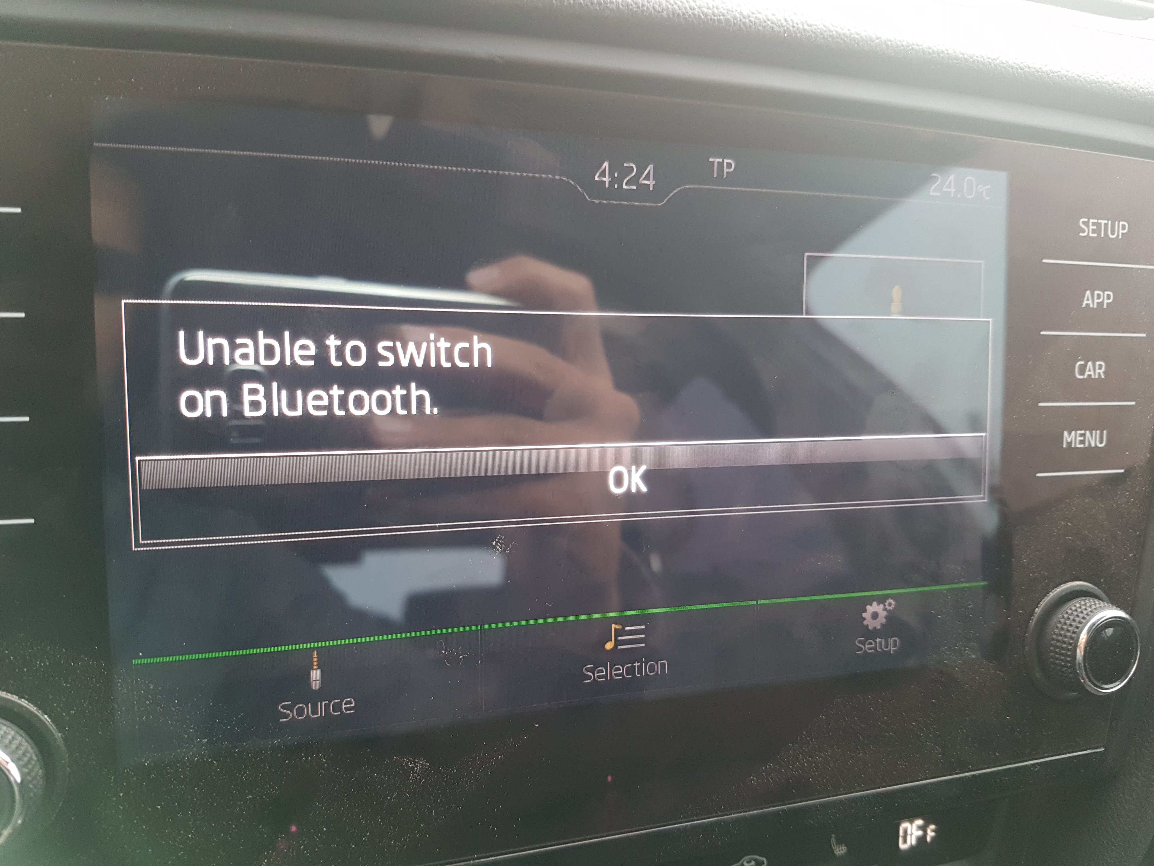

Bluetooth ?? Help me
Have you tried going into the menu, settings and doing a system reset?
I had this and other messages,like searching for phone, dealer did an update , since then its been ok, the quick way to cure it is a full reset from the menu turn off, lock car, leave for a few mins get back in and it should be ok
