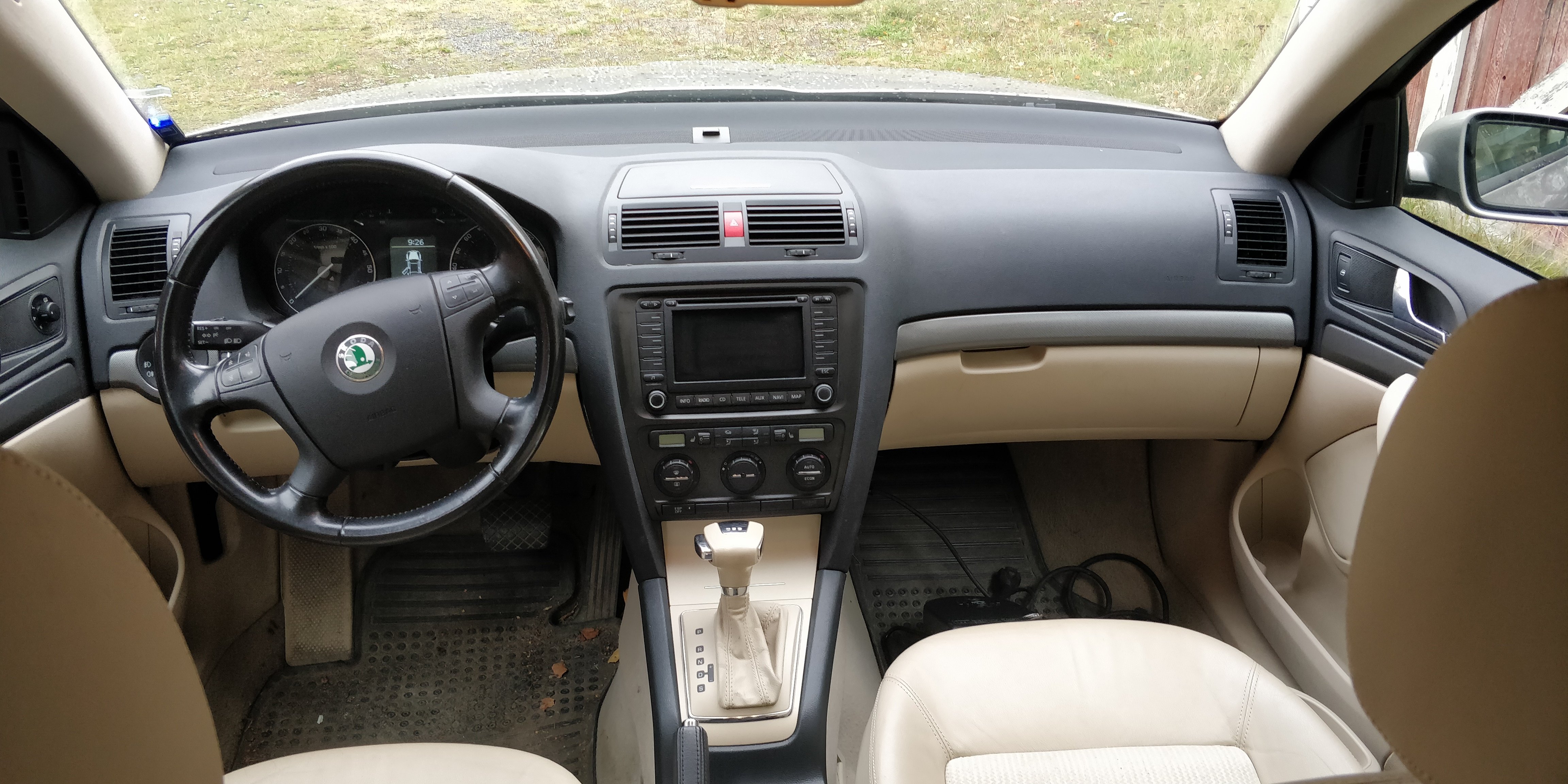

This is a picture of my interior. It's a FL right?
Maxidot display version one can see... wingmirror shape... red hazard warning button... climatronic control shape... steering wheel shape... may be wrong, but that very much looks like a pre-facelift octy to me.
Edit; Just noticed you said on the sidebar it's a 2007 model... It's definitely a pre-fl!! :D
Edited by blackspaven
Ah okay, but interior must have had a facelift? :biggrin:
A FL would have a different instrument cluster, steering wheel, climate control panel, headunit and hazard switch. Most parts are shared though.
Something like this:
skoda-octavia-8.jpg?itok=j8eZxbyB
Mines definitely pre FL. Thanks for clarifying. Sorry for the thread hijack. :blush
