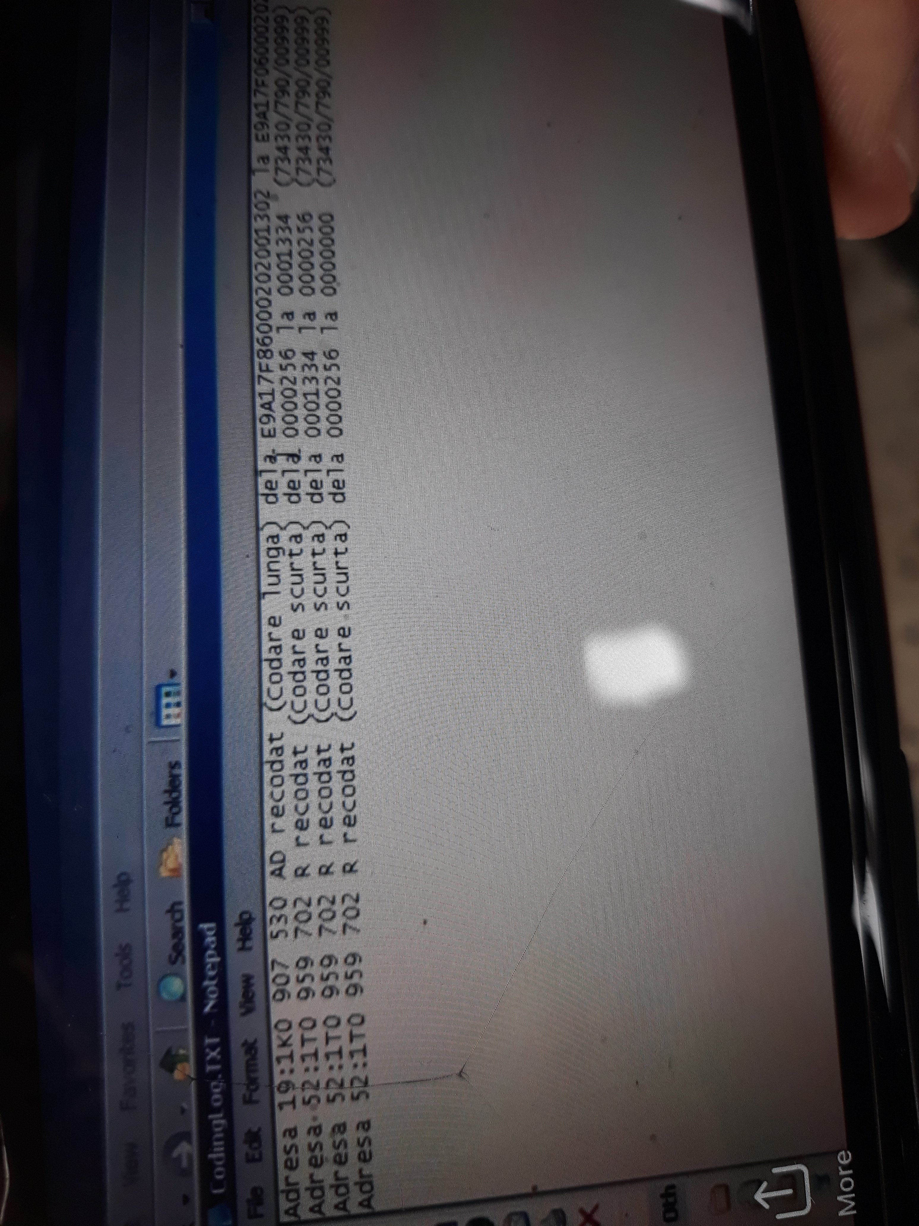

I changed in 52 where is the door but i doesnt say the original code
Well it shows the changes you've made: 0000256 to 0001334 to 0000256 to 0000000
