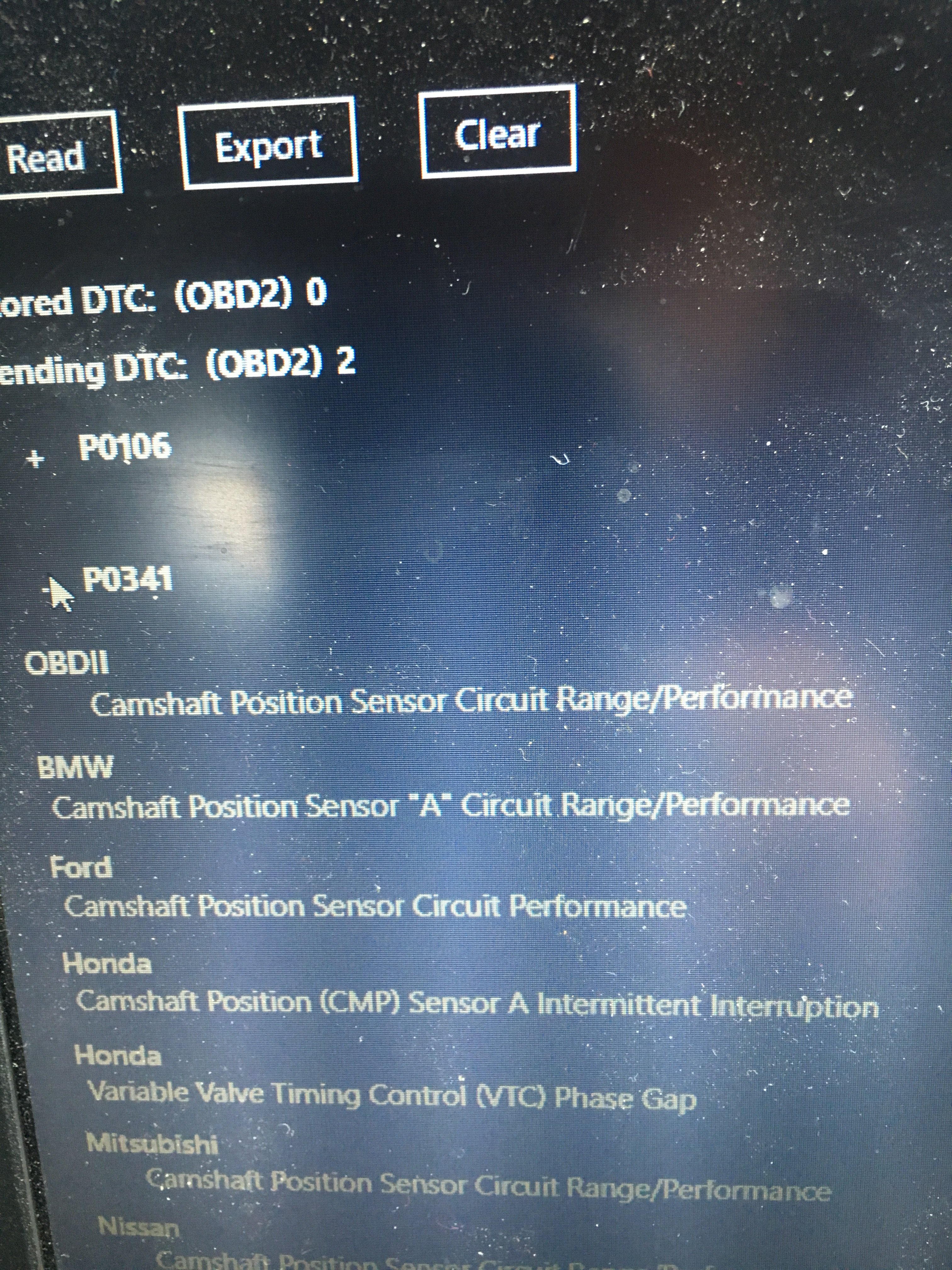

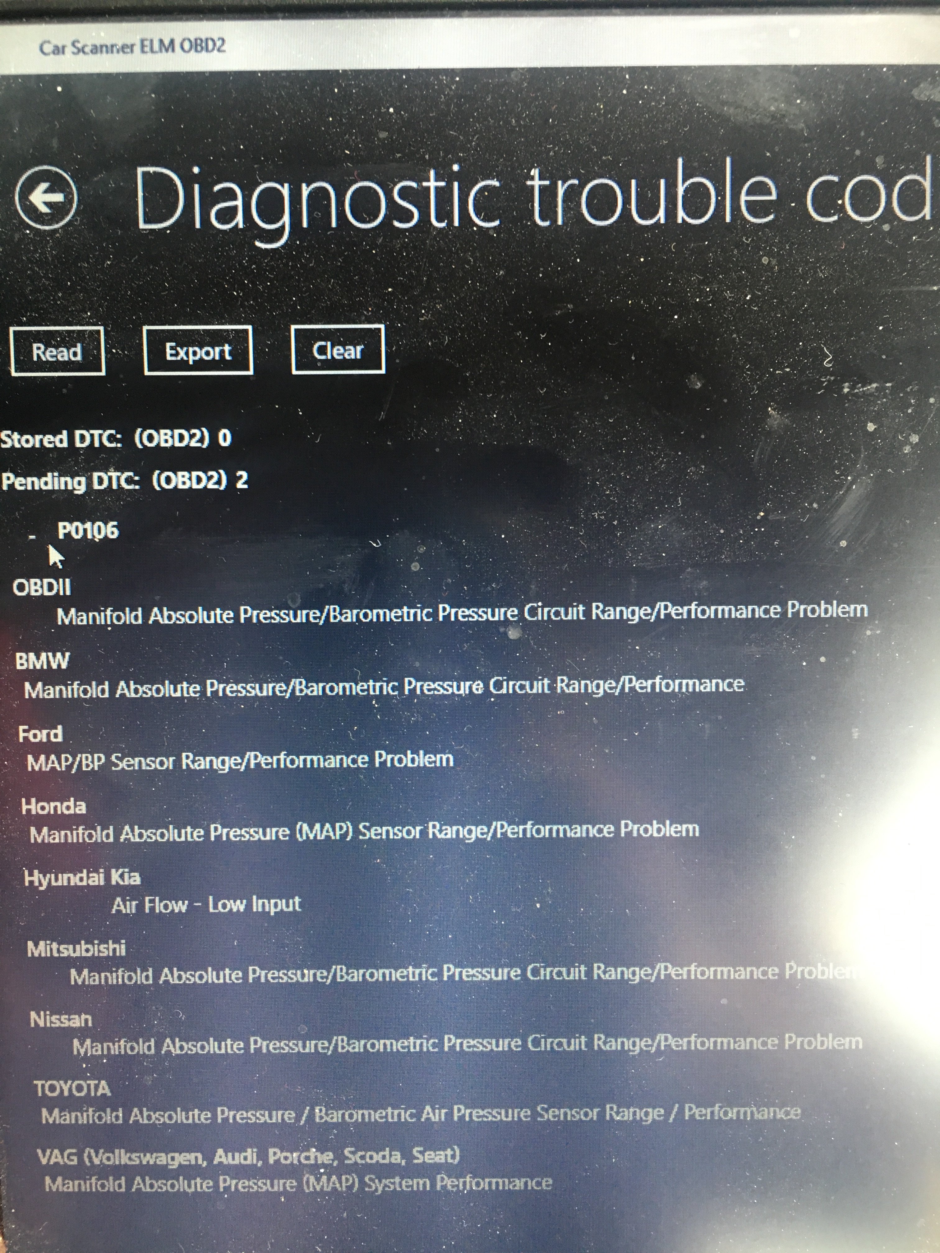

Having these fault codes on my 2003 1.2 fabia. See pics

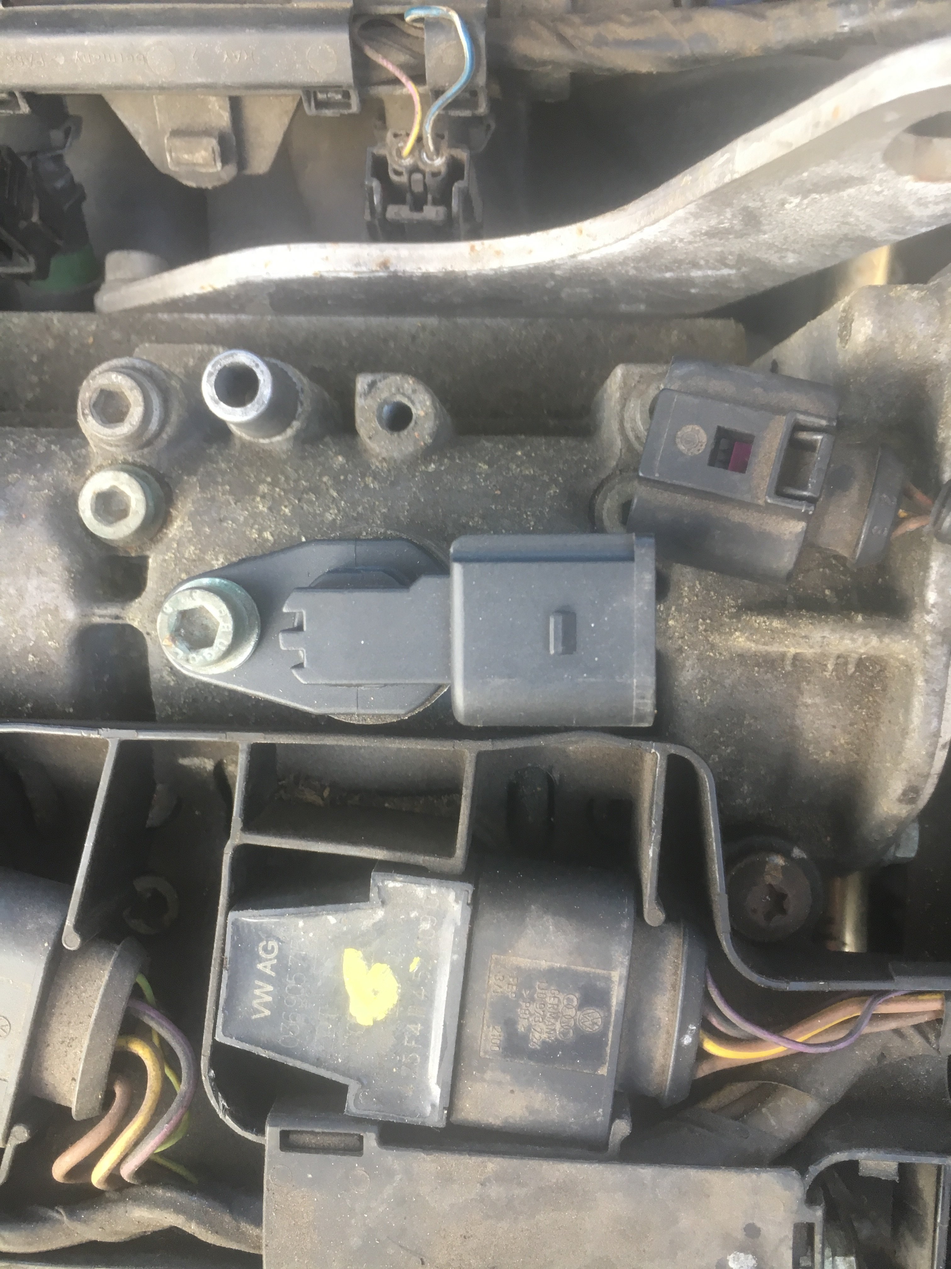

Replaced camshaft sensor with a brand new one but fault comes back
cant see any damage to the wiring ect.

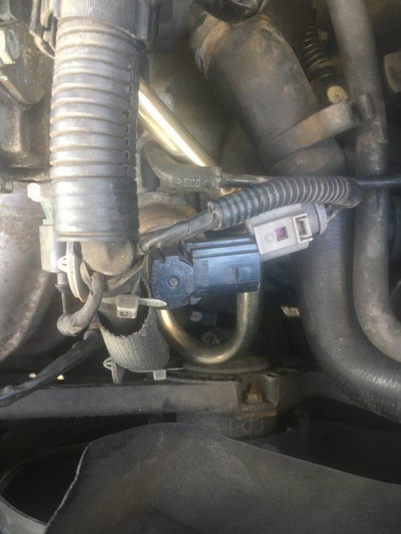

Also if i I disconnect the cam sensor and the egr (as pics) the car starts and runs rough exactly the same as when connected.
Any more ideas? TIA
update, checked timing cam positions like wino said and they line up.
Any more ideas? TIA
If you clear the fault codes down and run up what is now present?

EGR isn't used during cold-start, or idle, so I wouldn't expect that to make any difference. If cam sensor data isn't available, the engine management just goes into batch firing of the injectors instead of sequential, I seem to remember; so again, probably wouldn't be noticeably different anyway.
EGR potentiometer, cam sensor and MAP sensor all share a 5V supply out of the engine ECU though, so maybe check that 5V is present on (say) the cam sensor connector with ignition on?
Pin 1, red/green wire, relative to pin 3 earth brown/blue wire
