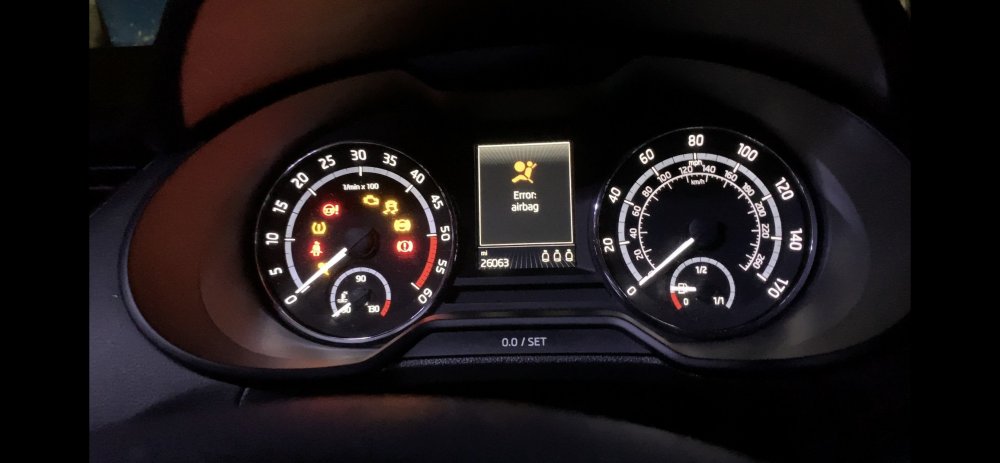

I've had an error flash up on my 2015 vRS to do with the airbag.  I get "Error: Airbag" with the airbag symbol on the MFD every time I start my car and then the airbag light on the dash comes on.  I've tried clearing the error using OBDeleven but this doesn't work.  The attached photos show the message on the dash and also the error code on OBDeleven.

OBDEleven should be able to clear airbag faults and this is apparently a known issue that flags up from time to time.
That said, I have seen reference to the slip ring on the steering wheel too.
Skoda should be able to verify though.
