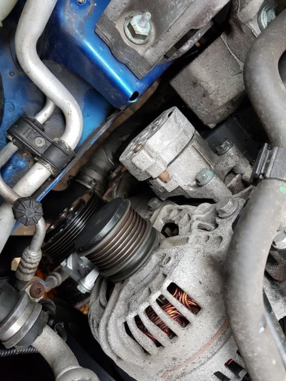

Its difficult to see what needs to be removed so the Alternator needs to come out next along with disconnecting the battery of course.

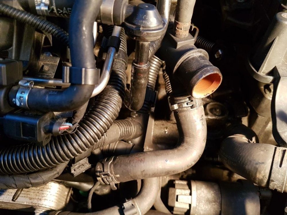

Hey preso the Thermostat is visible but not so accessible.

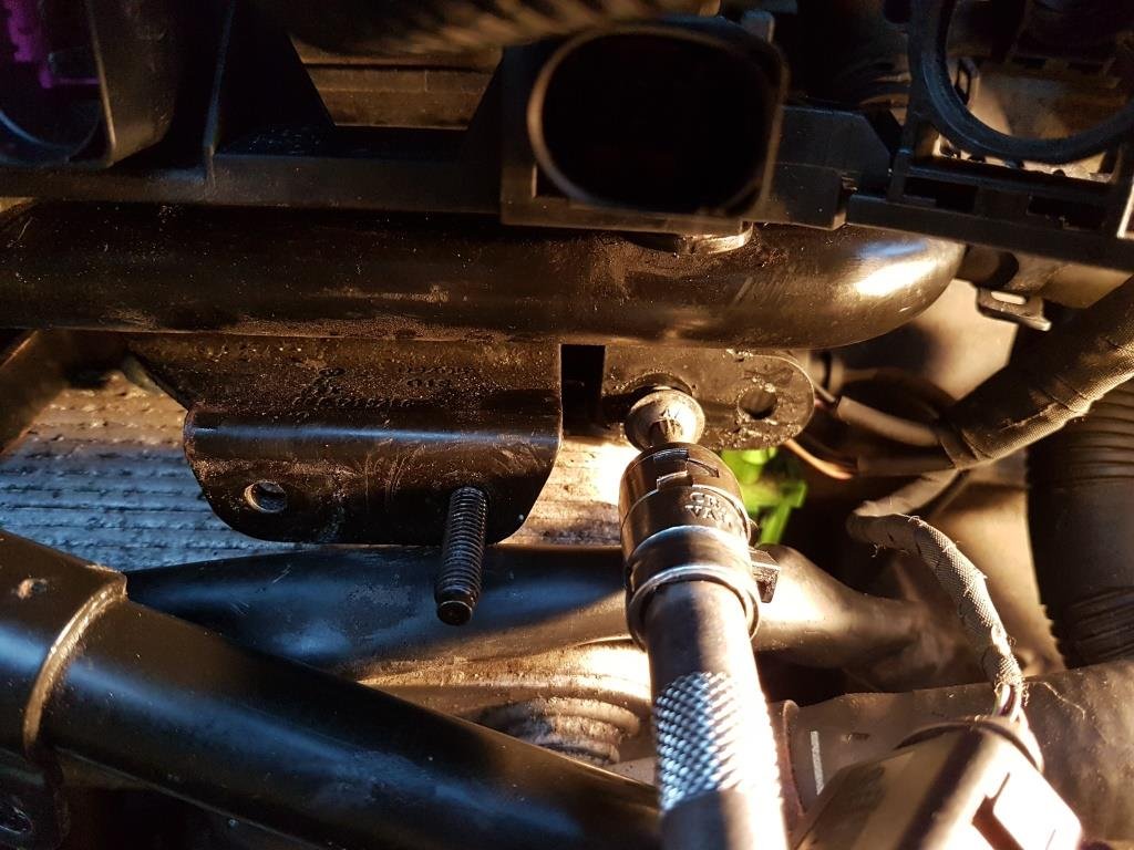

There are three water pipe connections. I removed the metal spring clip on the large hose and it refused to undo, more later.

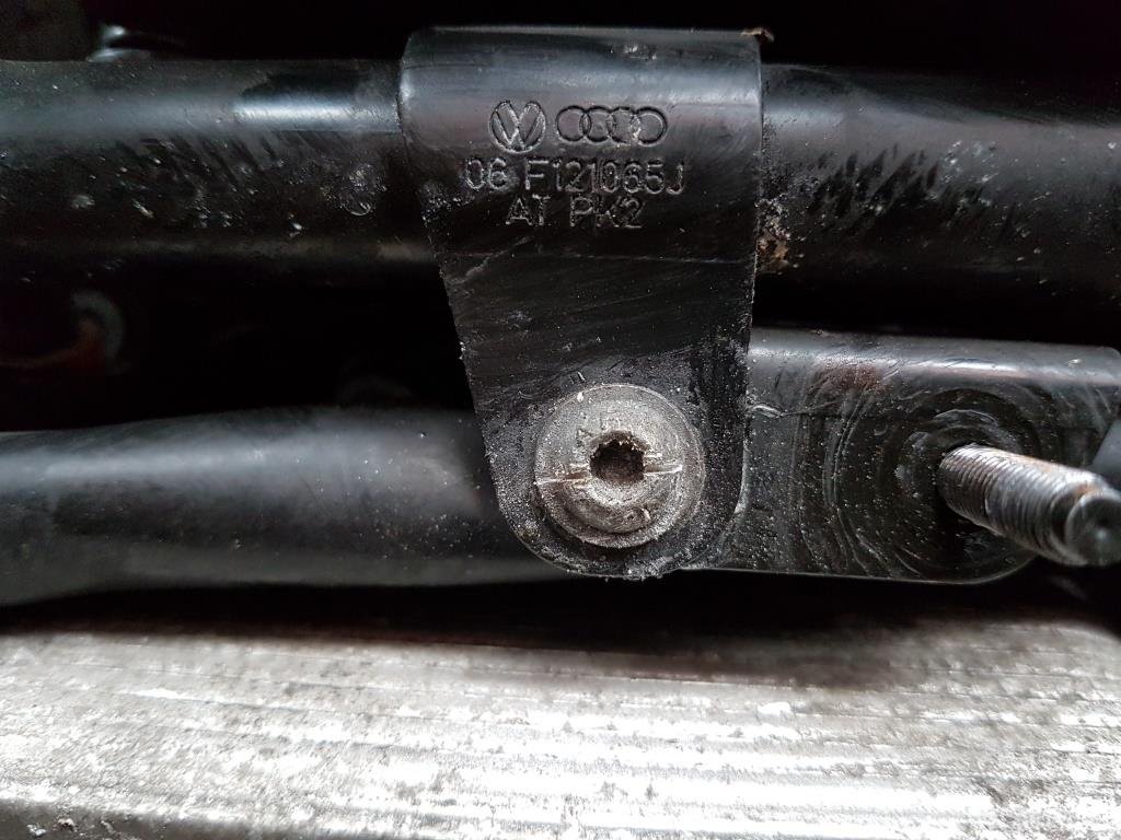

I tried to remove the front water pipe which has one bolt M10 into the pump housing and an 10mm nut on the dipstick no chance of it coming out yet! the metal pipe extends along the front of the engine back to a junction of hoses returning water into the engine. I released two pipes here off the plastic junction as the rubber hoses weren't stuck so fast. The spline bolt head refused to budge and stripped the Internal splines M5.
At this point I removed most of the wiring sockets across the front of the engine for better access. There is a plastic support on 2 studs for the wiring on the second water pipe behind the first which need releasing.
I then carefully used a Junior hack saw to cut a slot in the offending bolt and managed to undo it with a Flat blade 3/8" drive socket and ratchet. The first of the three pipes into the housing then came out!
I loosened the two bolts on the thermostat housing which gave me access to the larger hose on the top of the housing as fitted, it connects to a second metal pipe. After a struggle I got the clip free and the hose came off.

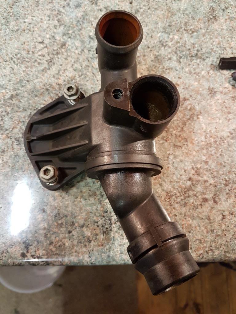

I removed the Thermostat housing bolts into the cylinder block and pulled hard and the large hose released  from the housing.
So after all that cleanliness and some lubricating grease and it all goes back together a lot more easily.
