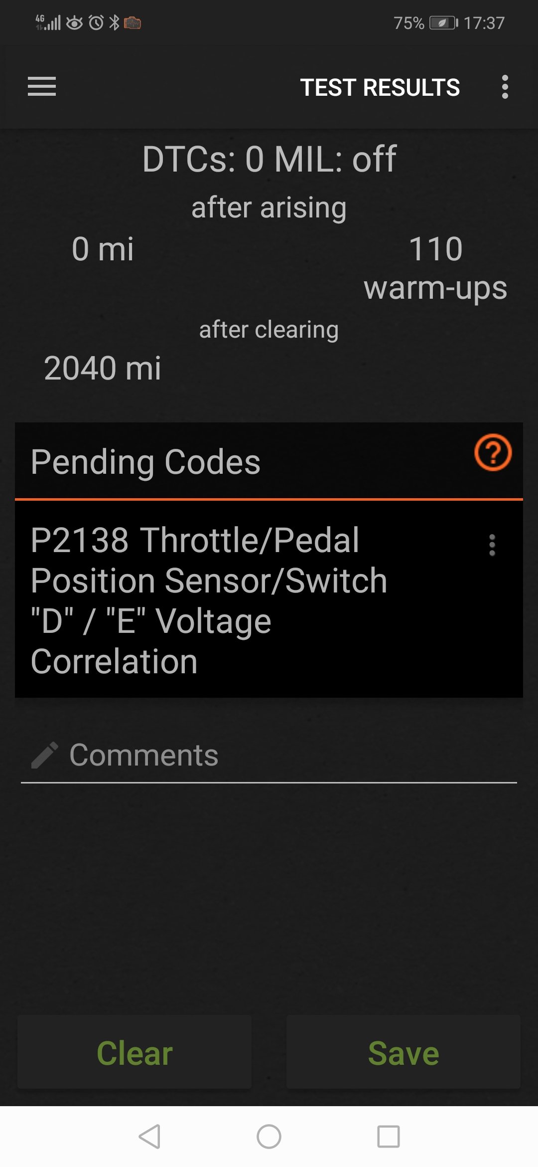

Sometimes epc comes on and skidding if I turn of and on engine they disappear this code I get in the pic any help please

I had the exact same symptoms, also my car went into limp mode (no power wouldn't get above 50mph) it was diagnosed as the TPS (throttle position sensor) was throwing the fault up. If you read on it was my battery that was duff. I see that fault code pic you posted up shows  D/E voltage correlation, my tech guy at the garage said it's most likely the TPS isn't getting the correct voltage to it re battery down on power.
Anways a new battery solved my little problem, all well now for a few months after the battery was fitted. As a observation I see your car is 2014 model, same as mine........tech guy said they don't last long these days, he's seen many VAG cars throw codes up and it's been the battery. Incidently a new TPS was quoted @£112 + fitting, I never needed one.
I would get your battery checked out first, not saying it's your problem but you can eliminate it from the cause.
