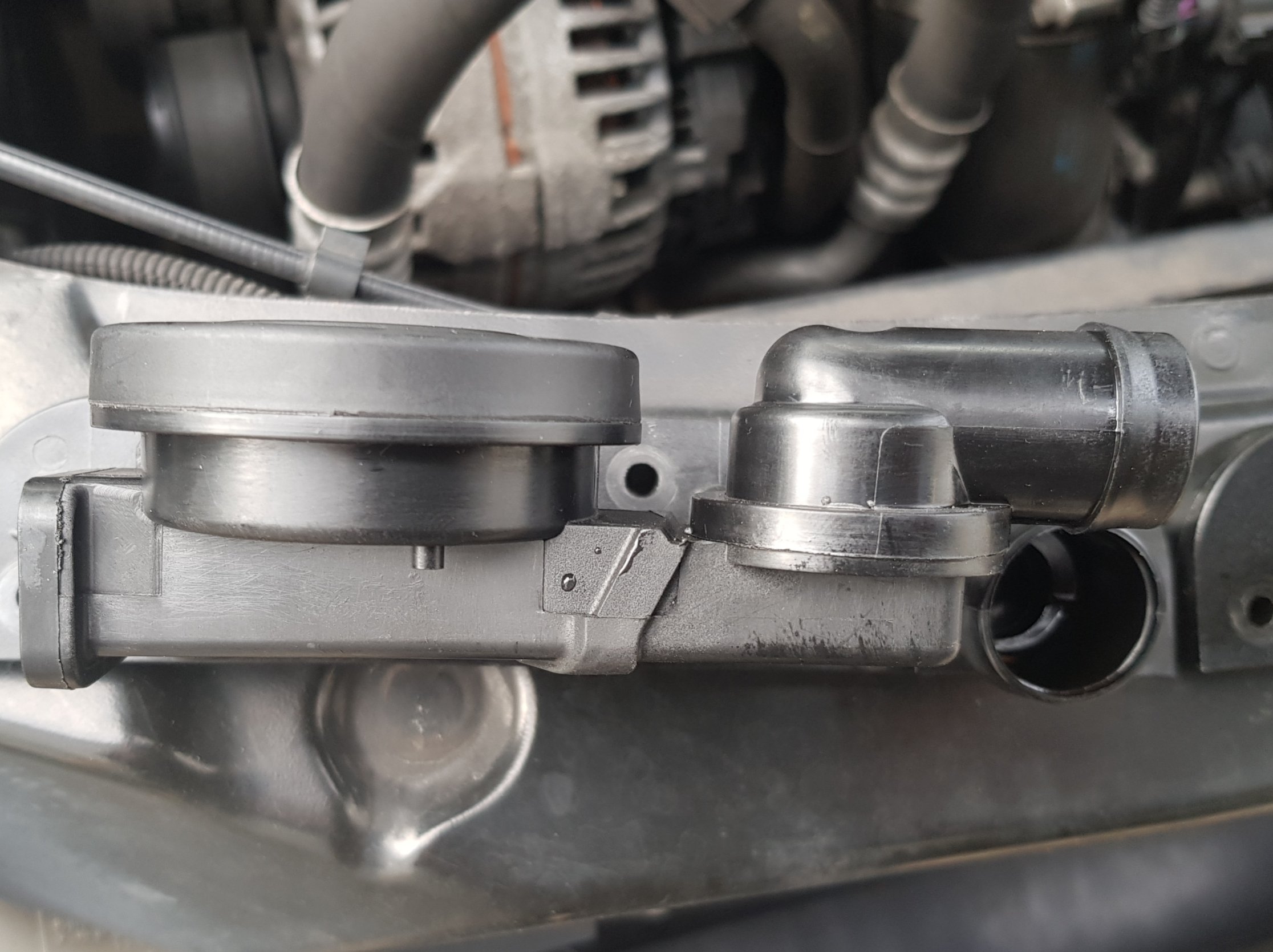

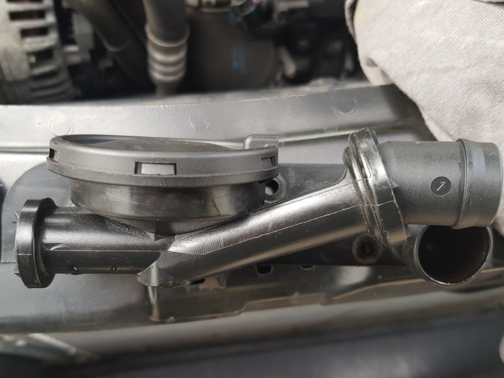

Got an 06 TFSI VRS was starting to have a slightly lumpy idle, knowing the PCV can be the culprit I opened her up and sure enough the diaphragm was split :wondering:

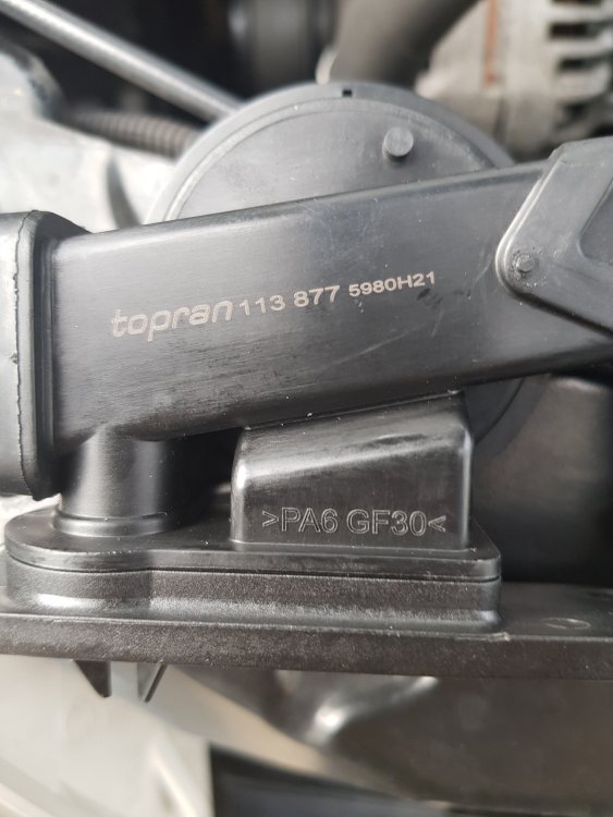

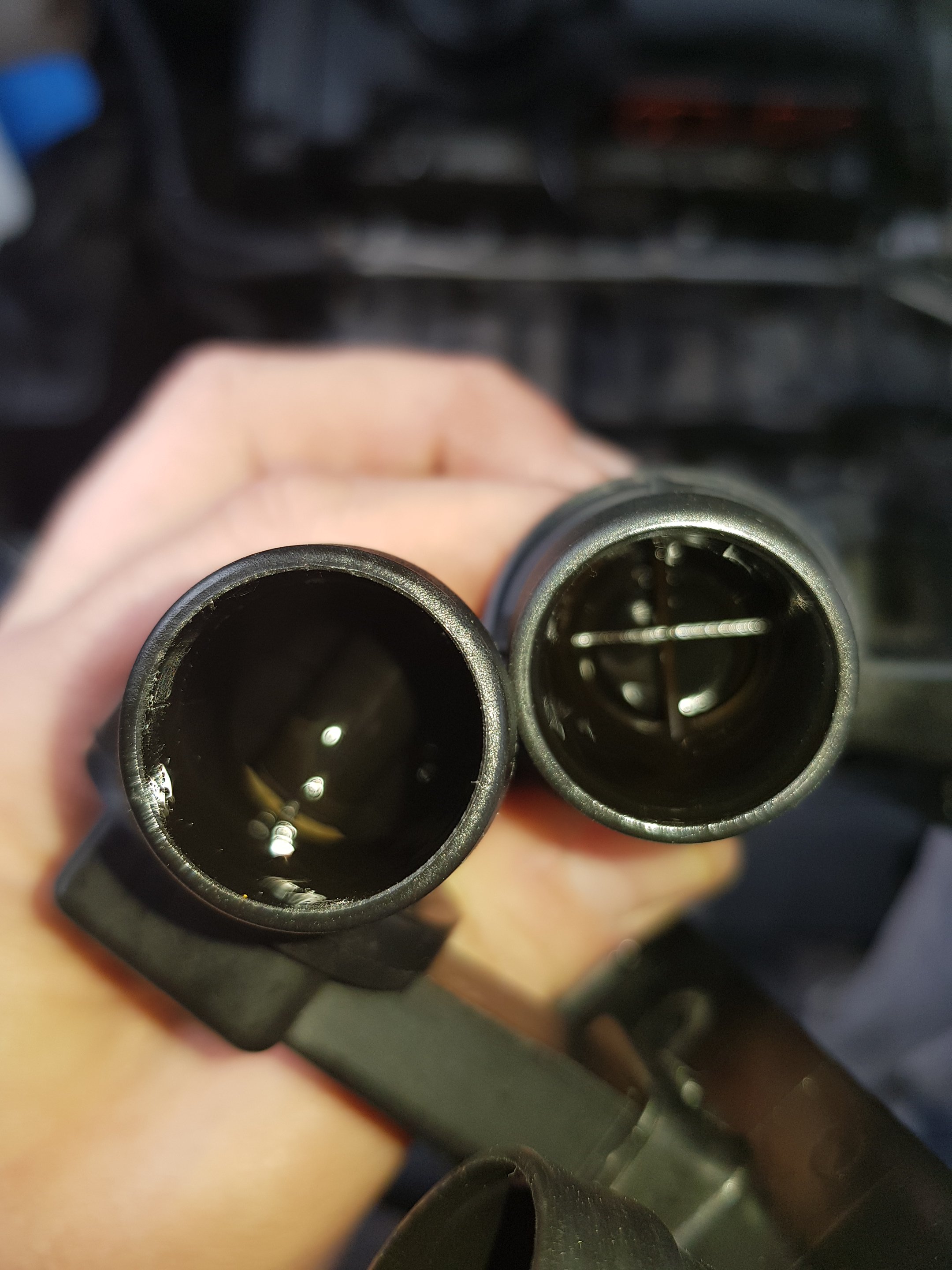

Ordered what seemed to be a decent pattern part off eBay with a new gasket etc but the shape was slightly different and the internal valves also were different. After fitting the engine seemed to be struggling and started intermittently shaking, doing a quick diagnostic it showed a lean code. Took it off and put the old one back and and cleared the code, gone back to normal and code hasn't come back. My code is on the pic attached..
Anyone else encountered this? Going to bite the bullet and buy OEM I think!

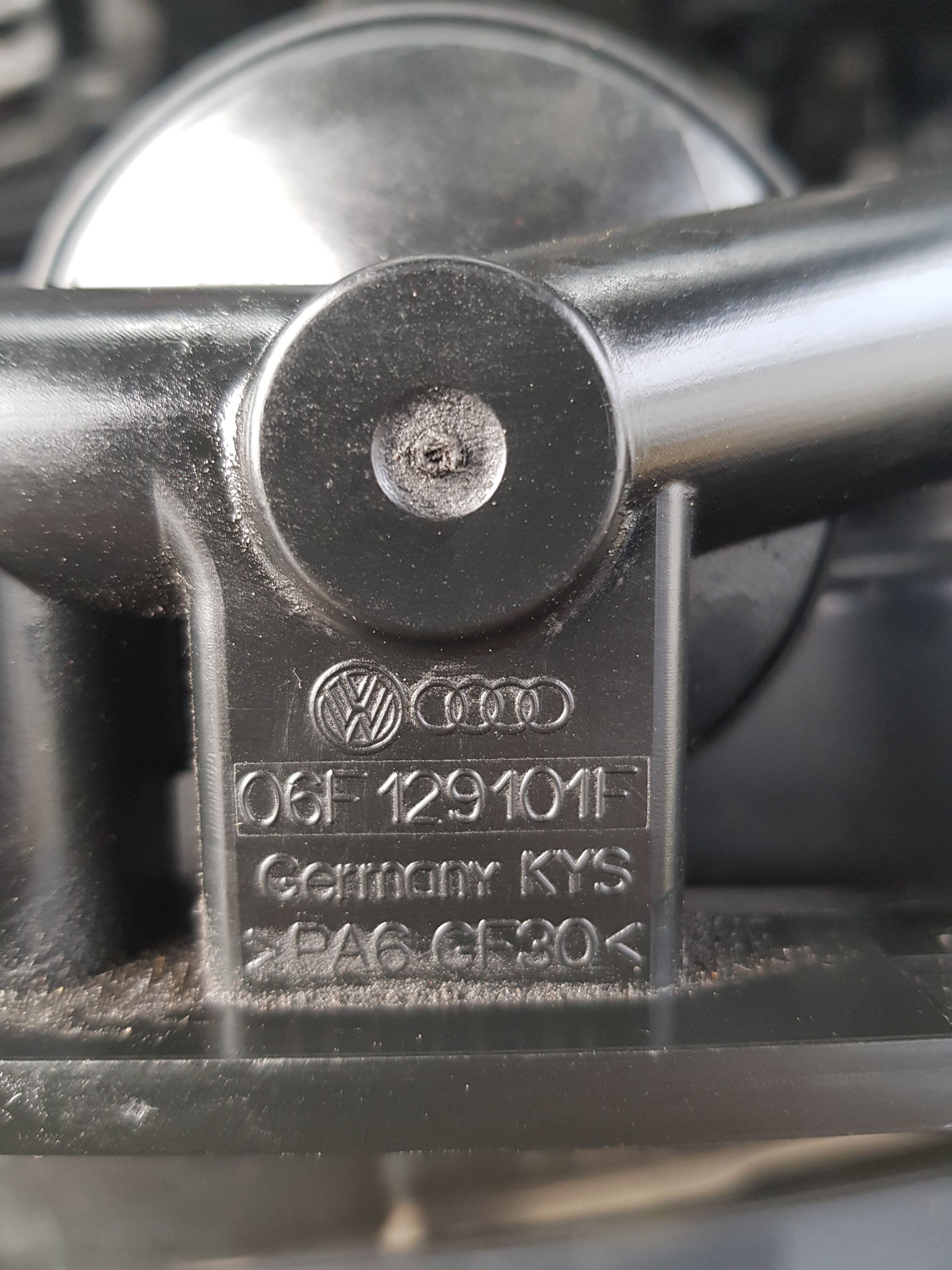

Hiya,  could I ask what the revision number on the new part was?
I'm looking at doing the same (on a 57 plate), I've got an F rev currently same as yours by the looks of things.
Hi Jamie,
See picture attached mate, No direct part number matching anything Skoda but might give you something to go off. The eBay description matched my Skoda F part number, they have refunded me now.

The suffix-F part appears to have been superseded a large number of times, and currently seems to be at R (using this site repeatedly: https://oemwolf.com/).
Thanks Alan, shame - I was wondering if what you had was the P revision (which required the back side valve, replaces the rev G line) or the R (apparently latest to replace the F?).     Hard to find proper pictures of the two to compare, guess I'll bit the bullet and order the OEM R version to try :)
Wino - yes, thanks that's why I was wondering which one Alan had as the replacement, from lots of reading there are two revision lines which may or may not need the rear PCV pipe changed but I can't find any proper confirmation that my 57 plate (with the F revision) will work with the R without that back replacement.  I'm guessing it will but..  :)

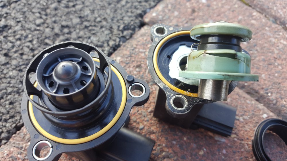

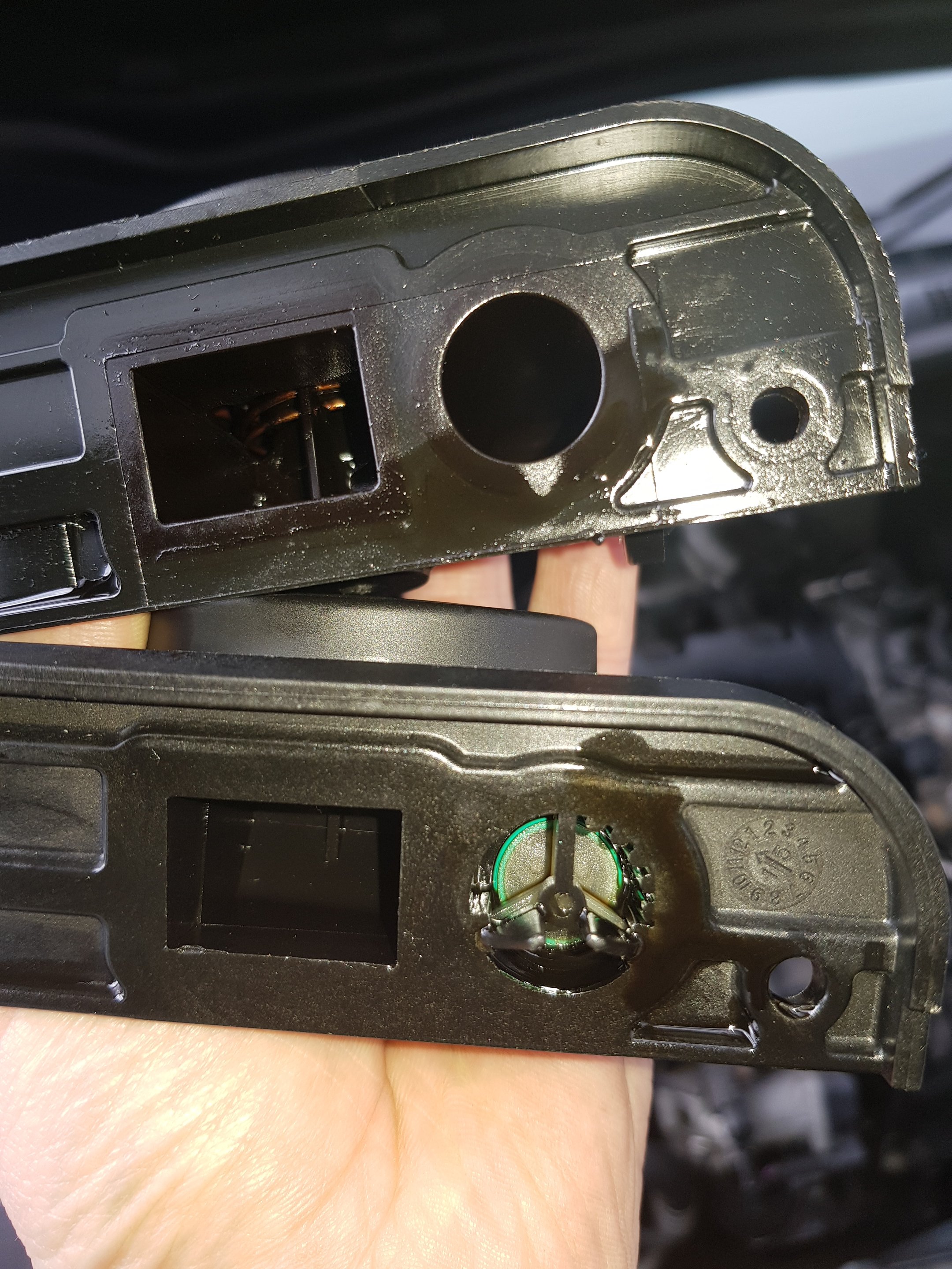

As for the DV they will give you the uprated piston type like in my picture... note the other picture with the old split one.

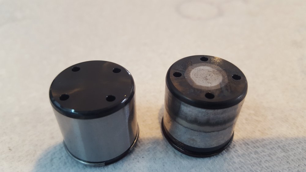

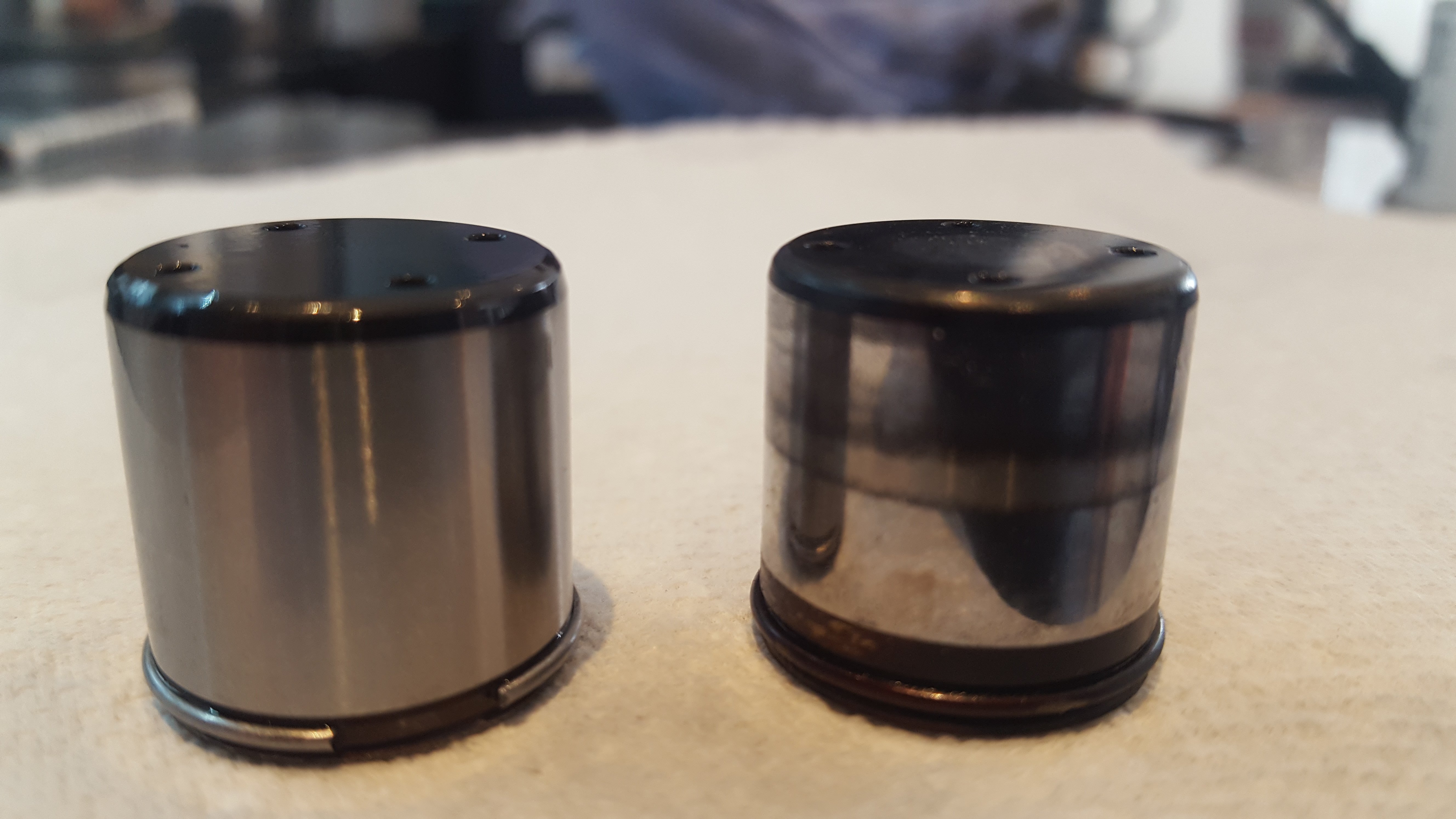

I'll add pics of my Cam follower too, mine was on the verge of starting to cave in so an essential maintenance item to change considering the damage it can do! Very easy to change if you take your time, don't worry about getting it to TDC. It just puts less pressure on the spring inside the HPFP if it's in TDC due to the Cam lobe pressing on it. Only hardship is the connections on the bottom of the HPFP, if you have 2 rubber hoses going into the bottom then it's easier but if you have a brass connector it's more fiddly. I'll add a link to the guide i used below.

They got the rev G which is the uprated diaphragm version I believe and bloody hell has it made a difference, so much more responsive I wish I'd done it sooner now.  Also fixed the P0299 Boost Pressure: Control Range Not reached which I've had since I've been able to scan for it.  Happy with that.
