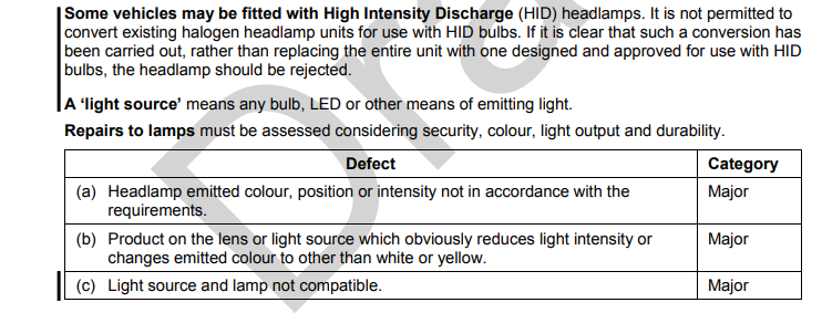

Can be done but you will fail next MOT Capture.PNG.9cd61b1ecc103e8e1443e29ed084fd68.PNG.a336a927ea2aab863ce013e6c7647eea.PNG
Of course you could get done after an MOT, gets you another year but would have to change to standard H7's at the test station, then switch back.

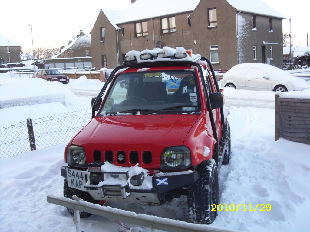

In the UK you can have a light bar, Spot Lights etc, Lights & Bulbs that Manufacturers put 'For Offroad Use' on,
but you can not dazzle other road users and these lights are not tested at UK MOTS.
