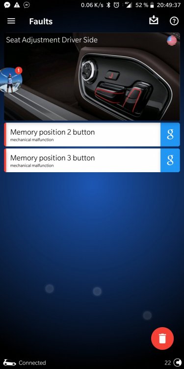

I scanned for fault codes and got this:
Mechanical error on program button two and three.

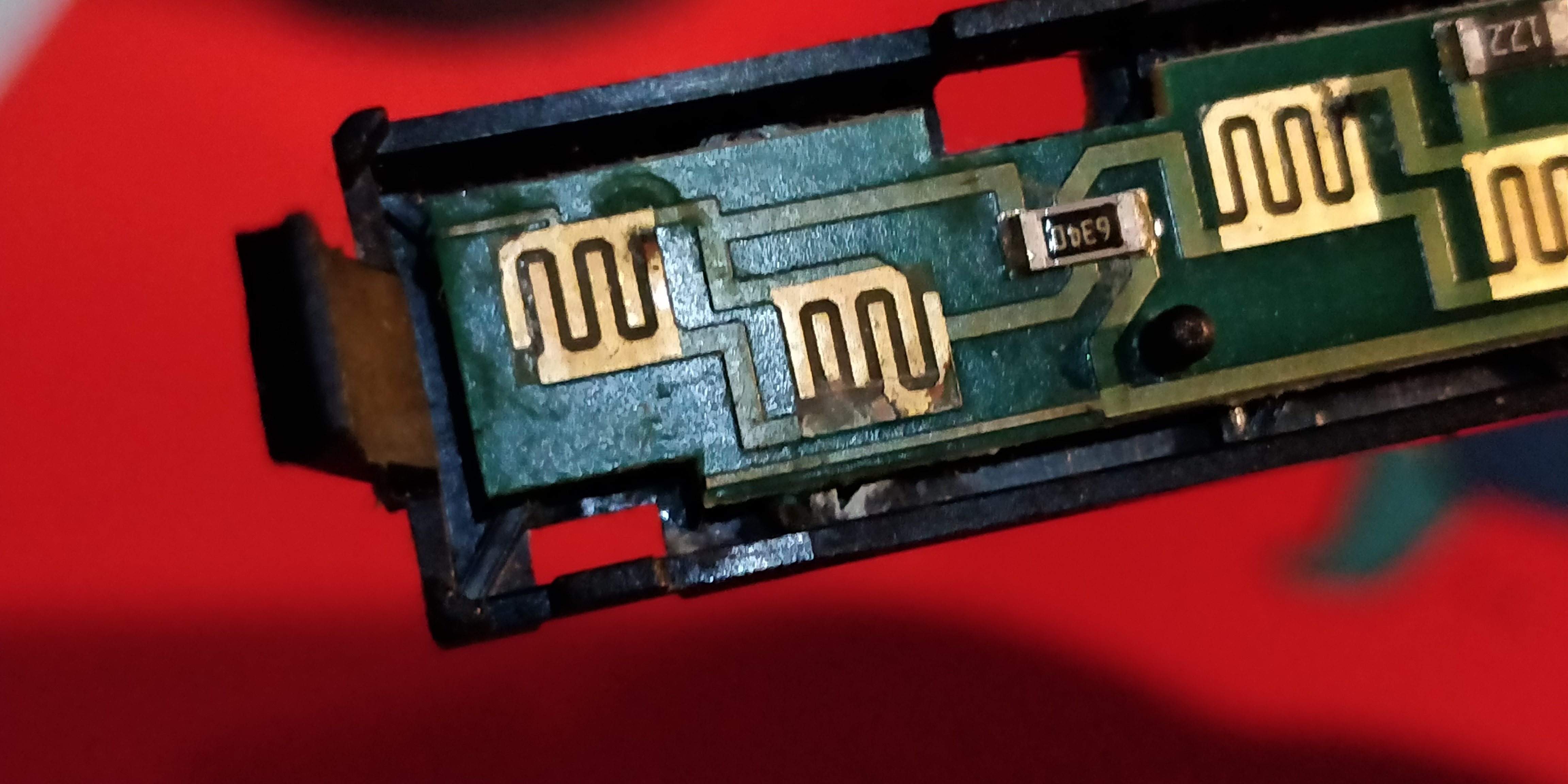

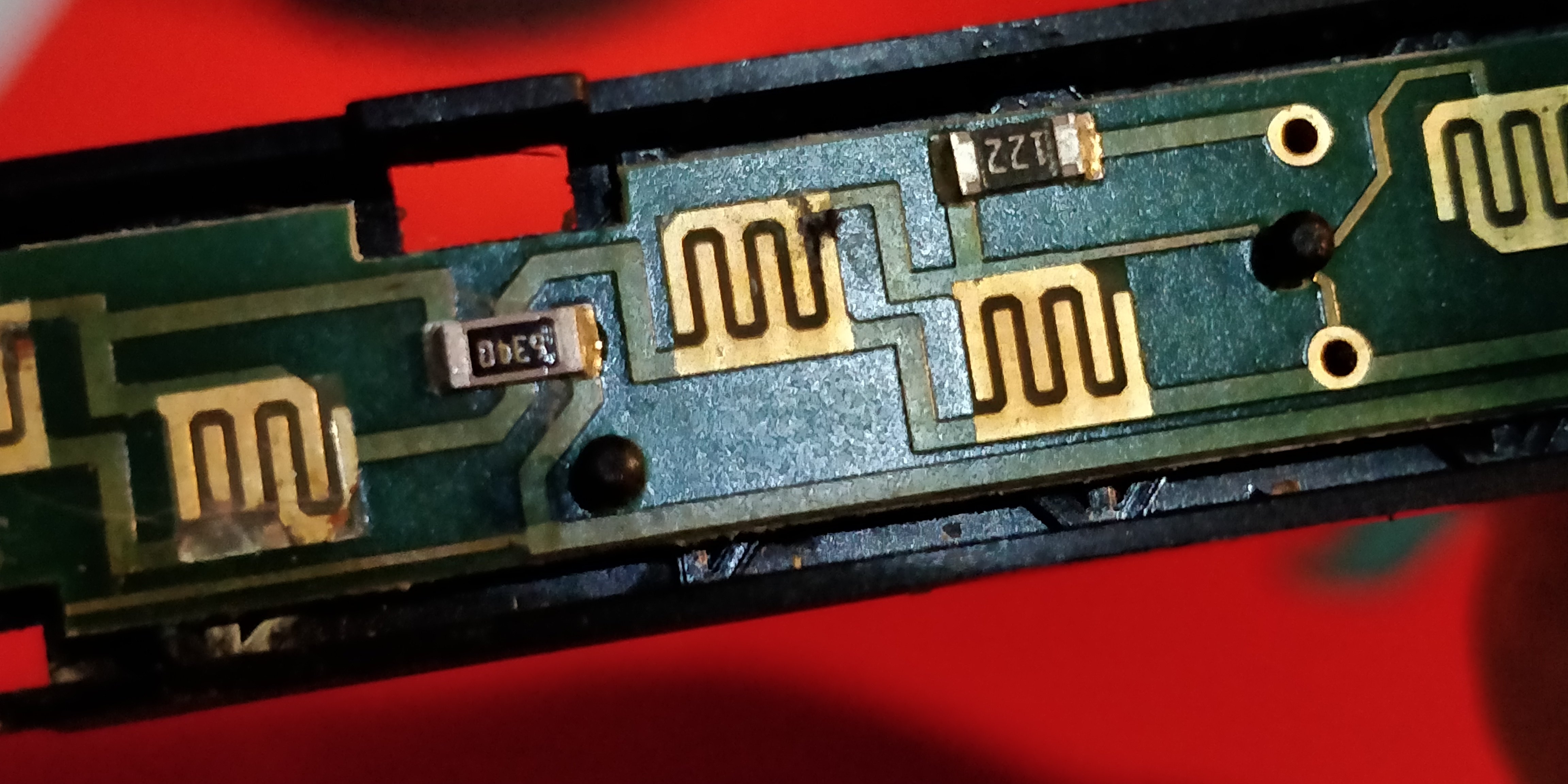

I got it out, and I think it will be hard to repair. IMG_20181114_213853.thumb.jpg.bbb254ec809742440a57b36ef4f53647.jpg
Another thing I have noted is at the end adjustments it feels like the seat pulls more on one side, just a little. Feels like a nut is loose? I don't know how it's build but that's my first thought.
If the contact tracks on the PCB don't clean up well and there are breaks in the tracks, you could try silver conductive paint to bridge the damaged areas, it's the stuff used to make repairs to PCBs and other things such as rear window demist elements.
If the damaged area is not on the actual contact fingers you could also try a solder bridge with fine wire.
If all else fails you could buy a replacement although I'm not sure they are available as single components, you'll probably need to buy the whole module, there's always the scrappy as an option.

Perhaps the contamination has gone deeper into the seat movement buttons, further disassembly required.
A common culprit would be snow not removed from around the top of the driver's door, as the door is opened the snow falls directly onto the control module and melts finding its way inside.
