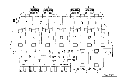

The passenger seat of my 1.9TDC H&K octavia has stopped working and I've checked the continuity of the seat element and the dashboard switches and all seems OK. However I'm having trouble locating the seat relays.
I've attached an outline drawing of the relay housing which shows the seat relays are in positions 5 & 6.
Can anyone held with ID the location, please?

There was a module under the passenger (near side) seat of my Mk2 octavia. This had failed.  From memory this caused both heated seats to fail but worth checking.
