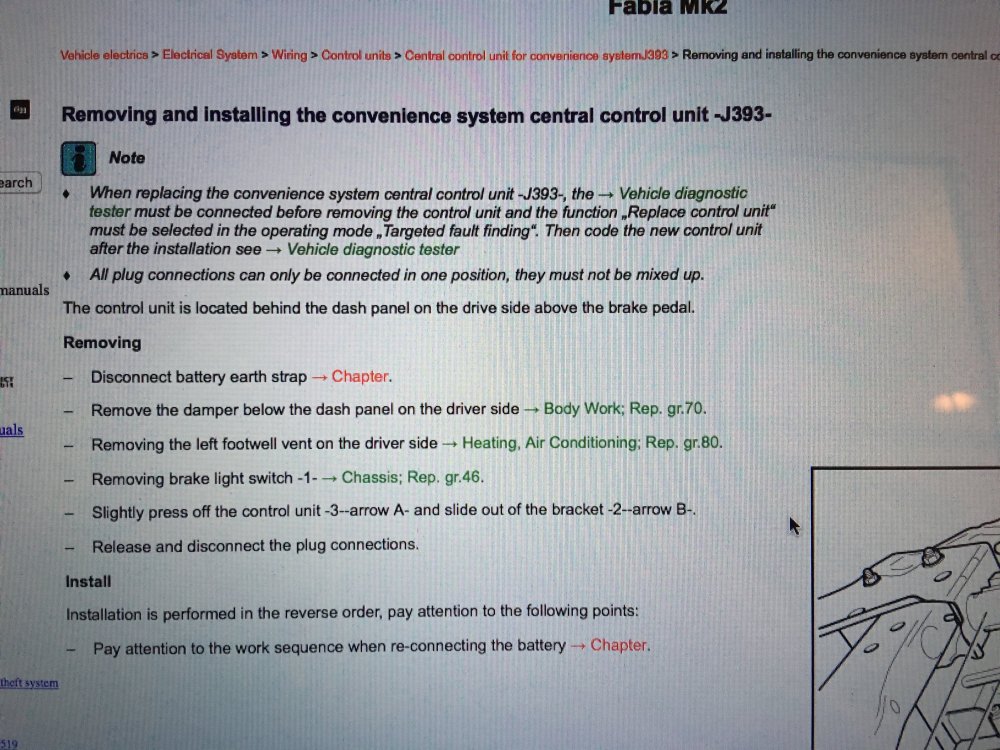

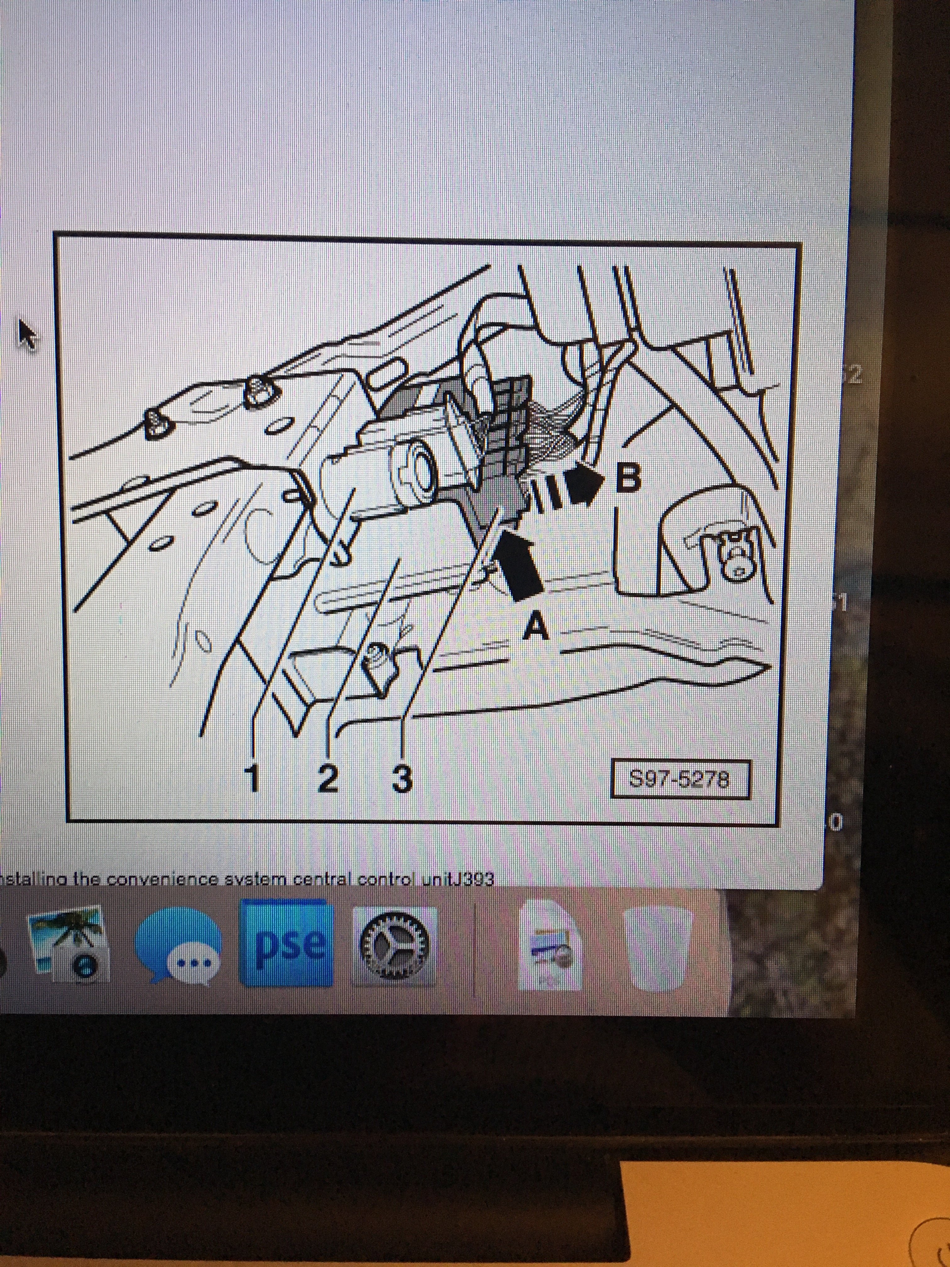

location of central control unit for convenience system on fabia mk 2
I have the old chestnut of electric windows and central locking playing up.
Best info is that a control unit is full of water.
Where is it on my 09 mk2 1.6 petrol estate and what are the problems of accessing it, removing it and drying out before replacing
thanks
tony
Hello Tony :hi:
Hopefully these will help:
Gaz
