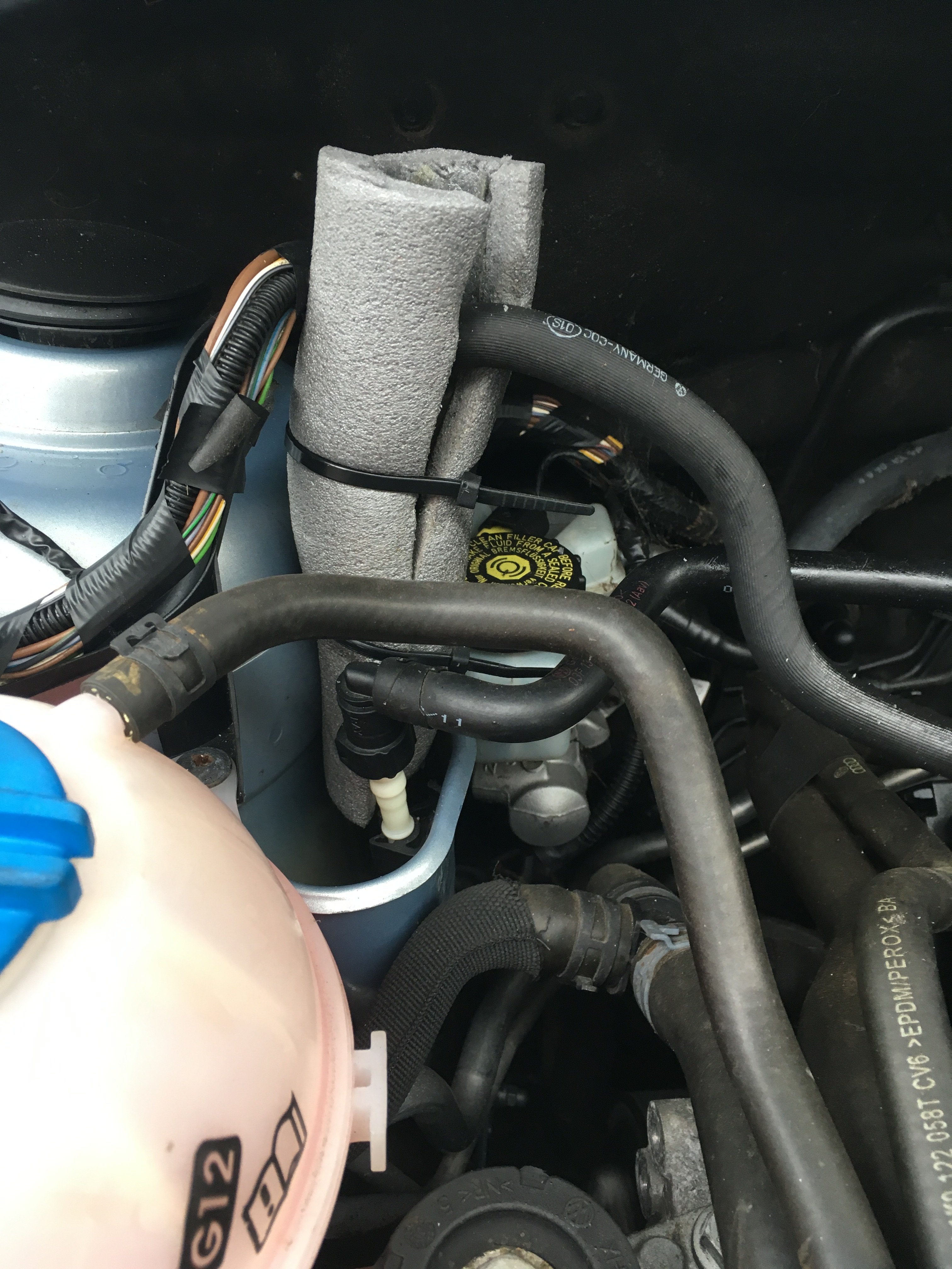

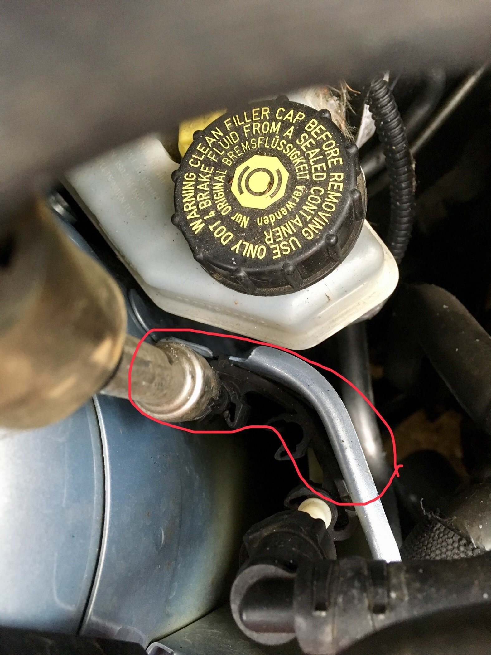

Some progress.  The knocking at 650 revs when idling is definitely in the area as per the referenced threads above and as highlighted in the first photo.  In front of the drivers side (UK) at the top of the engine.
That bracket has some play in it.  If you push the pipe fitting down towards the floor and hold it there, the bracket moves down and there is no noise.
Pull the pipe up and let go, the bracket moves and a rattle occurs when idling at 650 revs.
So my hooky fix for now is to dampen the sound as best I can with some pipe insulation.
Whilst this works, I fear only for a short while until the pipe and bracket work their way upwards again.
On the outer side of the bracket there are notches where it attaches to the body to hold it in place.  I'm wondering if something like some Sugru might set and hold it firm?  Suppose this depends whether is 'both' the bracket and pipe or just one of them that is the cause?
If anyone has any thoughts on this or suggestions it would be appreciated.
On a positive note, at least this is only a rattle and seemingly nothing too serious.
