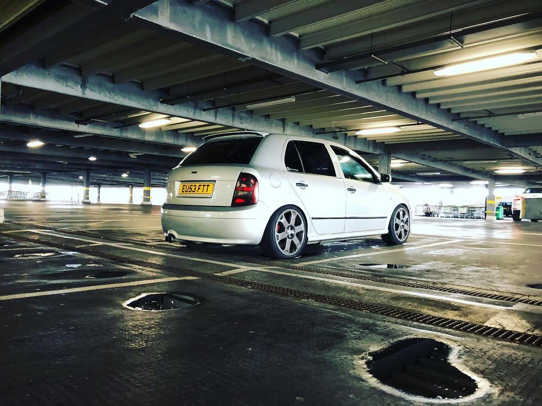

I'm running S3 wheels 17" 205/40/17 straight fit if you can find them?
