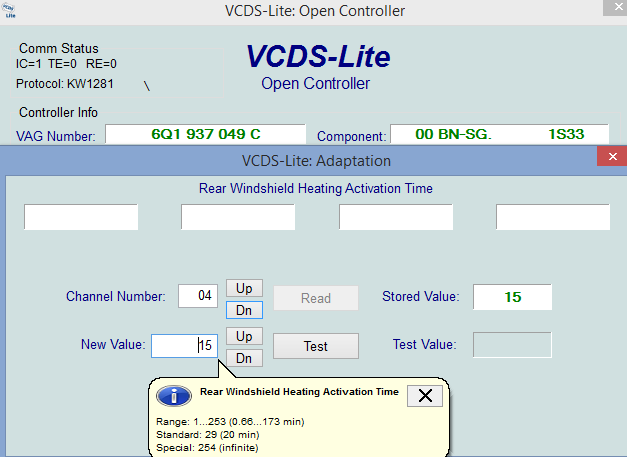

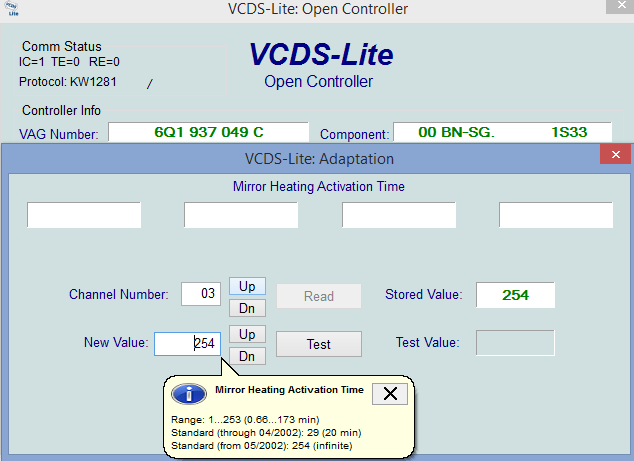

I faintly remember seeing options in VCDS for how the mirror heating works, but I may be thinking of something else.
Anyone know if you can adjust functionality so that it does just come on for a set time from start-up, or only on with HRW?
I can look myself at some point, but don't have the laptop with me today.

Anyway, I was right, on my Polo 9N you can alter the times that the mirror heating and HRW function for before automatically switching off; adaptations within module 09 central electrics:
Did a little tweaking myself while I was in there, wasn't keen on either of the standard settings. :)
