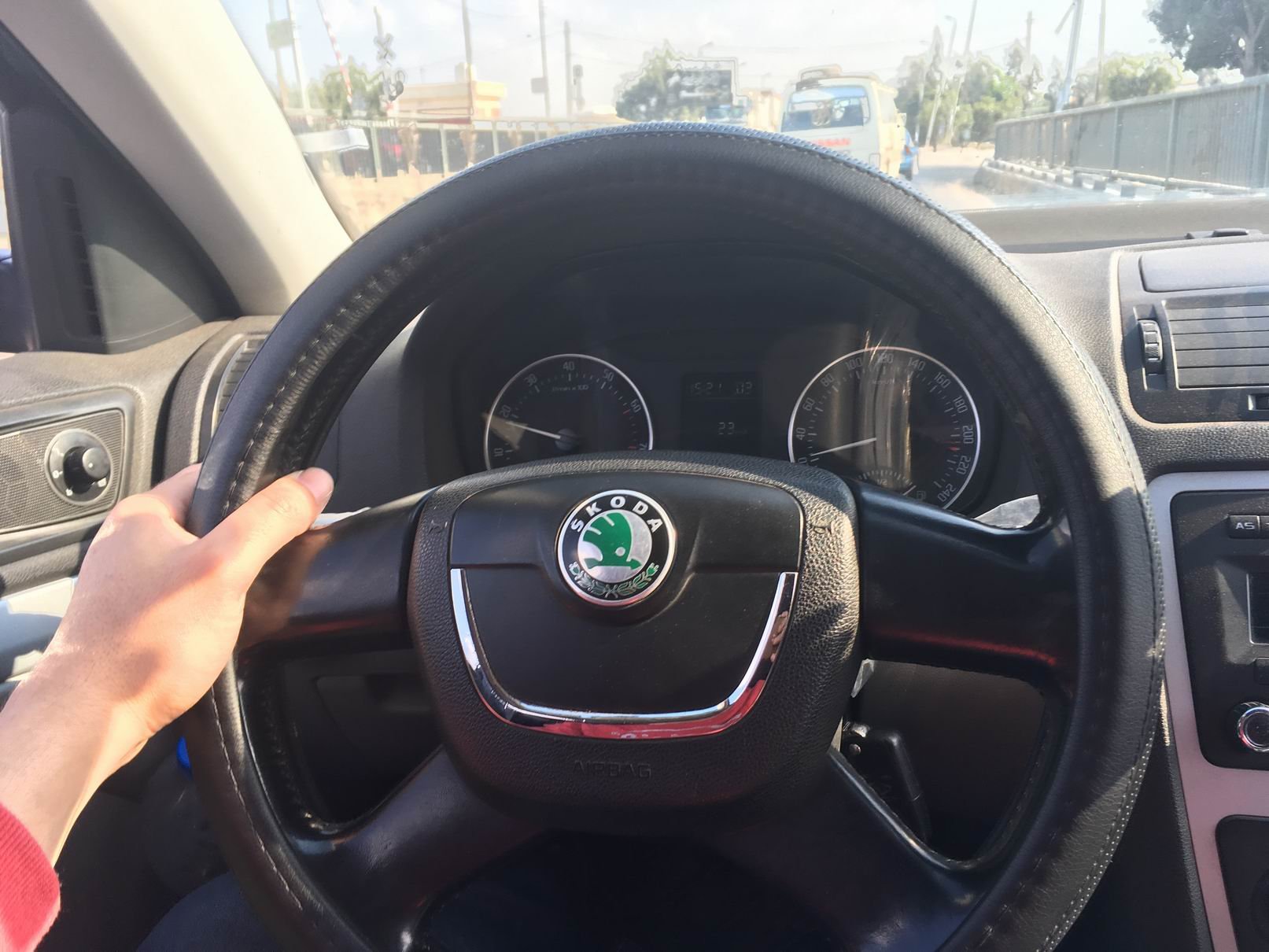

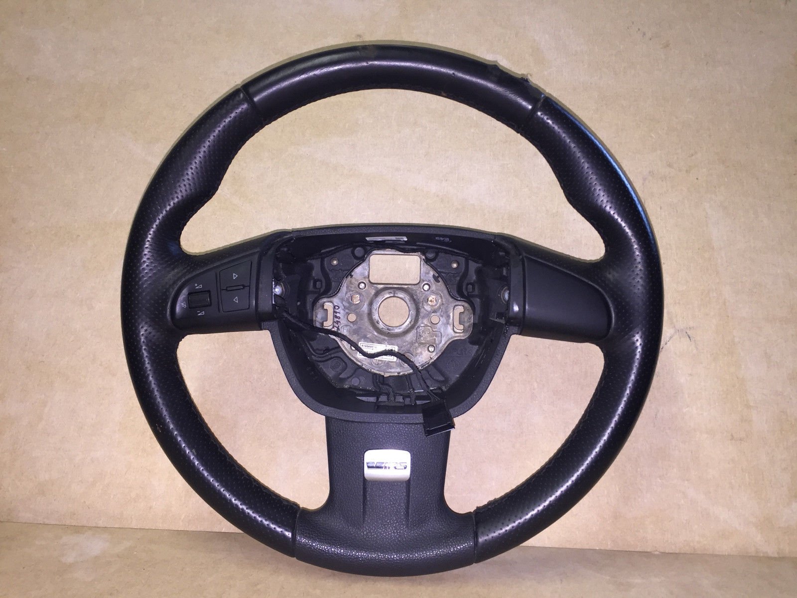

I have 2009 mk2 octavia with 4 spoke basic steering wheel, attached 1. I would like to install the VRS upgrade (3 spoke) with a multifunction option, attached 2. I wanna make sure that the 1K0953549CH steering column control will support this option, attached 3. Please note that the new steering wheel has the multifunction and shifting pedals options.

That MFSW looks to be from a Fabia as it only has buttons on one side.
I've no idea if the Fabia buttons are compatible with an Octavia.
CH controller is good for MFSW, as I understand it.  @Eddie-NL can confirm :)
Ok, but how about the steering wheel. It's been taken from Fabia and I am gonna out it in Octavia 2.
