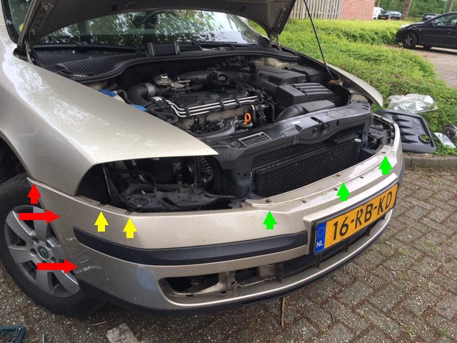

I had to remove the front bumper while replacing my AC condenser. While doing so, I made a write-up of this process: https://www.skodaforum.nl/forum/i/o2-airco-condensor-vervangen.33273
Most important parts for you:
- Bumper is held by 3 screws on each side from the wheel side. You have to remove the wheel (well, no have to, but I recommend it so you have some space to work). There are 3 screws on each side: 2 holding the bumper sideways and 1 screw is located directing upwards.  Those screws can be a PITA since mine were full of dirt/rust. 2 screws are pretty self-explaining, the third one is actually 'at the end piece' of the bumper, pointing upwards.
- There are screws on the bottom
- There are a few on the top, also behind the headlights. So remove the headlights first (and the fog lights if you have them).
Attached an image of my car with the 3 screw locations (Not exactly, can't remember them exact, but this is roughly the place. As you see, 1 screw is directed upwards)
The yellow arrows are the location below the headlights. The greens are the other screws.
Edited by DJSmiley
Thanks for the picture! Looks like it's the same. I solved my problem without removing the front though :) That picture should be stickied!
