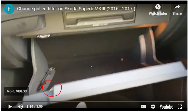

Hi. Thanks. But this is not the latch that has failed. the latch in question is the pair of lock latches that protrude from  each side of the door/lid and engage with wee holes in the door/lid frame when closed. I have circled one in a still from the video you posted:
Basically, when pushed back into the door, they don't re-extend properly.
Cheers,
iperry
The part you circle is it the correct position?
Your car is a RHD and the video is a LHD car. Seem the position you circled is near the push button; not at the place where the cover is not flush.
There is an identical latch on the other side of the glovebox lid. It fails to extend at all once pushed inside.
Neither side work well though, that's why sometimes the lid won't stay closed at all.
