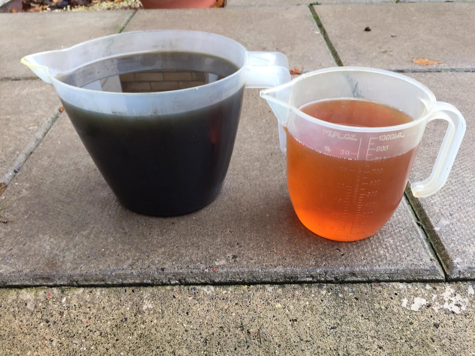

Hi guys, I have an update.
I had a quick look at my gearbox Thursday night and learned that it is the type without a level plug, so there was no way I was going to persuade the dealer to spot check the oil level ahead of my long trip next week. So, yesterday, for my own peace of mind, I took matters into my own hands and dropped the oil into a couple of measuring jugs.
The quantity that came out was just under 2.3L, so absolutely spot on there. What was less reassuring was the very dark colour and thin consistency. Based purely on experience and gut feeling, I decided to change the gear oil in this brand new car (bonkers, I know, but I'd done the hard part already)! I purchased 3 bottles of Febi 21829, which is a 75W synthetic oil meeting API GL4 and (crucially)  VW G052171A2. To wit, it should be the right medicine for this particular 'box. I bought it direct from Amazon and it came today. It looks nothing like the factory fill (see photo attached) and feels very slightly thicker, notwithstanding the effects of temperature difference between my garage and the delivery van (it's still pretty thin for a gear oil).
After refilling, I've driven about 25 miles today and, touch wood, I haven't felt that crashing sensation when going into 2nd a single time. Synchro seems to be performing normally as per everything else I've driven over the last 20-odd years. I'll see how it goes!
