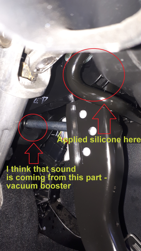

Maybe somebody can help to identify what and where is this sound coming from? The squeaky noise is produced when pushing and releasing break pedal. Could it be somewhat mechanical fault that some connection part needs to be lubricate or maybe it is break vacuum booster?!

Thanks for advice! But what do you mean by "the brake pedal box". I tried already  a lot of silicone as well as WD40 on various parts, but no luck...

Possibly coming from the seal where the pushrod enters the servo? It looks like there's a dust boot preventing you from getting at it with the silicone spray.

Thanks! Yes suppose that the noise is coming from there. Do you know is it possible somehow to remove a dust boot to spray silicone there and then to put back?

If it were me, I would try to get a can of silicone with a straw and squeeze it inside next to the pushrod. There might be a clip, which you would need to remove first.

No success. Noise still there...

Already tried WD40, silicon, Wurth HHS-2000 - no change!

Total disaster... Dealer changed brake servo part No 5Q1614106K, but the squeaky sound is still there! Dealer is shrugging his shoulders...
