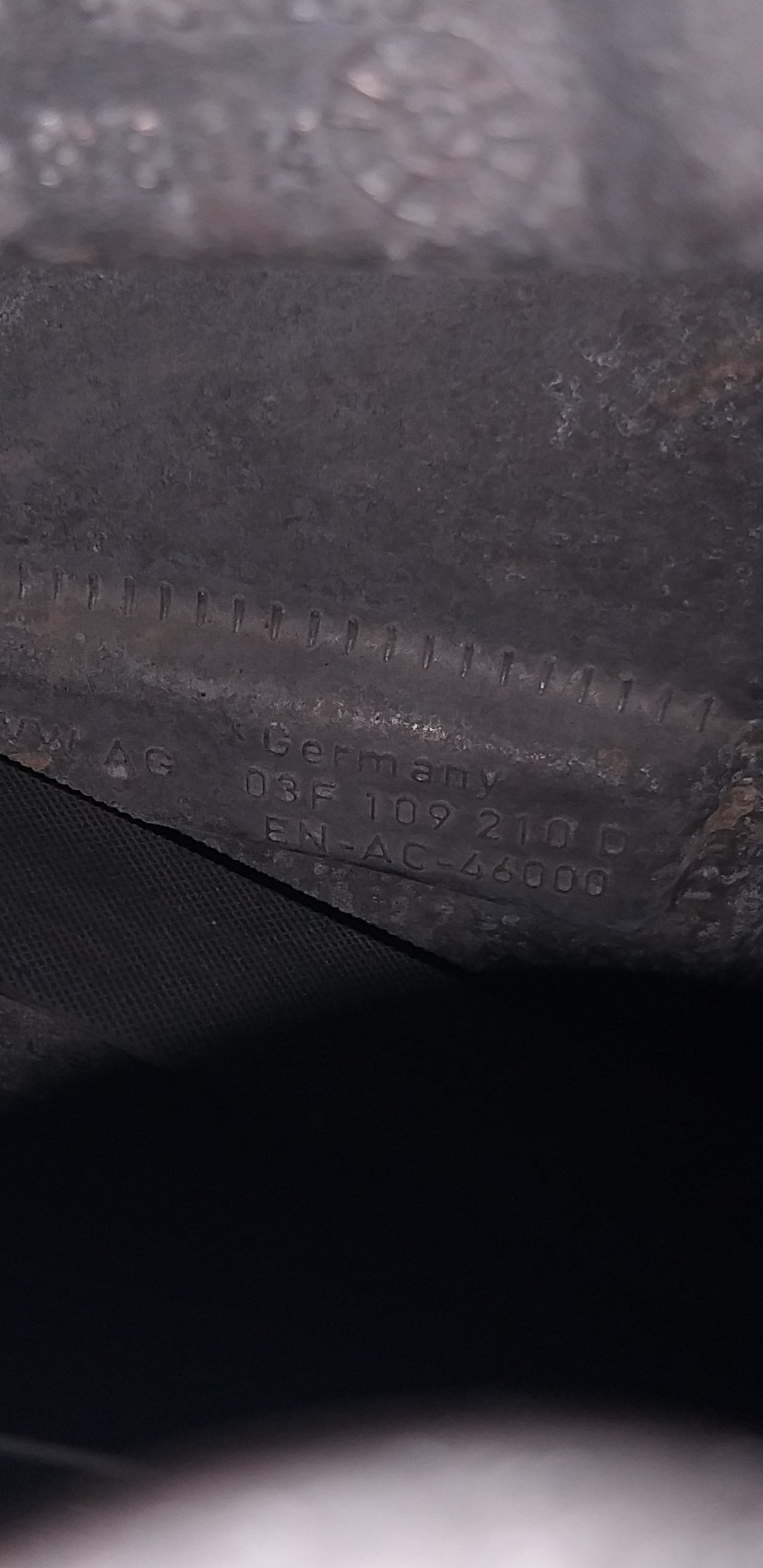

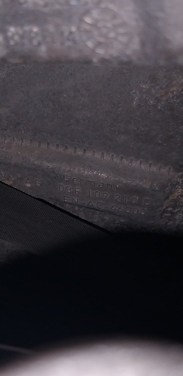

It is a Monte carlo 2012, built in october 2012..
The only thing i could find is a code on the timing chain cover 03f 109 210 d
Also I have the vin number, it says
TMBEN25J5D3050224
What do you think please ?
