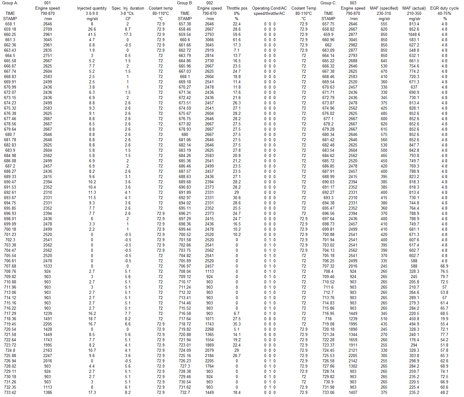

Yeah I’m lazy, the thing was I have literally only being doing about 2 miles a day for the last 6 months. Do you know if it is possible to check the ect using VCDS to confirm it is the issue? I have a week off coming up so am happy to replace the ect or maf or hoses or whatever the issue is if it resolves it, but I’d like to confirm the fault first if possible.
I have taken a reading of the ETS/CTS and the MAF this morning on the way to work, my feeling is the MAF looks more out of whack than the CTS but I don't really understand the logs fully.
This was a sample of a section of the logs taken after around 3 miles when the the dash  was showing the  temp at 90, so engine should have been warm(ish)
OK, will someone who actually knows please state what units the time stamps are in?
Looking at the full logs they start at 0.7 and go up in increments of around 1, I would assume that they are seconds since the logging began. In this case I started logging when I started the vehicle, so I would assume around 11 minutes.
Was anyone able to shed any light on this for me? The time stamp is in second increments.
i can run another log of any VCDS blocks that may help. I don’t know what the coolant temperature sensor should read, although 72.9 looked a little low. The MAF looked quite a bit out, but on other runs looked better.
The other her thing I have noticed is that when going up hill under load the tone of the engine changes, it becomes slightly more rumbled/throaty/guttural for a few seconds at around 1800rpm.
If anyone is able to help shed light on what I need to test or could let me know the temp of their vrs cts sensor that’d be ace
Well, if the time stamp are in seconds, the engine might not be fully up to temperature, regardless of what the lying instrument on the fascia says. If they were later, or the car were a petrol, I'd be suspecting the thermostat was stuck fully open because ~90C is a more typical hot temperature.
