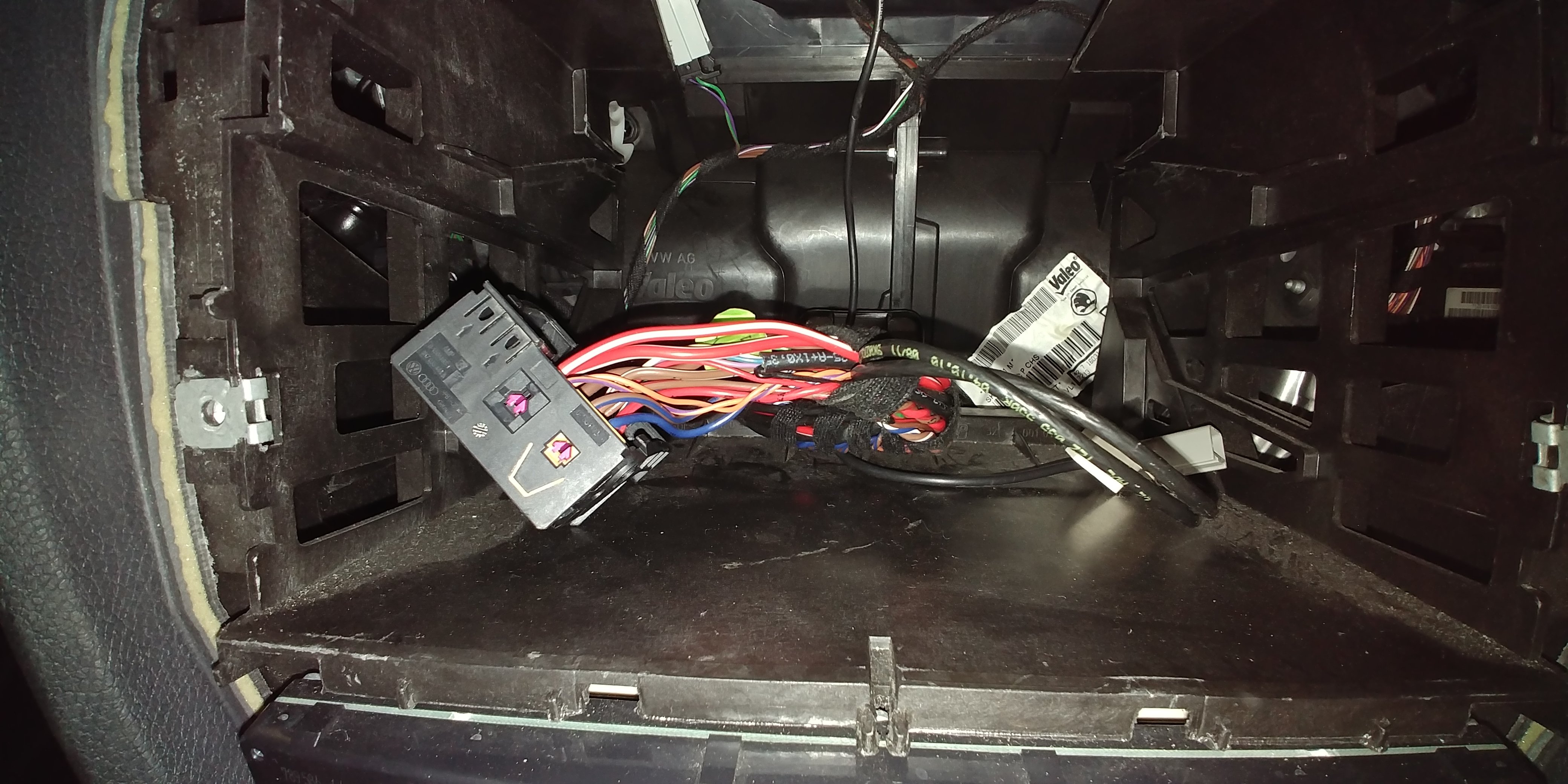

20181117_194905.thumb.jpg.839937d6c2f4b6460e203010eb4e8e3f.jpgOk so my scout has an audience "fitted"  using the term very loosely as the ariel is a different connector, its not coded and the surround was wrong.  But I need ro know what should i be loo I ing at to replace it?  I have arm rest so have the aux in and looking at the pictures of units on ebay the aerial connector seems right but how do i know if the car would have had telephone prep etc?
Pics of the cables and connectors included

Ok from the bottom pic I get that the GPS OR Phone bits could go into the gap next to the blue plug and that the double circle is aerial? but what on earth is the plug in the second, wait scrap that third pic as just realised it inserted an extra picture at the start??????

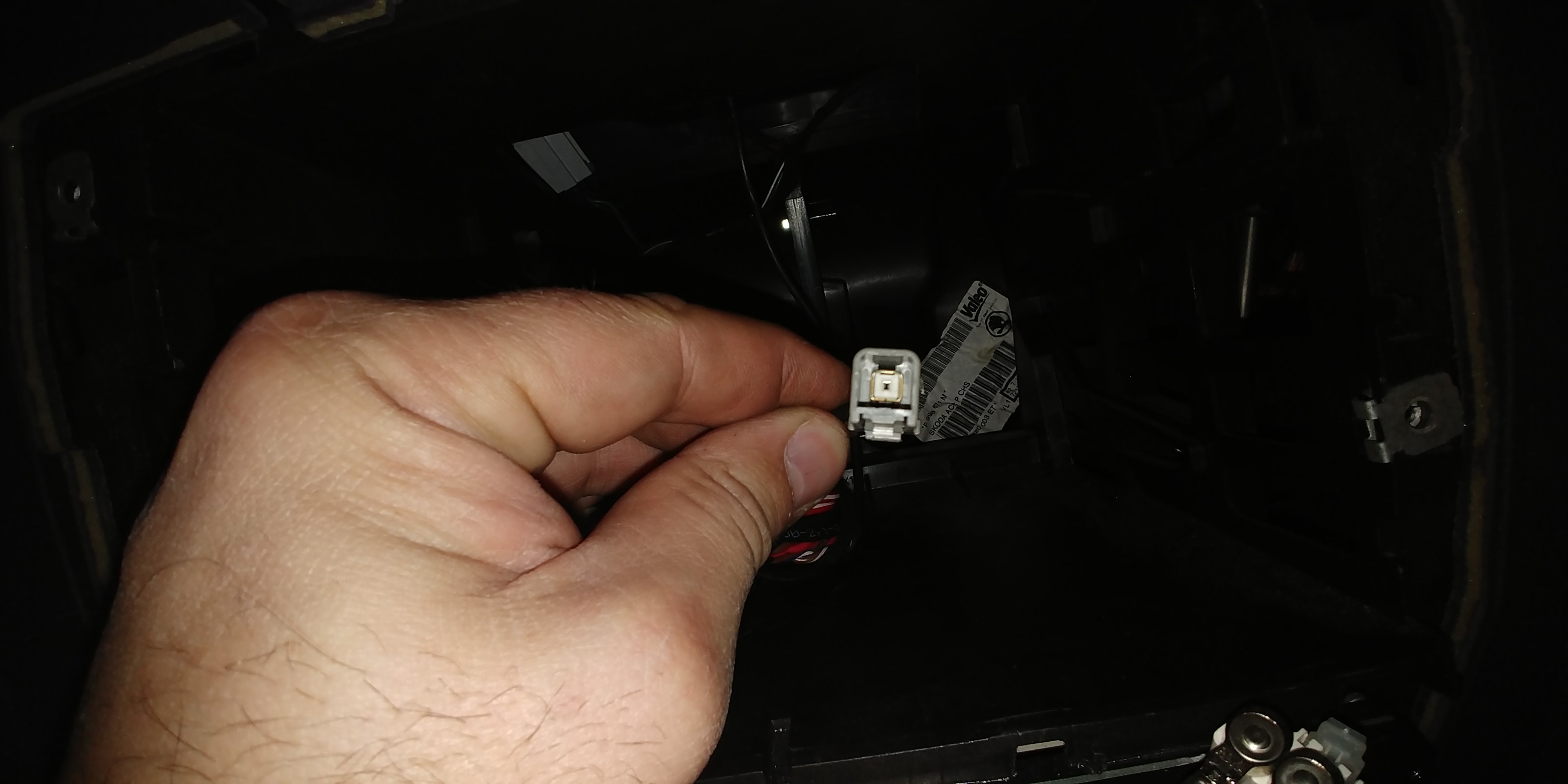

No idea what the grey looking connector is.

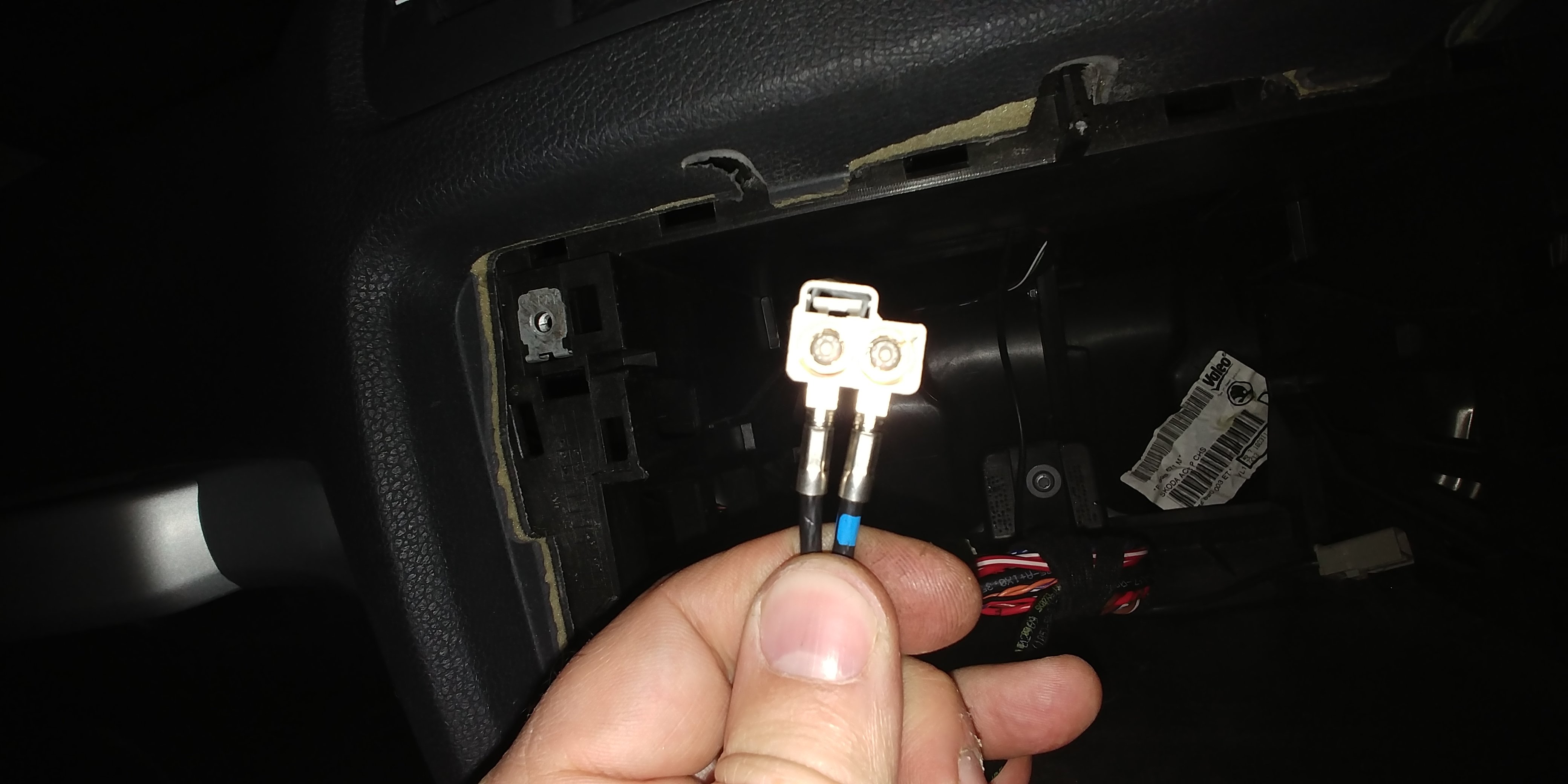

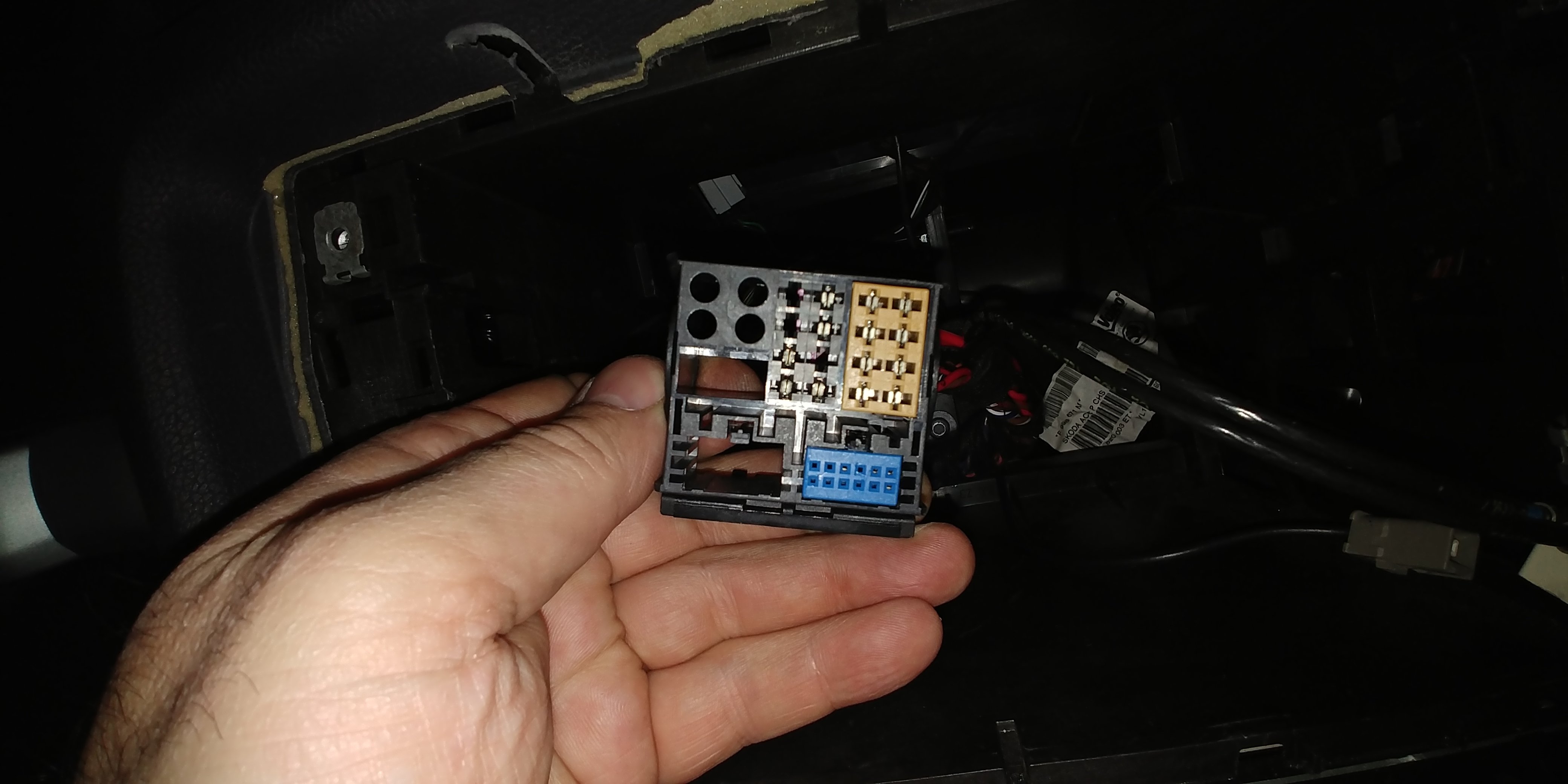

Other than that, you have a quadlock and the AM/FM double fakra. I would expect any Bolero from a MK2 Octavia to be fine.
As for BT, it would need a separate module. Based on the quadlock, the wiring isn't there so you haven't got phone prep. I think the blue connector in the quadlock will be the aux in from the armrest.
20181117_194845.thumb.jpg.6fecbf8cc3e8ff7ebfe2ad9dddd33887.jpg.d359d4ca2420c2ab5791d3273b2bef2a.jpg
I Guess that the empty bit next to the blue plug would be for phone bits?

Ariel but is this DAB too?

I have no clue what this cable is for even after searching google images for anything GPS radio phone related???

does the bluetooth module come with the cable? as the ones I have looked at VAG on ebay seem to be just a module
Depends if you buy just the module or as a kit with a wiring loom and mic. You can also buy the wiring separately like this: https://www.ebay.co.uk/itm/292629647324

still be nice to know what that extra cable is for?
At a guess, it'll be an aftermarket GPS receiver for whatever headunit had been fitted as it looks similar to this: https://www.ebay.co.uk/itm/152879713972
I doubt it'll go very far so it might be worth following it so it can be removed.
