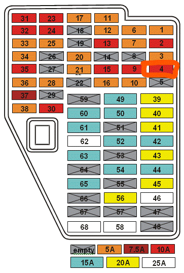

Have you checked the fuse?
You want fuse number 4 (10 amp).
Edited by TMB
