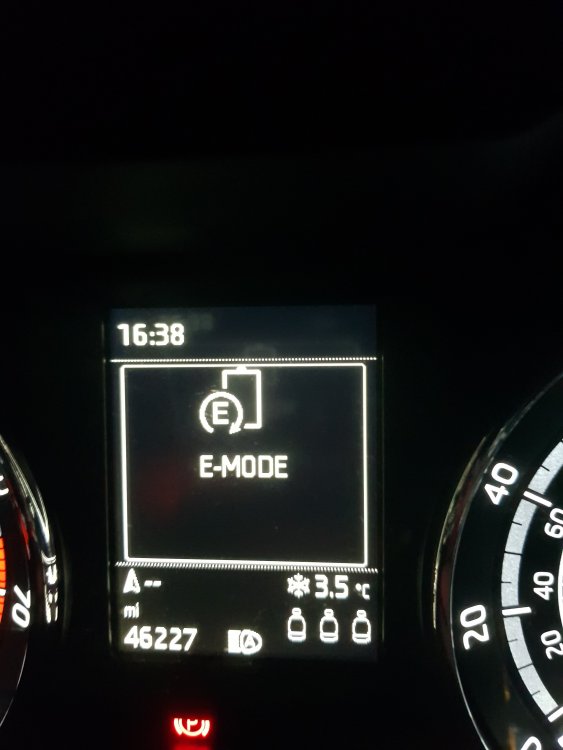

So, I thought it looked interesting so enabled it, not actually knowing it's purpose..
What I get is this message every time I start the car. I cannot view it after startup as it disappears, and I cannot find anything at all on the MaxiDot or infotainment system that relates to this at all.
What is it? Please and thank you :)
Edited by FluffyEyeball
This happened on mine too when I tried to code it in, no idea what it is or does and I could never get the drive mode to show on my Maxidot. If anyone knows how to, that’d be pretty cool :)
Battery and E symbol would suggest 'energy recovery mode'.  Under light engine loads the alternator free wheels, so the battery only gets a proper charge under braking.
If firmware doesn't support a function, you get strange results.
Ahh that makes sense, thanks Moggy!
I don't mind strange results, so long as I know what they mean! I'll keep it for a while and see if it ever says anything different.
Mine never did, just said E-Mode every time it was turned on.

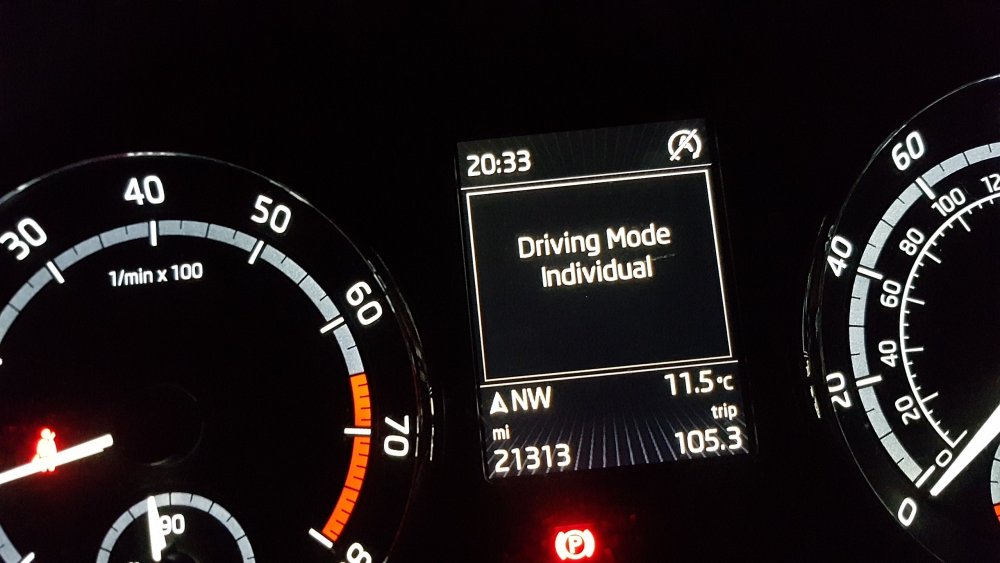

This worked on my MY2016 and is a useful function (don't know why it's not standard?)
Drive Profile Display in Cluster
Select Control unit 19
Control unit long coding
Go to Byte 08 "Display for drive program functions in instrument cluster"
Enable Bit 4
It only displays the drive mode in MFD for a few seconds each time after you change mode using vRS button. First press of button displays current mode.

jagdad yeah that was the coding I used, and expected what you've got. Must be because mines older than MY2016. Thanks anyway :)
That’s the same coding I have used and I get the E Mode thingy. Must be an MY16 change as mine is MY14 with the grey Maxidot menu. I hate that I can’t change it to black without removing the vRS start screen. I wonder if there is a firmware change on the MY16 clusters that makes them different?

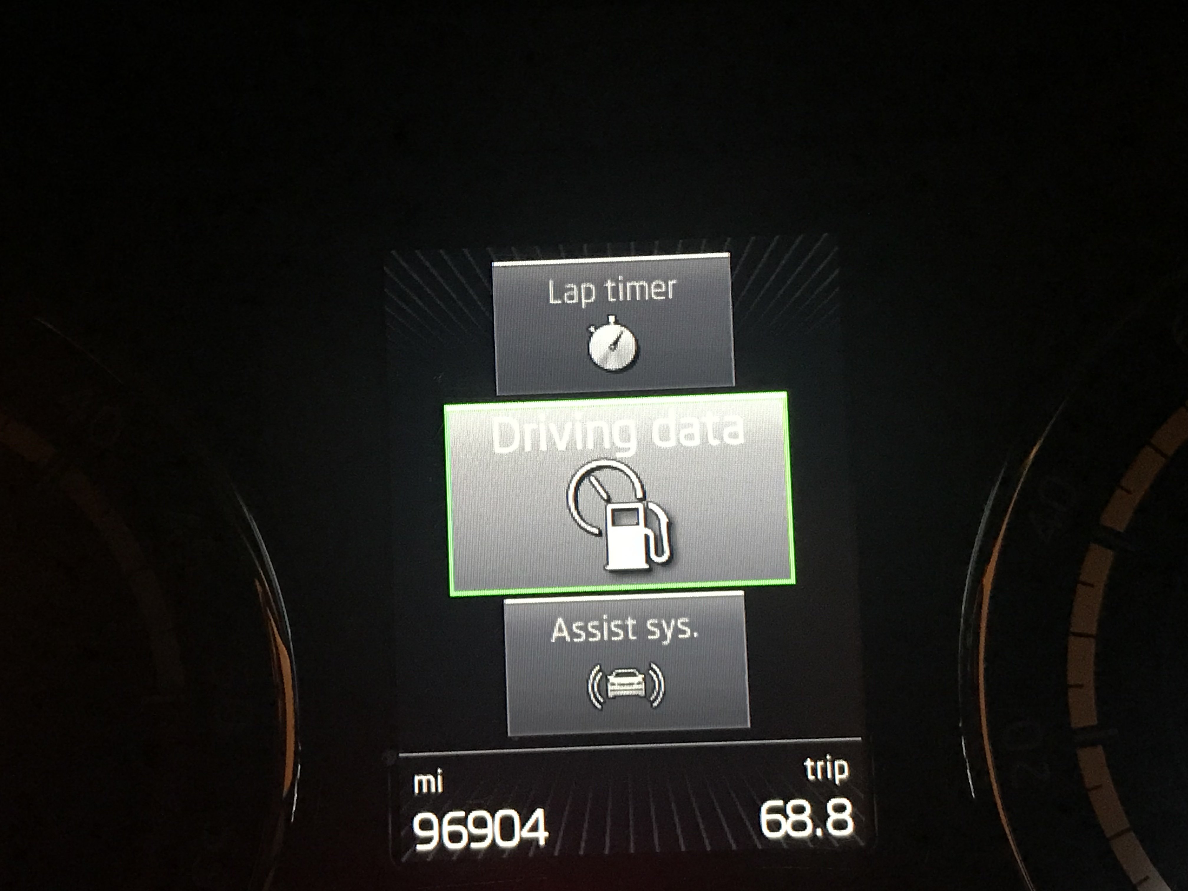

No it’s a colour Maxidot, but on the MY16 models the menu (audio, driving data, nav etc) has black boxes with green and white text over a black background whereas mine has grey menu boxes with green and white text over a black background. I’m not being very clear here. I’ll have to try and take a picture of what I mean tomorrow.
I’ve just tried this again and still with the E Mode thing. The MY16 cluster must be different! This is what my menu looks like.
MY16 has black boxes. I can get 4 options, Skoda logo and grey boxes, Skoda logo and black boxes, vRS logo with grey boxes or Function not available!! I could have black boxes, but I like my vRS start screen. I’d love to get this working if there is any more info on it.

Cluster is too old. Whether you can flash newer firmware I don’t know.
