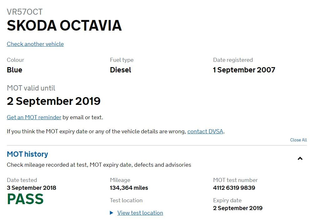

Unfortunately my vRS was one of the unlucky ones (VR57 OCT). Type "PD170 VOSA Recall" into Google for some bedtime reading.

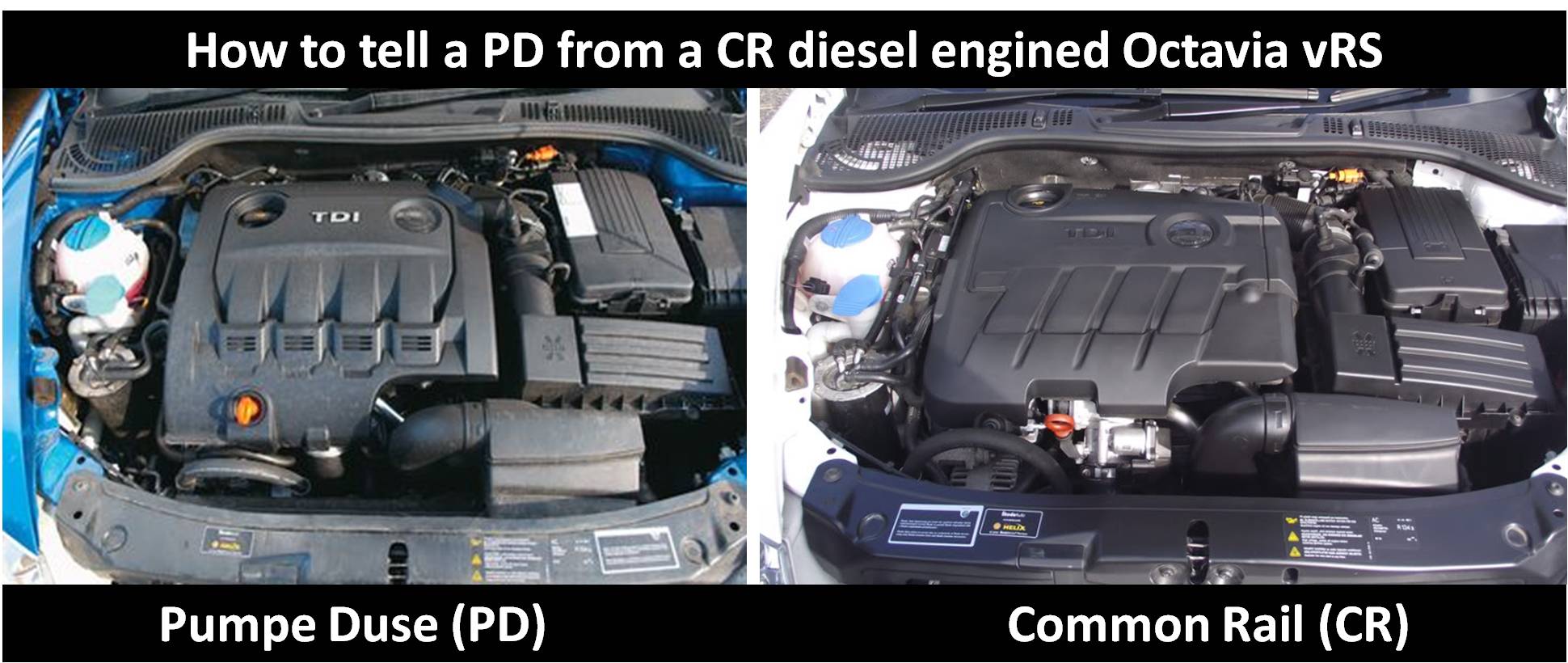

Just one last check. The PD170 was replaced with the CR170 (Common Rail) early in 2008. Just check the car you're off to see isn't a CR and therefore a totally different beast...
Image result for octavia vrs pd vs cr
Jeez, it's still alive. No obvious lasting effects from the dilluted engine oil then.
I wonder how long it cranks before starting these days...
