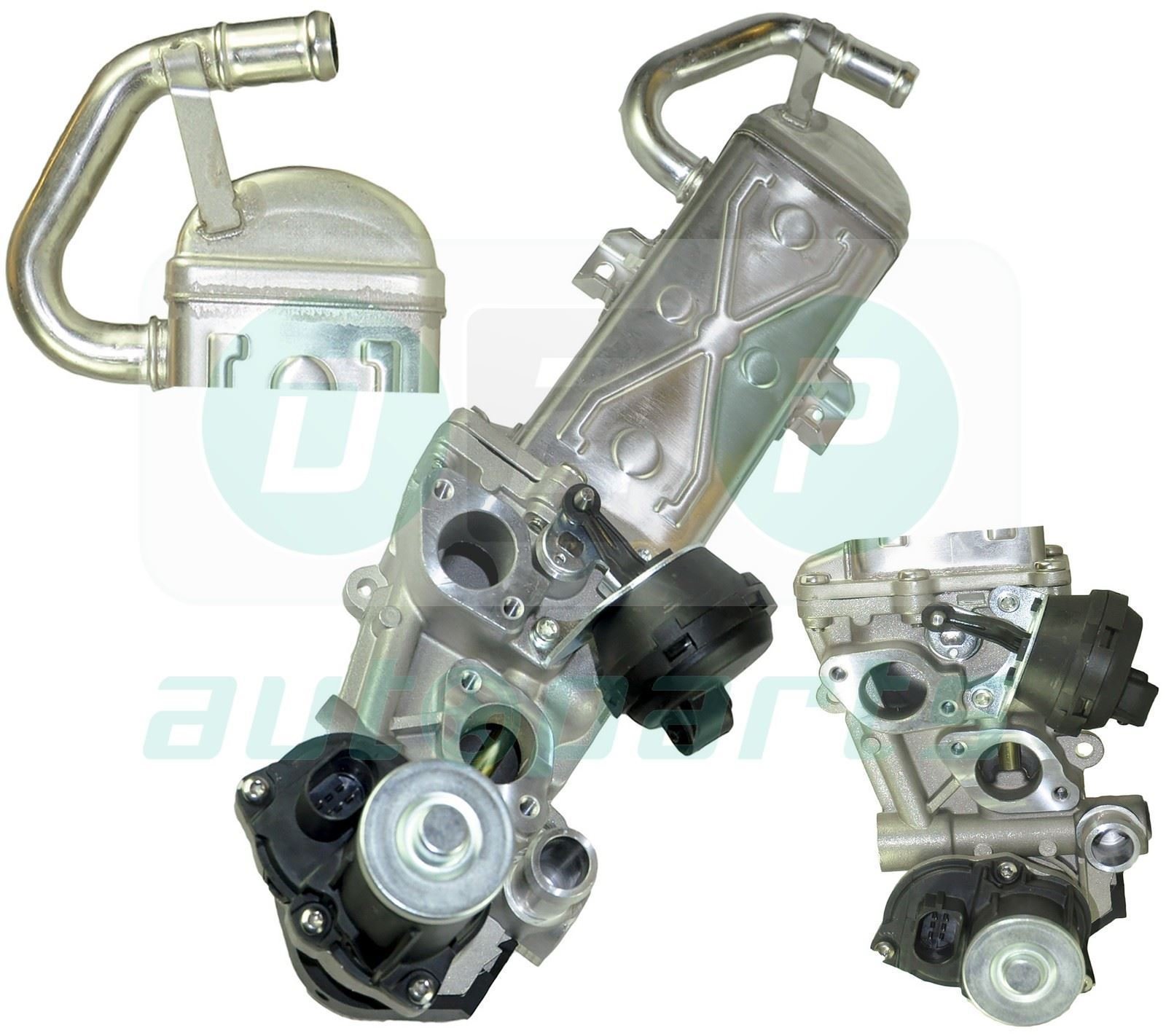

Here's a pic of one so you know what to look for
not quite as easy as a Mondeo
thanks for the pics
