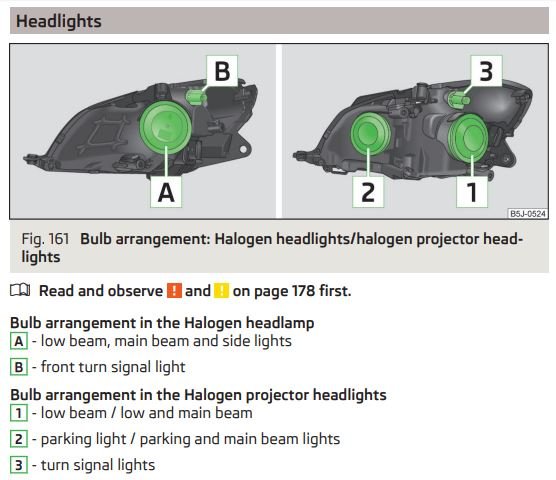

Excuse me but I cannot understand which screw you are talking about. My Roomster has a reflector headlight, meaning it uses one H4 bulb and when replacing it there is no screw, just a metallic security clip and the rubber cover.
Mine is projctor style headlamp. It seems there is 2 screws that holds the holder into place.. I dont actually think they are needed to be undone. Will get a pic later.

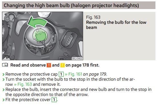

There are no screws to remove, which screw have you removed / lost?

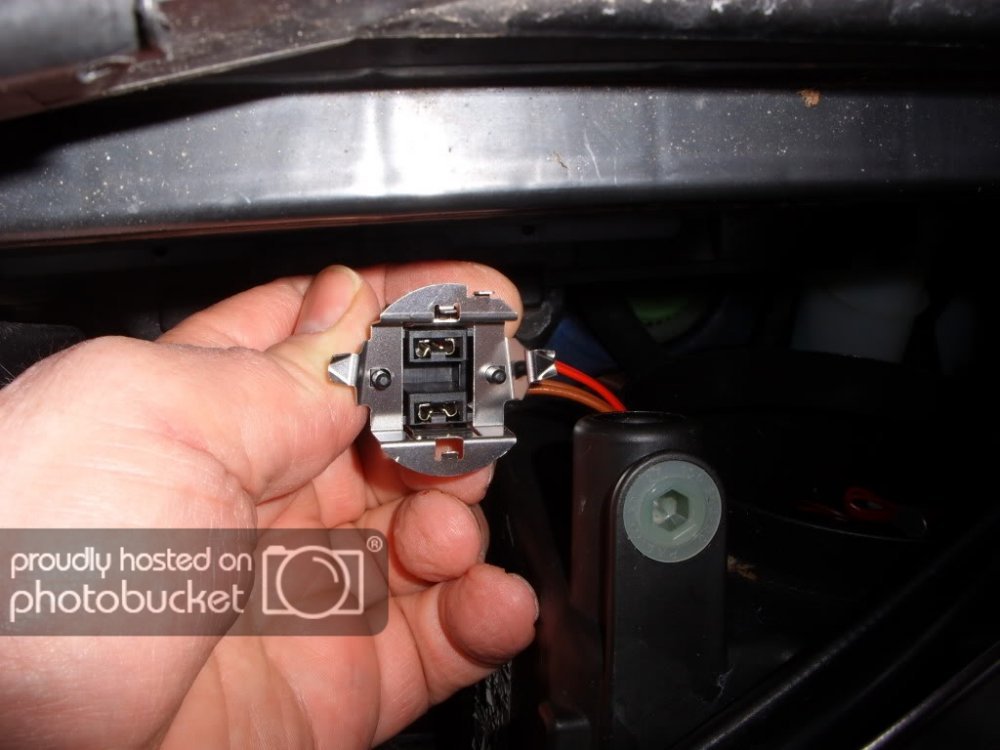

There's a screw that holds the bit that you turn ( with the bulb in).. I later found out that I didn't need to remove that to change the lightbulb :(
This bit?
I think so?
I'm just trying to work out what screw you've removed. I can't seem to see any screws close to the area around the back of the headlight bulb.
Maybe mines different since its the projector style lamps?
