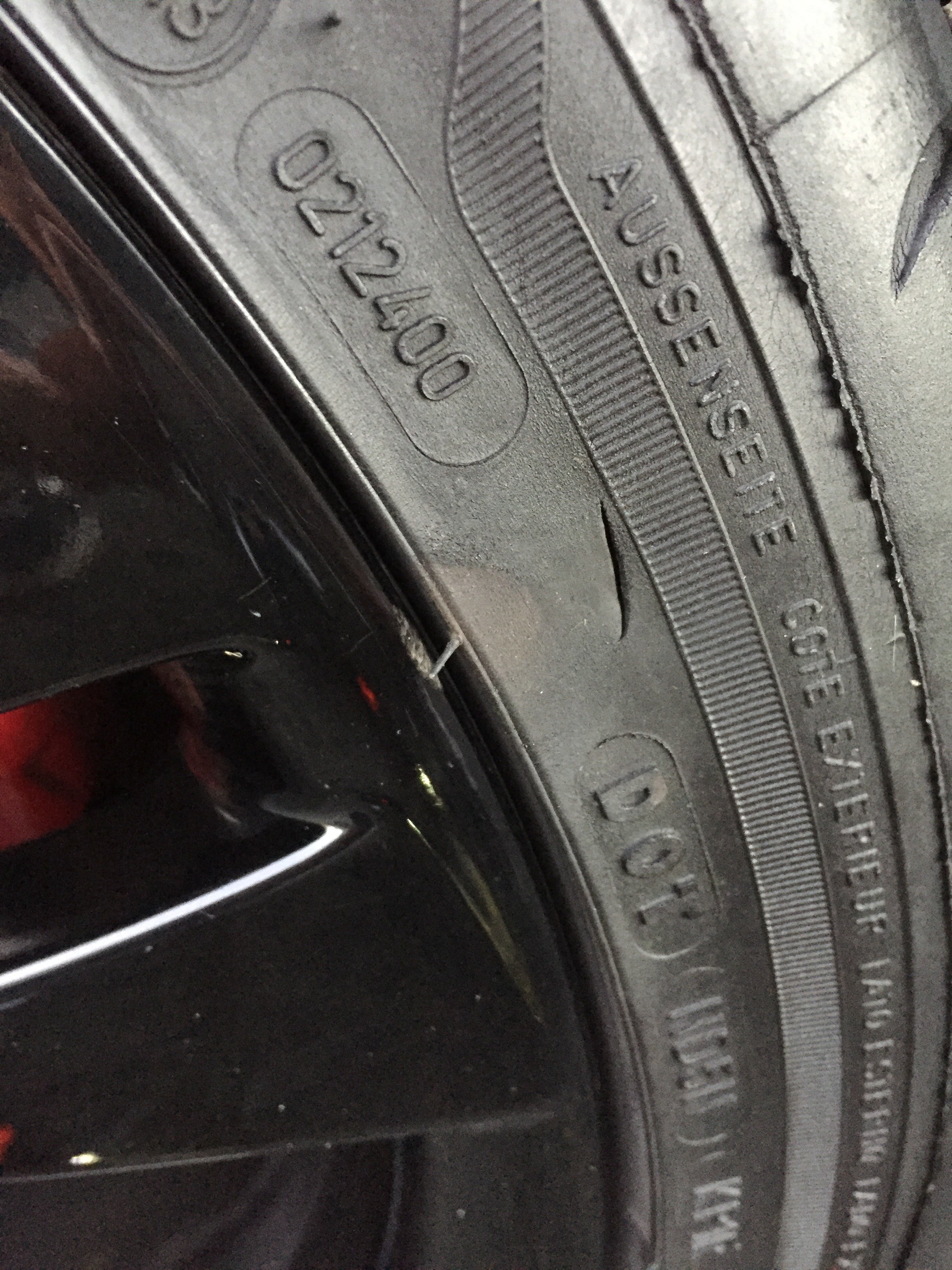

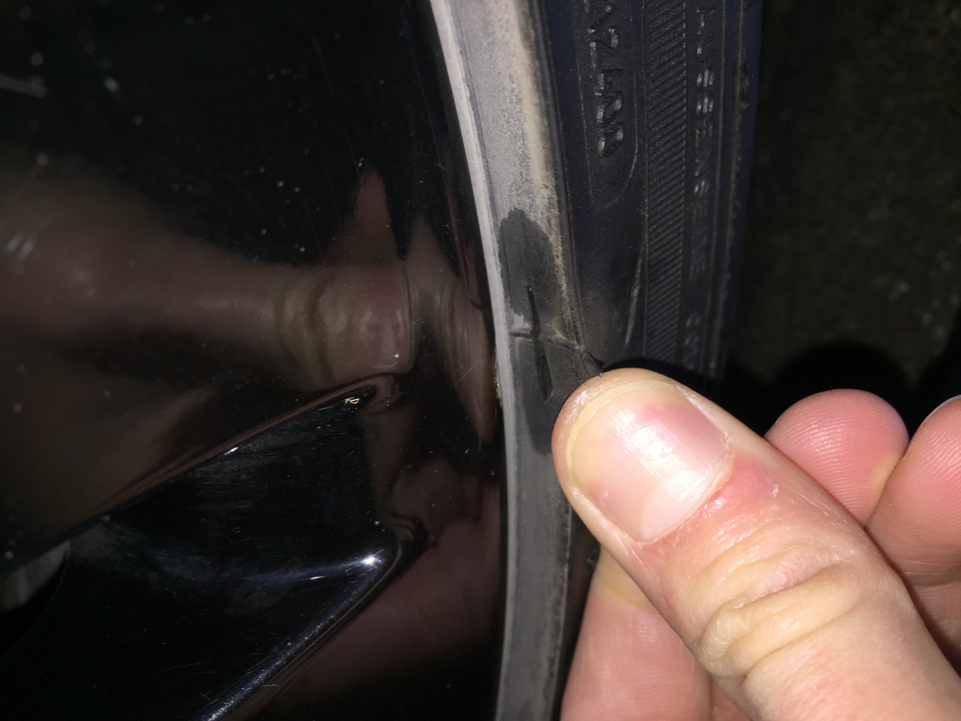

Gave the car a good clean today and whilst applying some tyre shine I noticed what appears to be a puncture in my sidewall on the rear drivers side.
Whatever caused it has penetrated through the thick bit of rubber that forms the rim protector and has chipped the rim.
I can’t tell if this down to road debris or something more sinister (i.e. someone’s poor attempt at taking a knife to my tyre - for reasons unknown to me).
I do recall hitting something in the road a little while back that was unavoidable but didn’t think anything of it. I don’t remember noticeing anything obvious either when I gave the tyres a once over.
Could have been there a while too as it’s been a few weeks since I cleaned the car and probably the first time in a longtime I’ve put tyre shine on.
Being the sidewall I can imagine it will most likely be a new tyre, not what you want just before Christmas although better be safe than sorry.
So what are people’s thoughts on the damage and do you think it’ll need a new tyre?

Don't fanny about it is knackered by the cut, replace it.
Looks like you have cut the rim protector only.
Are there two cuts as the photos look to be of a different place on the tyre?
Can you see cords?  The white stuff.
It is not a knife cut.
I am presuming you have not lost air?

@AGFalco the cut goes straight through at an angle from the sidewall to the rim. I haven’t lost any air nor can I see any cords.
@jong123 I thought It probably would be.
I guess any weak point in the thinnest part of the tyre is going to increase the risk of a blowout.
If it were the rim protector only maybe I could get away with it but it starts about 10-20mm from the edge of the alloy to the side wall.
Will try and get in to a tyre specialist on my lunch break tomorrow, see what they say.
In the mean time i’ll get on Blackcircles and price a pair up!
I would say a new tyre , some thing sharp has gone through the tyre wall pushed through come out by the rim , not good .

You've clipped a kerb or run over something. You can see the damage to the rim of the alloy as well as the thumb shaped marking on the tyre immediately next to the rim damage and right between the rim damage and the slit.
The tyre is still holding air, therefore it isn't punctured.
Stop fretting and carry on.
The cut in the second photo, looks to be just on the rim protector part of the tyre. That looks to be no safety problem. On the first photo however, the cut is in a dangerous place, but just how deep is it? Depends on the depth of the cut, just how dangerous it really is. If in doubt about the cut on the first photo that is in the middle of the sidewall, get a new tyre. Better than a blowout at speed!

The thumb shaped marking may just have been exactly that as a result of me trying to work out the extent of it.
And yes puncture was the wrong word to use as I’m not losing air. Whatever has done it has pierced the sidewall and come out through the rim protector and hit the alloy or vice versa.
I don’t see the need for the flippant “stop fretting and carry on” remark.
The sidewall is the weakest part of the tyre and can not be repaired. If you think a blowout as a result of it is nothing to fret about (which I don’t think I was, I was merely asking an opinion as to the cause of damage and the likelyhood of it needing a change) then that’s your opinion. Personaly though, from a couple of the comments above, I won’t be taking that chance.

The cut in the sidewall extends through and comes out at the rim protector. It’s all one cut as if something has peirced all the way through at an angle.
Because of this it looks like it’s going to be a new tyre. I would have got away with it had it just been the rim protector but as it’s so deep it’s come out through the sidewall I don’t think I’ll risk it.
The split could be from the compression of the tyre against the rim. We don't know that the two slits are even joined.
The tyre is holding air and there isn't any obvious deformation (bulge) to support the theory that the sidewall structure is compromised.
Sure, the tyre might fail, but then it could fail for any number of other reasons, at any time.
You asked for opinions, and mine, flippant or not, was that I'd continue to drive on it as normal. Tyres are designed to, and will take a reasonable amount of wear and tear.

I guess I didn’t make it very clear but yes the two slits are joined.
This is why I’m curious as to what may have caused it and if that it poses an increaced risk to blowout as it does extend to the sidewall.
I'd get a new tyre sooner than later ... far sooner.  If the slits are aligned then it's started to compromise the sidewall to a degree one way or another.
Chances are you have clipped something like a piece of metal lying in the road.

If the cut goes from the rim up then it is from a brush sideways impact on the rim. ( kerb )
As there are no cords showing and no bulges at this point then it is still structurally sound.
If you want some reassurance then get an inspection done on the inside of the tyre as well.

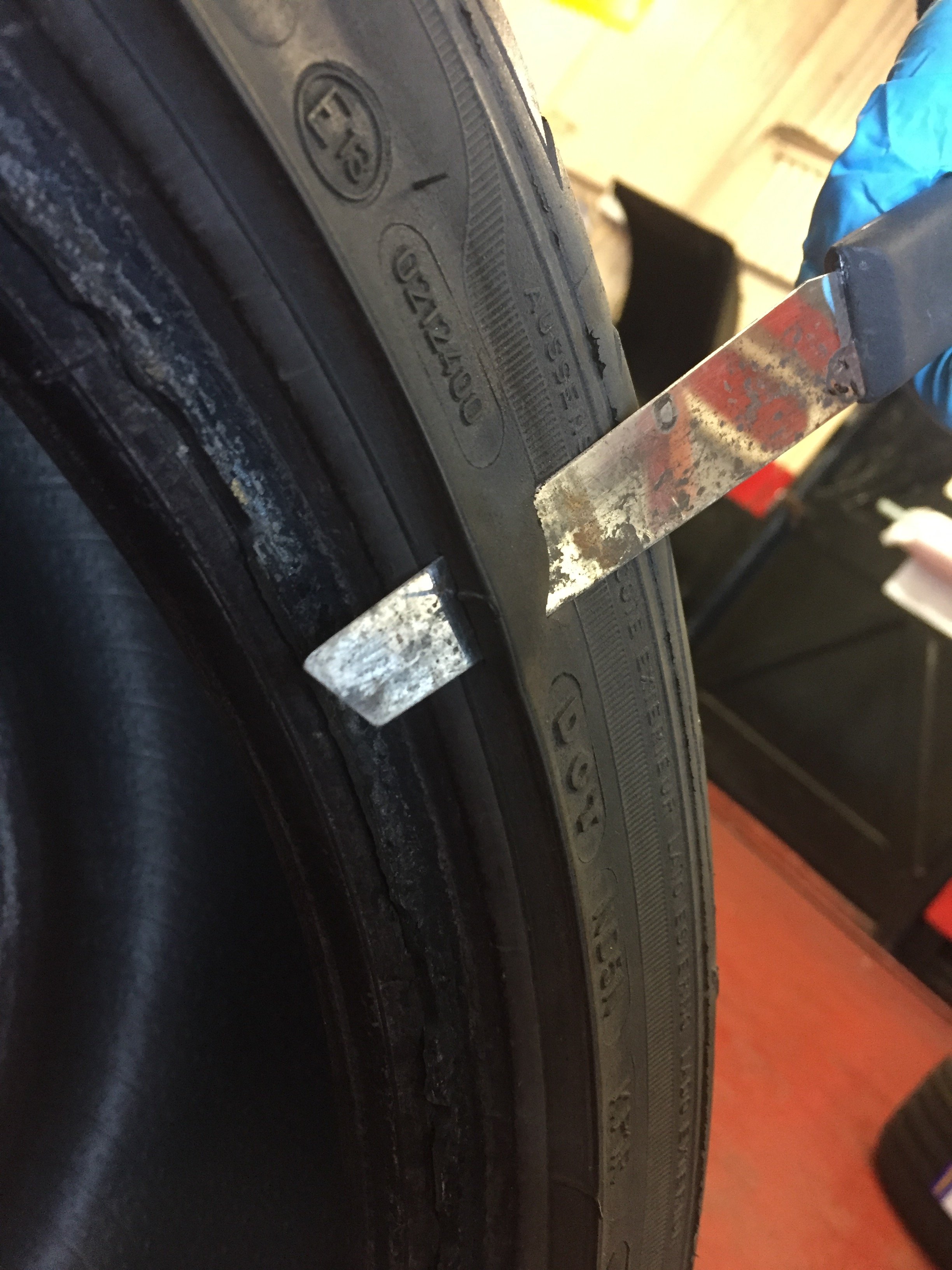

If you prise it open a bit and shine a light in, can you see any white bits like string (cords).  If you can and they are cut then it's U/S.  If they aren't cut and it isn't bulging then i'd risk it (in fact I do - one on my car and one on my daughters).

Took the car to a local STS Tyre Pros and the chap who looked it over seemed fairly certain that it had just gone through the thick part of the tyre that makes up the rim protector and that it was up to me if I wanted to change it for piece of mind.
He did however, point out some large cracks running along the tread (something else i’d noticed whilst looking over the damage I was more concerned about but in all honesty didn’t think too much of) and that both rears are 4 years old (Goodyear Asym 2).
With that and the fact they aren’t too far off the wear limit I thought I may as well get them changed anyway before the weather gets any worse so I have 2 Goodyear Asym 3’s on order!
I’ll be able to get a better idea of the damage and some better photos once they are off.
Edited by CookieMonster87

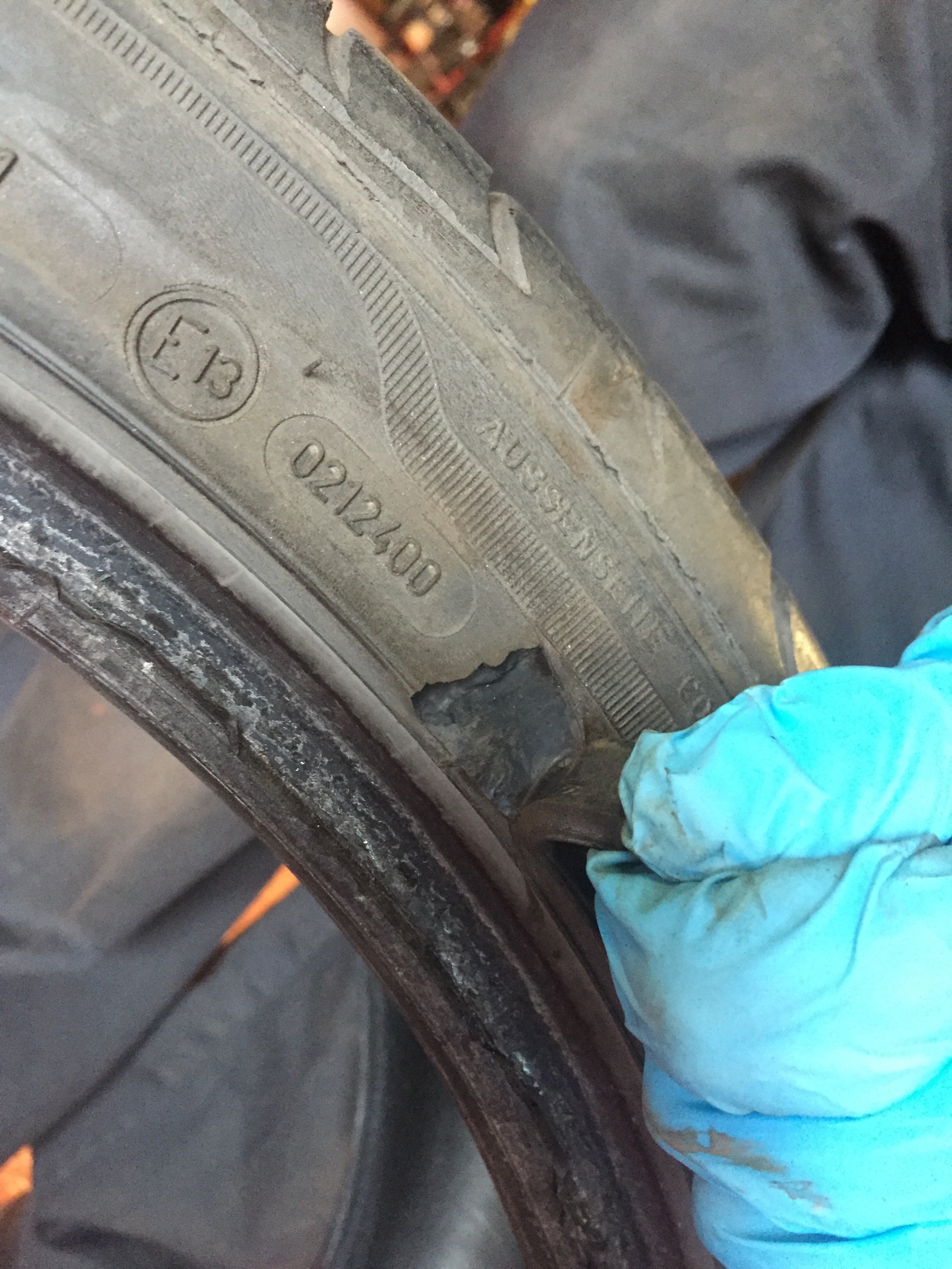

Here is the damage to the tyre now that it’s off. No cords showing although the cut just reaches the thinnest part of the sidewall (about 1/3 out from the rim) after the thickest part that forms the rim protector. The chunk is a few mm thick too.
Jeez - Definitley needed swapping IMO
