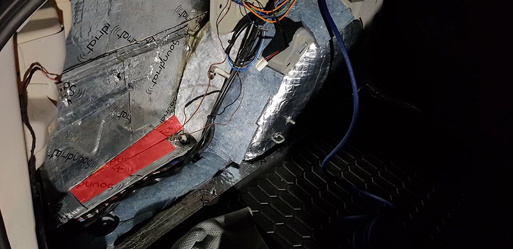

So i was mocking up the location for the Amps and i noticed a puddle of water in the area highlighted below, its waxoiled from factory so i'm guessing its prone to water but i was alarmed as its so close to a lot of the electrics and it was a quarter of an inch of water. Its been raining heavy but i cant work out where it would have came from as everything else is dry,
anyone else noticed water around the wheel arch inside??
Trying to think where the water would come from. If it were condensation, it'd be all over the show.
Rear washer pipe?

Rear washer pipe?
could be but im not sure the direction from the front. everything else around it was bone dry
Well vw group cars have a history of popping the pipes off in that area, so worth a check around.
I had the same leak on my octy 3. Got it fixed last week. Puddle was on the left side rear wheel arch. Just as it is on yours. Rear washer tube comes from front to back on the left side under roof lining and was leaking somewhere back there. My leak left an ugly stain to the lining too.

ill have a look tomorrow when its dry but i hope you are right, very worrying as i have the expensive tow hitch electrics just beside it.
That was where it did it in the mk2 too. If it doesn’t turn out to be that, then goodness knows what it is.
