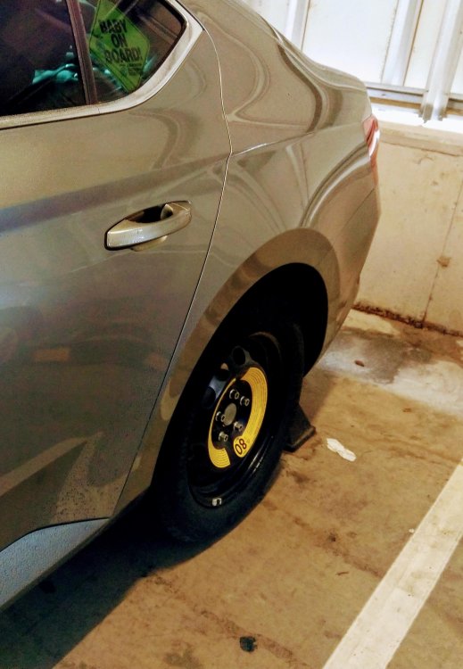

it looks crap.   coincidently, after this discussion, my front tyre developed a puncture yesterday - thanks to the TPMS alerting me :)
so now i have the spare tyre on :(

True that - I didn't realise until today that putting on the spare tyre would disable the ACC.

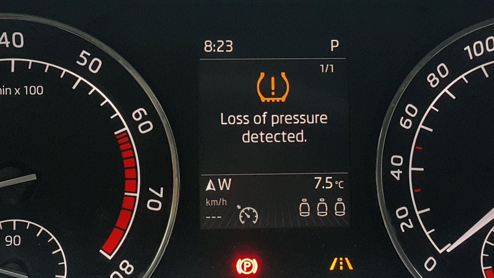

In my experience of indirect TPMS since 2005 its absolutely fine. In those 13 years its alerted me to 2 punctures with no false alarms. In each instance the alarm has come on with an approx 10 psi drop in pressure, plenty of time to swap to a spare (if available) or pump up the tyre to get to a safer spot.
With direct TPMS we had one puncture and we were alerted with a 4 psi drop in pressure. No false alarms.

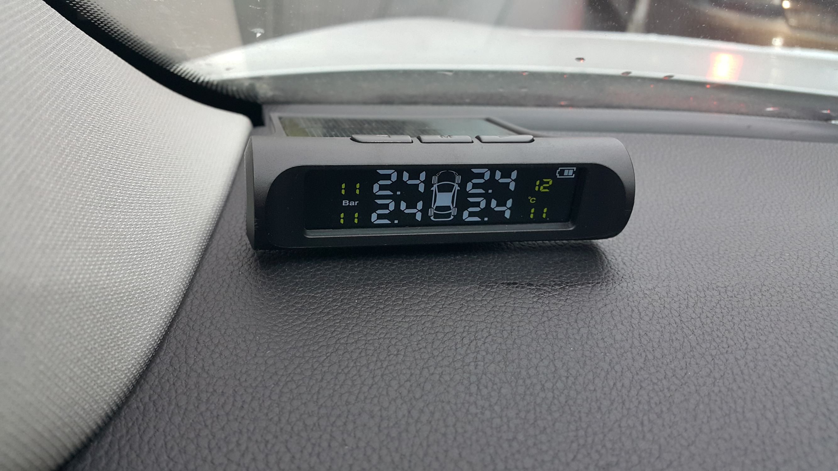

don't say 40 euros is a huge price to able see what exact status is right now
(all 3 photos at same time)

I'm not sure which car that's from, I'm sorry but that is just plain wrong, at least for me.

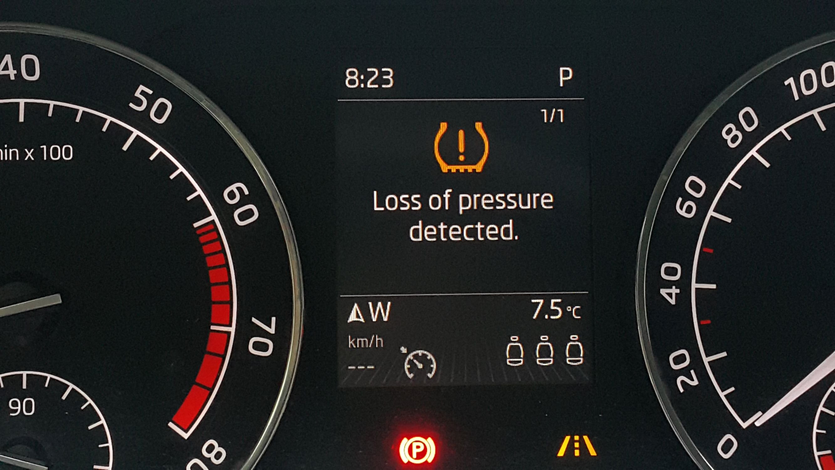

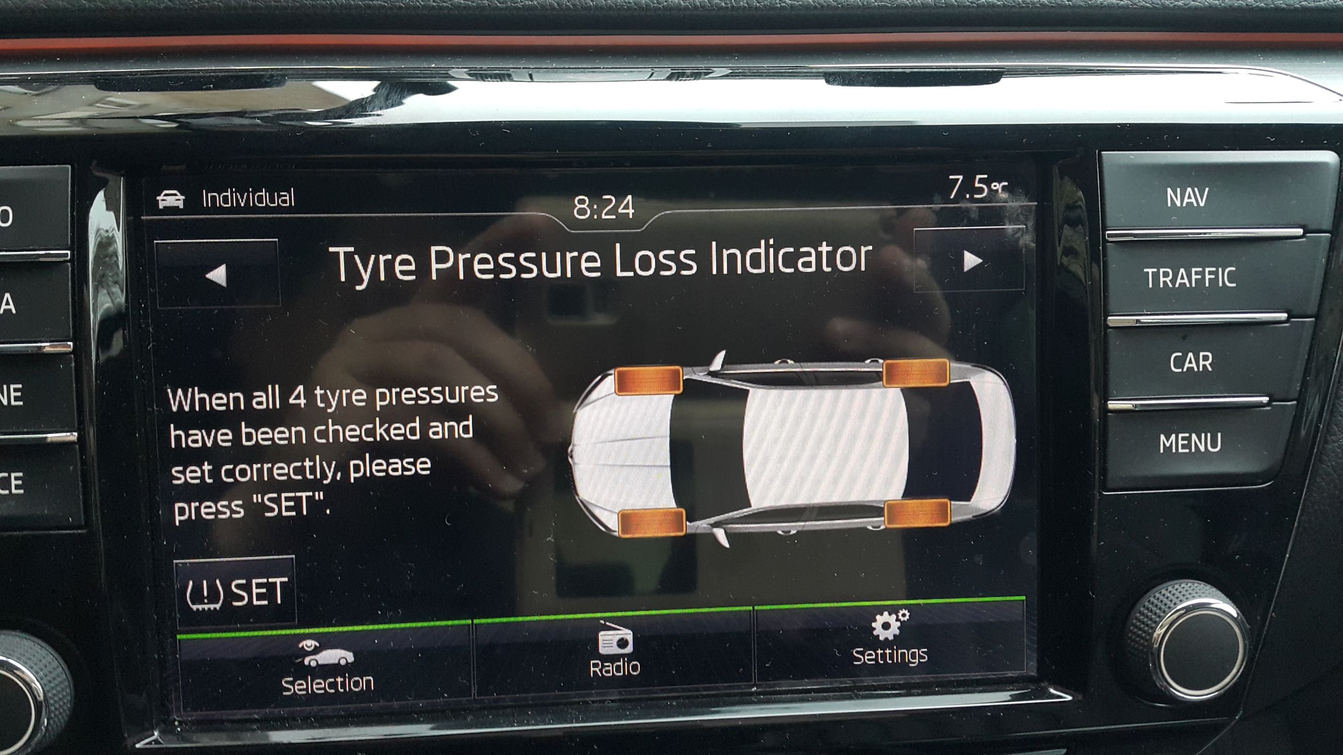

Did u not see the pictures I posted up earlier?? The indirect TPMS on the Superb tells u exactly which wheel is in trouble.
And the 2 out of 2 warnings I've had in the past 16 months have been spot on accurate.
Prior to that, with my MY11 Octavia RS, I've had probably 2 or 3 false warnings in the 6 yrs.
Combined with a tyre gauge, which u should rely on, the indirect TPMS is more than adequate.

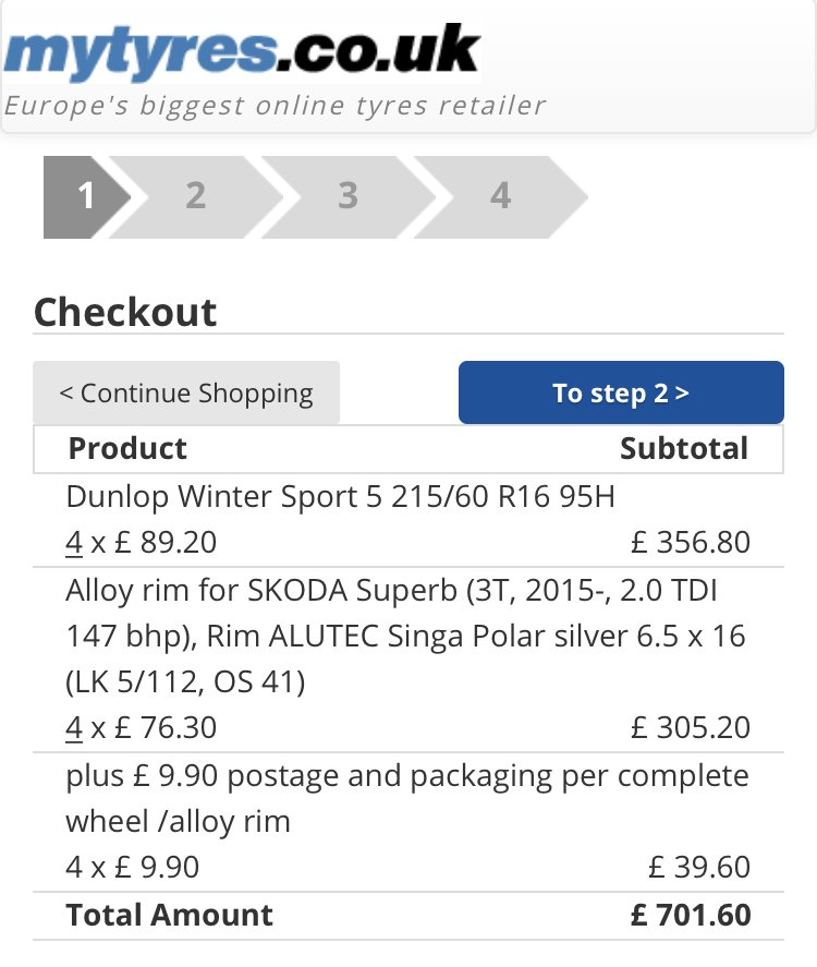

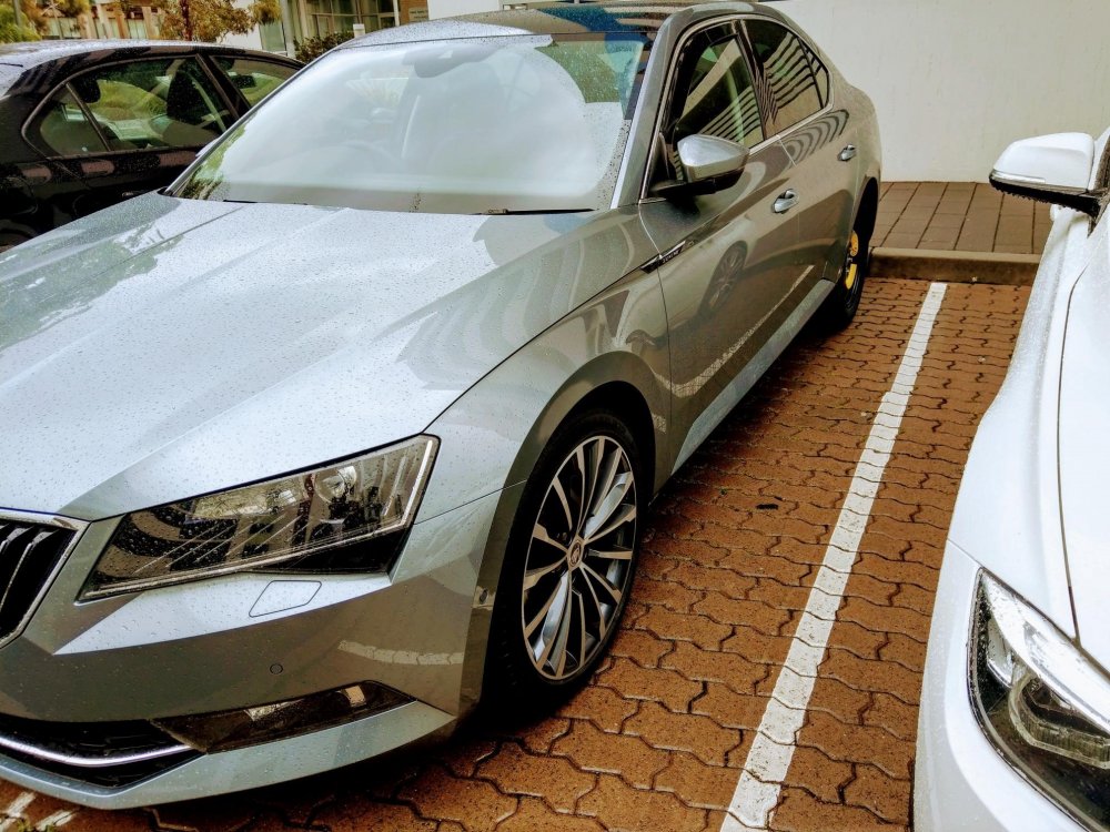

I was planning on buying steel 16” rims for S3 being delivered in January but when I narrowed down to ones of an known manufacturer and included the covers which won’t fly off on the first turn it ended up being very close to aftermarket alloy rims.
I’m attaching the combo (wheels+tyres) I got. As I’m in Croatia, I had to pay significantly more for the same thing than 700 GBP you would get on MyTyres. Good thing about this exact rim model is that it’s supposed to be 100% compatible (no rings or new bolts) with OEM rims. They also carry lastest set of certificates (ECE) so no legal complications are expected.

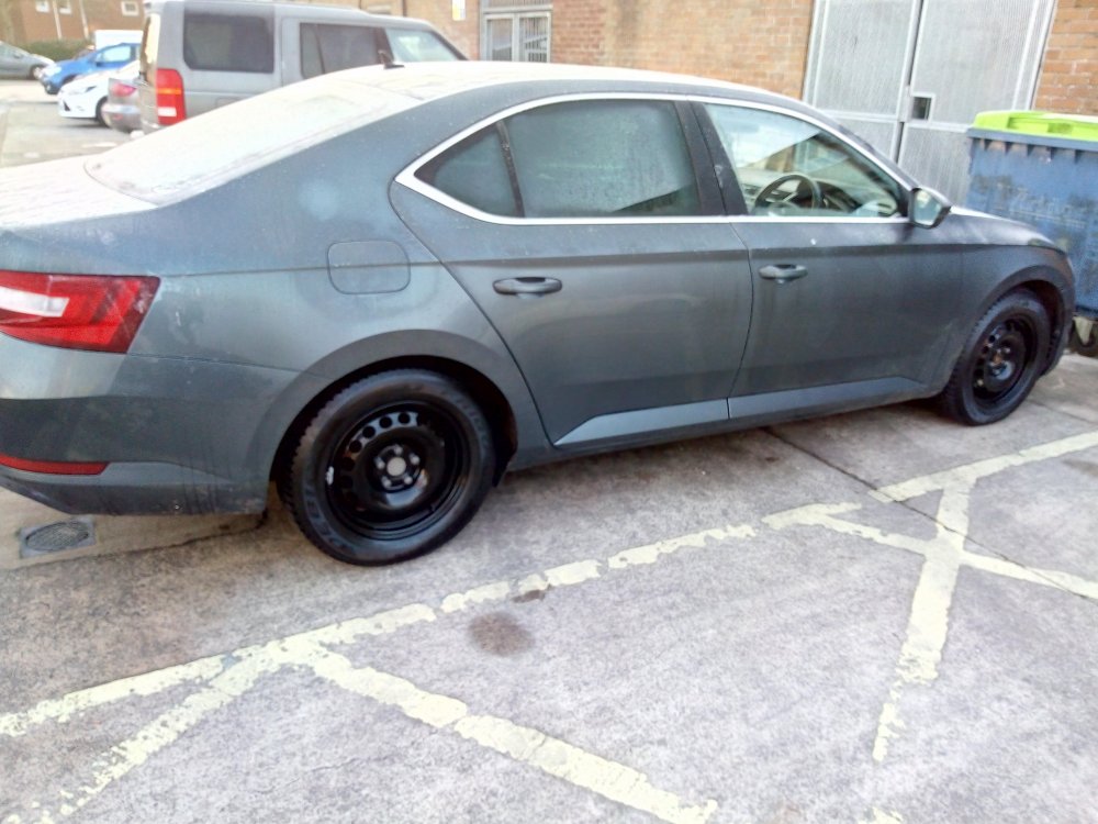

I bought a set of 16" steel wheels from my tyres and they turned up stamped VW with a set of Goodyear UltraGrip Performance Gen-1 tyres separately and got a local tyre fitter to mount them for £10 each.
