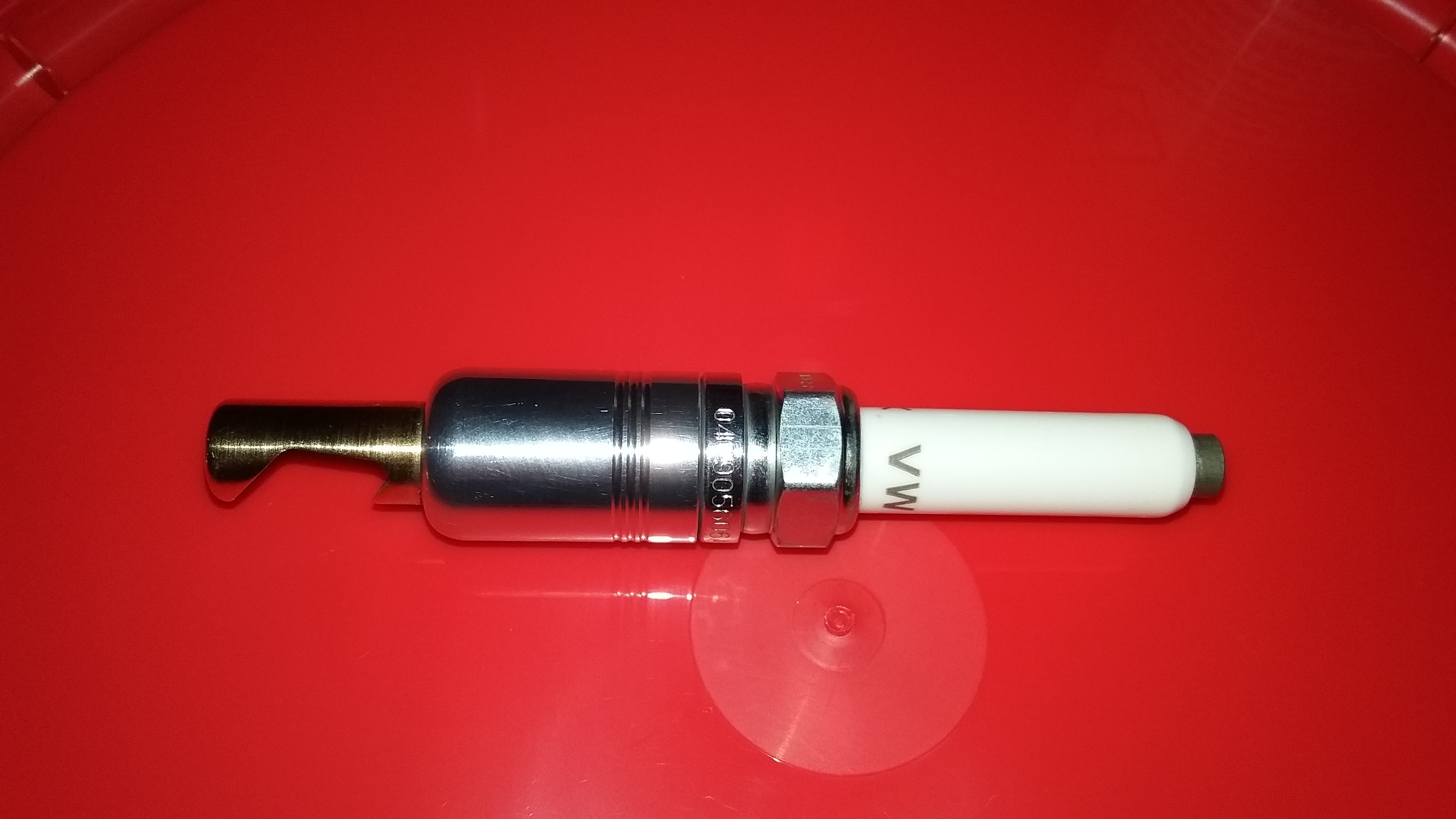

I replaced my spark plugs at 35k miles since July '16, the service manual recommends 40k, but I take your point and with winter upon us...
The old VAG plugs had a gap of 0.051" up from 0.040" factory.
I guess it makes sense to remove, clean and regap at about 20k.
I also converted one of my spark plugs into a bottle opener after 20 minutes on the lathe.
