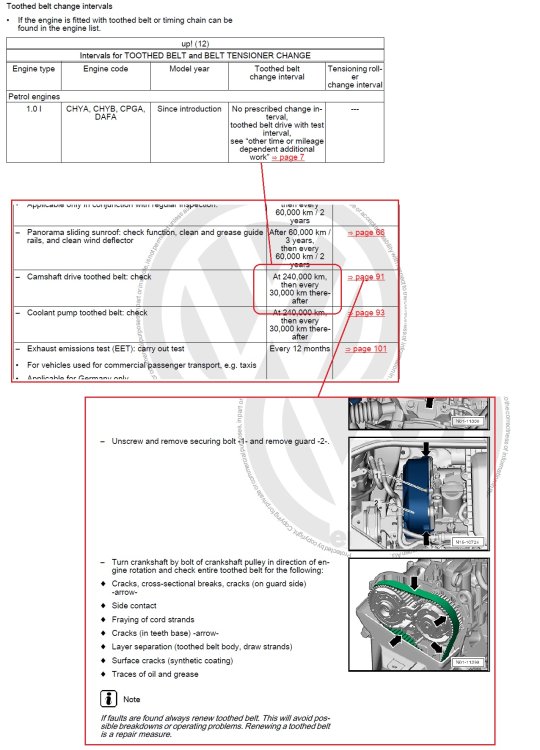

  1. This from VW regarding their CHYA/B Citigo engines. The belt service schedule is to inspect at 240k km (160k miles) and replace if necessary, there is no time limit.
  2. The engine manufacturer of the CHYA & B engines, VW, recommend inspecting the cambelt at 240k km (160k mile) intervals, and to replace if necessary. There is no time limit. All covered in the service manual (below). My 2016 cambelt is on 95k miles and running as smooth as silk.
