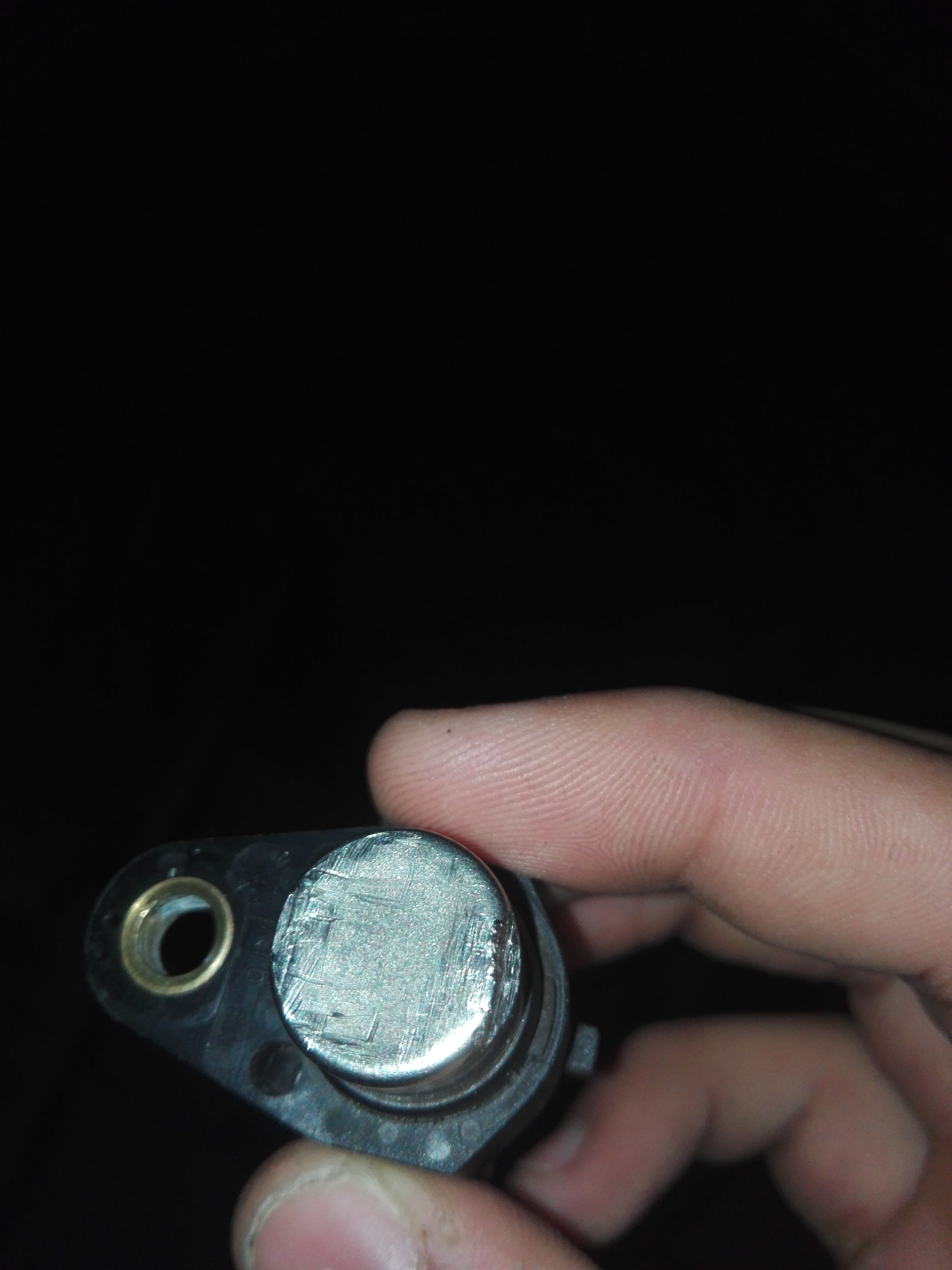

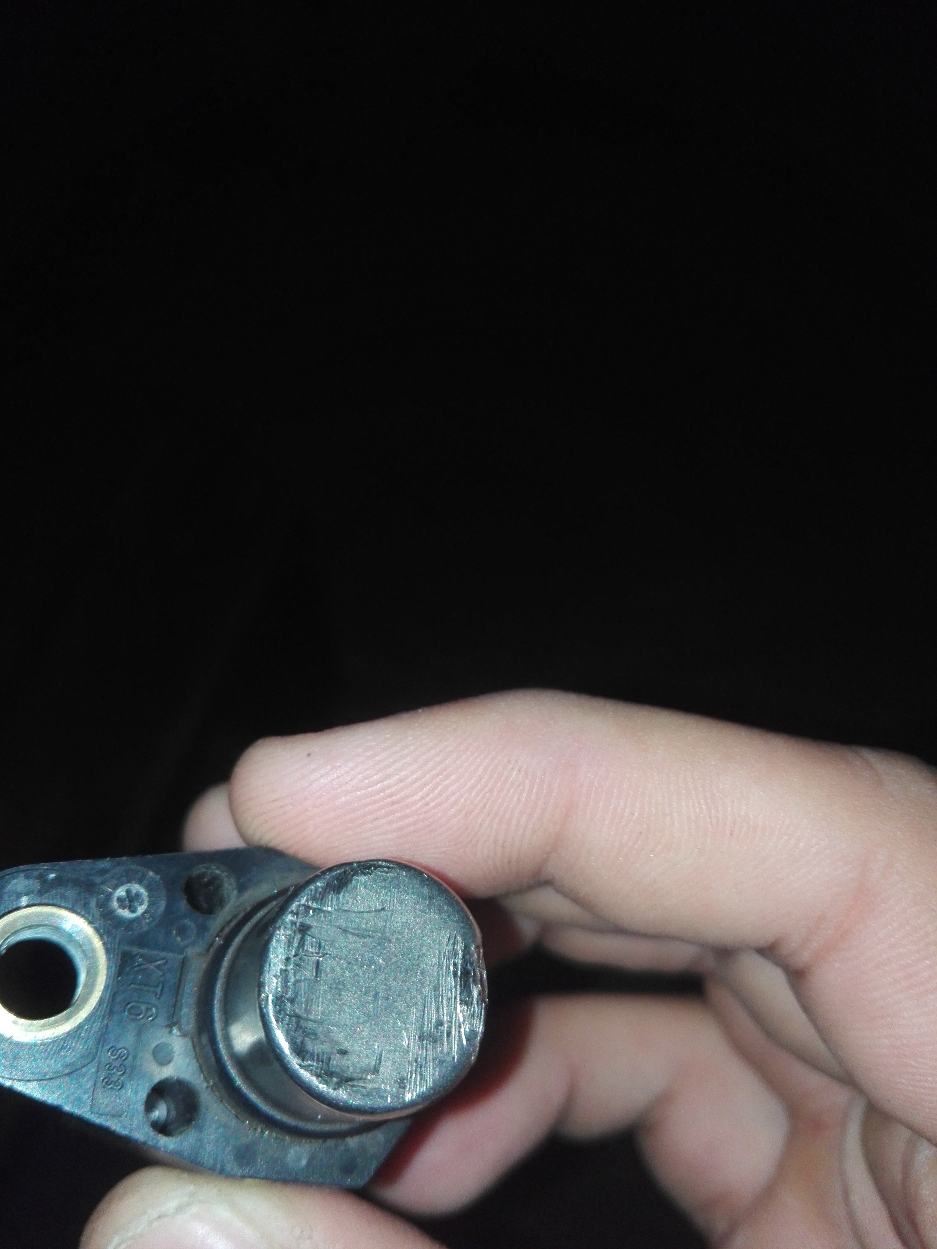

Hello im new here. Wondering if someone can answer this question for me. i have a skoda felicia 1.3 68hp mpi 1997 model last week my car do some cuts when i drive after 1hr driving in the city the engine dosent start again after 5 minutes i start it up and i drive it.. slow my mechanick said that the fuel pump is the problem we changed it... after a 10 minutes of driving the engine failed.  after a lot of minutes the car start agian... I'm back to the mechanic and we see  that the  crank sensor is scratch. i buy a new one and i put it on the engine.. the car start good i test it and its goo very good in the road i clean the map sensor and the throttle after all this the car cut Current but the engine  the engine continues  to work. my lamda is in good condition, i put new coils new  spark plugs nothing  changed

  1. Checked for error codes using OBD1: nothing only crank sensor code i delete  it
  2.  new sparkplugs but the old ones is in good condition
  3. Cleaned throttle body and reset it.
  4. Changed Coils
  5. Changed crank sensor and coolant sensor

The starter with a broken gear might explain the scratches on the crankshaft sensor but that doesn't mean the sensor was bad.
